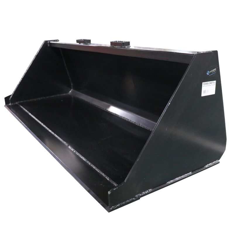

All that said, I am happy about how the tractor worked out in an extreme snow. I wished several times yesterday that I had bought a 50hp Kioti DX but the extra size would be a nuisance for other more typical chores. One thing I am still considering is a 72" snow/mulch bucket that would help in both normal and extreme snows. Anyone have experience with a bigger bucket on a compact tractor?
Thanks...ned.
This is an example: Titan 72" Skid Steer Bucket

In a normal snowfall, I can run the level bucket up and down my gravel drive, pausing once in a while to empty the bucket off to the side. It's not super efficient but it works. This latest snow was so deep and heavy that I had to scoop and dump as though I were moving a pile of road base. That took time and had me wishing for a 72" high capacity bucket instead of the small-ish 66" material bucket the FEL came with.
If the snow were that heavy you would likely fall victim to the most common error made with "high capacity" (read "lightly made") buckets--yielding to the temptation to overload.

I made my own bucket for my GC2610 for moving snow. I went from 48" to 72" and made it about 8" higher. It was taking about an hour to remove 18" to 24" of snow and was hoping to cut that time by 25%. It has cut the time in half. I was lucky with the size as you can feel the tractor working to lift an over full bucket of wet snow. I made it using the same thickness of material as the OEM bucket and just used a piece of 3/8 x 3 for the blade. I sense it's a bit "flimsy" but has been working just fine for more than five years with no repairs needed. I think you could go wider than 72" with your larger tractor, likely to 80" or a bit more. Less windrows is what speeded up my plowing. I was shocked at the cost of having a bucket custom made so made it myself for about $125.00. You may not have the facilities available for that.

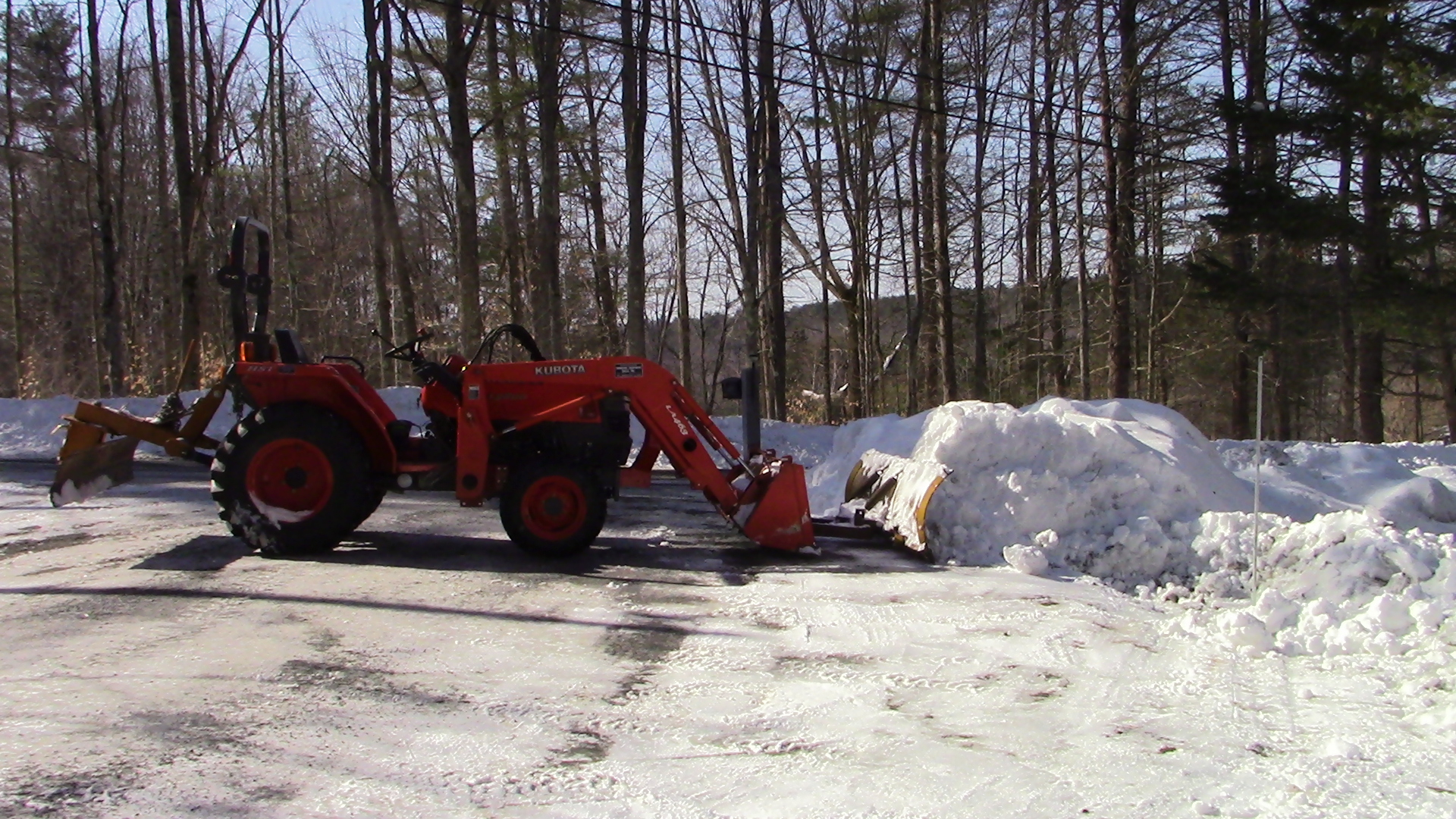

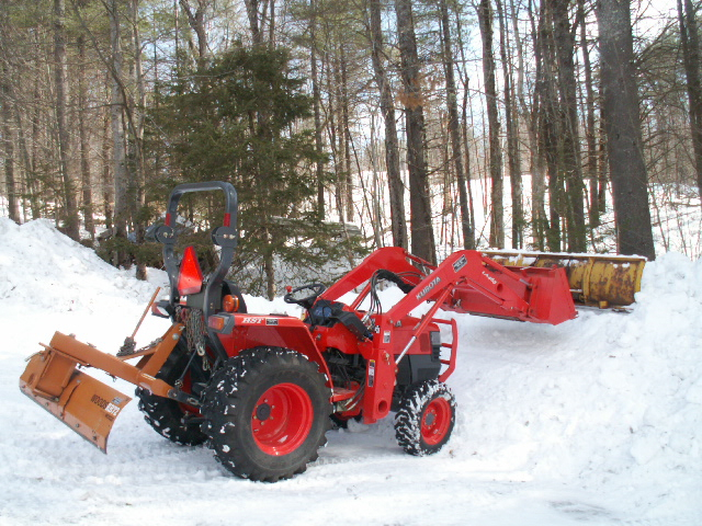

Guessing you waited until 3' storm ended before cleaning?
Indeed bigger bucket will help just have to be tad more careful when rising full loaded bucket on on slope.
This was my last setup last year and it work really well,I could push the snow 7.5 blade and pile it high out of the way,if the bucket was needed pull 2 pins back away from plow.

I agree that a loader bucket is not the most efficient snow implement, but guaranteed to get the job done. I doubt your tractor would notice the difference in a 72" high capacity snow bucket, other than getting done faster.
