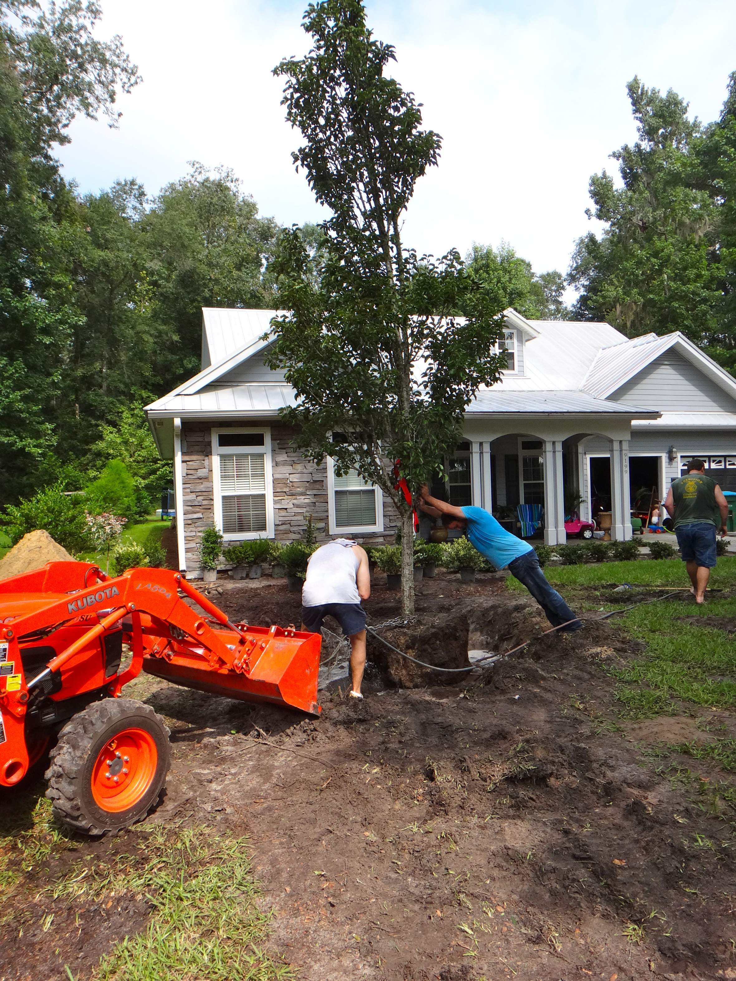

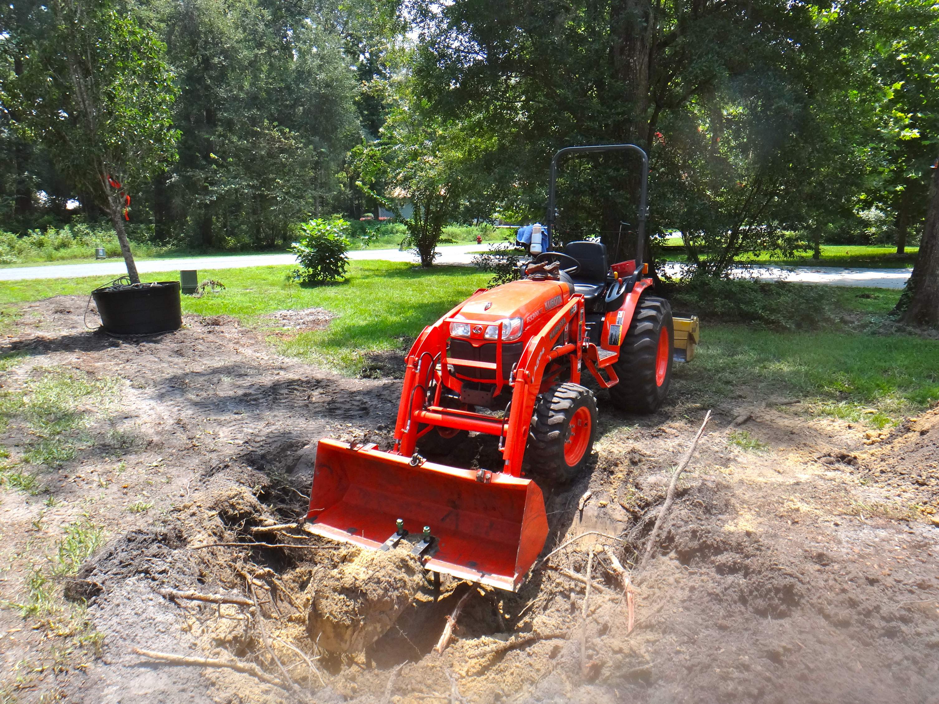

The predecessor to the L3301 was the B3300 SU, a tractor-loader package.
I owned and operated this B3300SU for 400 hours. I sold B3300SU for my current (Grand) L3560. Same horsepower, twice as heavy, wider stance, lots of bells and whistles standard. Much more capable tractor, more efficient to operate, safer to operate, just a smidgeon larger than the L3301. Weight is the key factor.
The optional attachments I would consider:
FEL (Front End Loader) LA805 with SSQA (Skid Steer Quick Attach) L2296 Heavy-Duty, Round-Back Bucket.
R4 Industrial Tires, usually paired with a tractor equipped with an FEL.
Ratchet Rake attachment for the L2296 bucket.
Bucket Spade attachment for the L2296 bucket.
These tasks are within the capability of L3560 with above options:
Ground Leveling / minor
Hauling (rocks, limbs, tree stumps, mulch, dirt, etc.)
Mulch Spreading
Planting Large Shrubs/Trees
Fence Maintenance Pulling out old posts
Driveway Leveling / minor
L3560 is capable for following tasks but implements required:
Field Mowing 6' or 7' PTO powered Rotary Cutter (Bush Hog)
Ground Leveling - Disc Harrow with 18" or 20" diameter pans + FEL bucket adorned with Ratchet Rake.
Driveway Leveling (same)
Till for a garden (same)
Plow or turn over 4 acre field (same)
Chipper/Shredder and/or wood splitter
Auger
Equipment other than L3560 needed for the following:
Push/Pull Stumps >3" = Tracked Excavator
Creek edge trimming = Tracked Excavator
Creek widening = Tracked Excavator
Moving rocks > 2,000 pounds = Tracked Excavator
Hay/Baling
