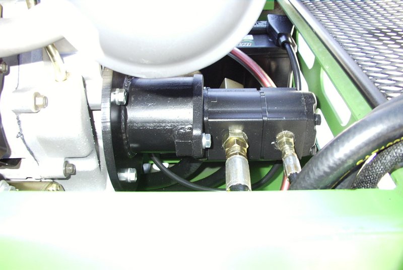

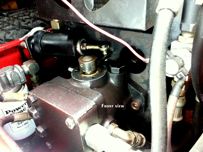

I've got a 2001 model PT425 with the Kohler and my pumps are like yours. The tram pump is in front of the engine and the PTO/Steering-FEL pump is behind the engine. From my pictures...
This is the rear PTO/Steering-FEL pump on the back.
446391d1446774495-thoughts-pt-422-changing-out-pt425ptopump-jpg
This is the tram pump on the front.
446392d1446774530-thoughts-pt-422-changing-out-pt425varvolpump-jpg
Looking at the front, it appears they cut the cooling fan shroud on the Kohler and fabricated a mounting bracket for the tram pump. Can't see how its fastened to the engine.
On the rear pump, there's a mount that adapts the Kohler bolt holes to what appears to be a standard 2-bolt pump mount.
I'd imagine your's is pretty much the same way. What you'd probably have to do is make new mounting holes in the existing mounts to match the Kohler rather than the current engine. You'd also have to to shaft diameter and length measurements. But I'd guess that the hoses will have enough slack as long as you don't try to relocate pumps on either end of the engine too far. But that's all just a guess, of course.

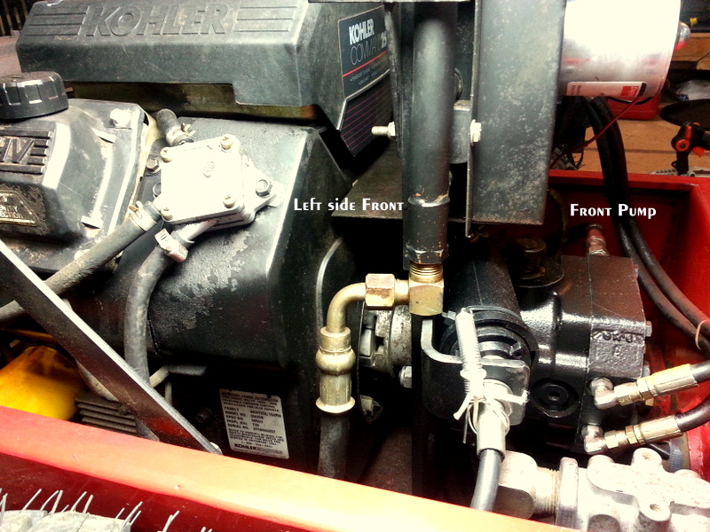

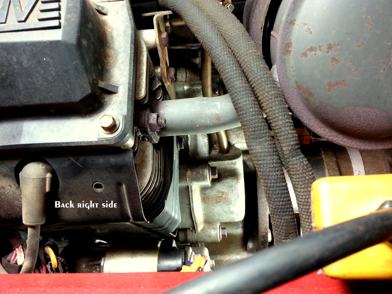

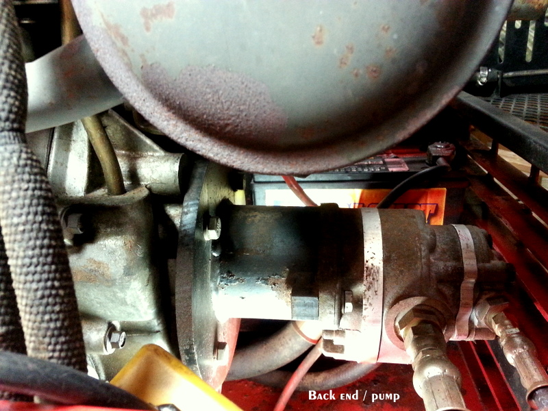

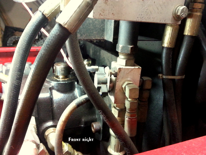

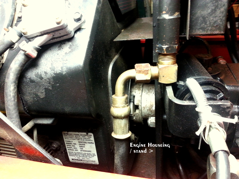

A few shots of my older 96 1425 setup if it helps any .. Very similar with a few exceptions..

Thanks Barry and MossRoad. I am definitely going to do this and these pictures will help. I am going to order the engine next week. Hopefully have it completed before winter weather hits.
