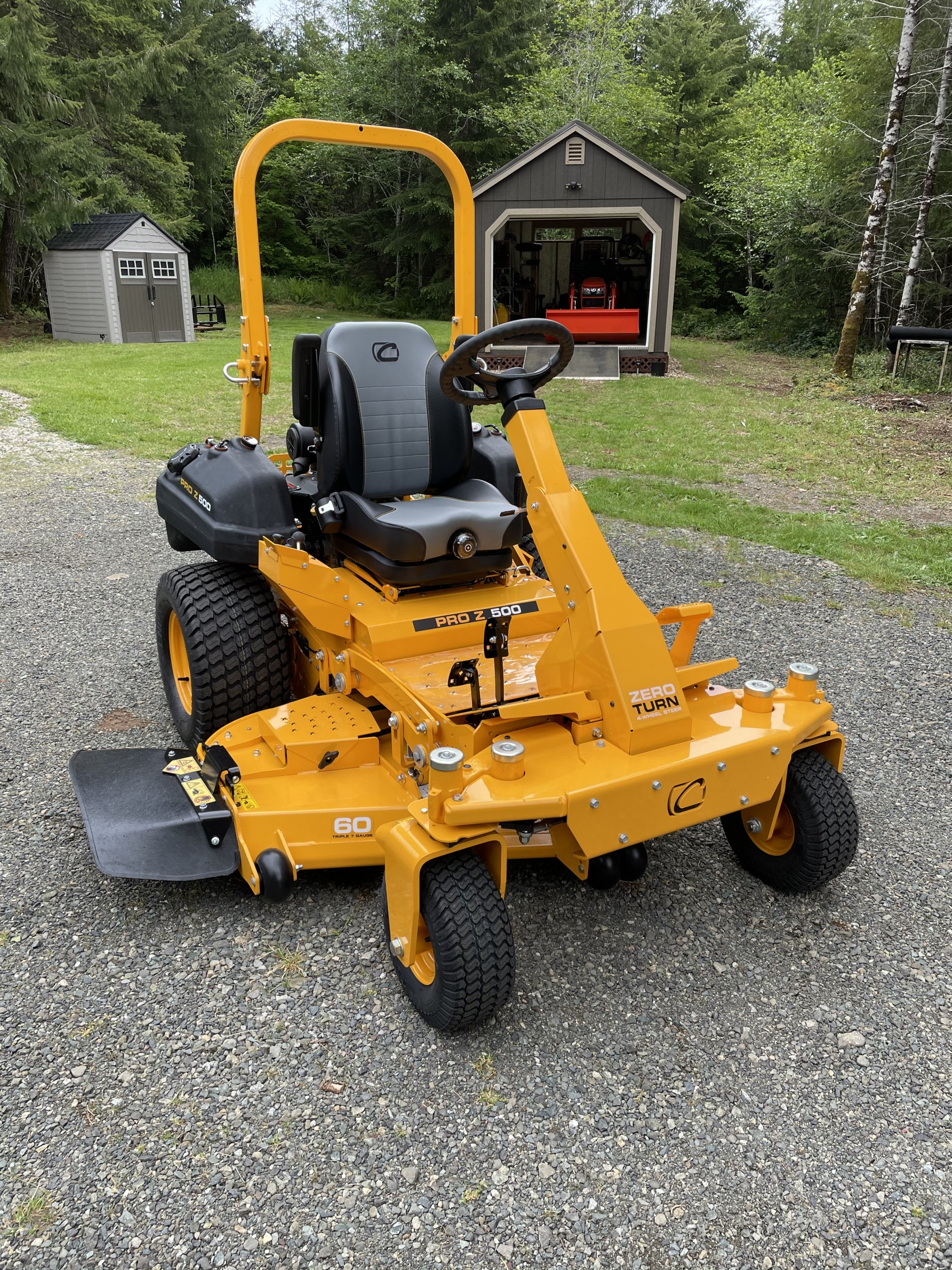

Don't want to start a war here, but when I hear "slopes" and "zero-turn", I think about the steering wheel equipped ZT mowers like Cub Cadet makes. If you've never tried one on slopes, you should take a look. On the standard lap-bar ZT, the front wheels are just big casters and on a slope they're constantly trying to drift downhill. You have to apply constant input on the rear wheels to keep pushing those front wheels back straight.
On the steering wheel ZT, you actually STEER those front wheels with a positive linkage steering wheel so they run straight and true in the direction you want to go. At the same time, your steering inputs drive separate rear wheel drive pumps just like any other ZT. It makes it almost impossible to do burn-out turns or spins because it feathers the input from side-to-side. You separately control overall speed with a foot pedal.
In my opinion, these steering wheel models really shine on slopes and hills because the front tires are guiding the mower instead of being forced back in line by the rear wheels.
