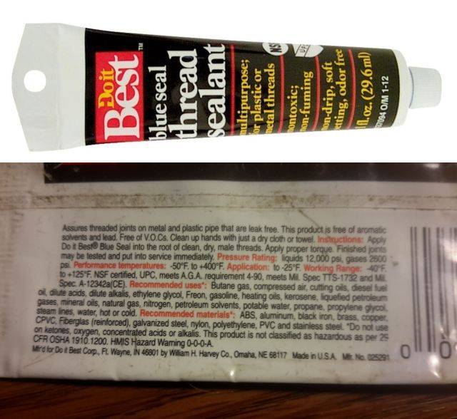

On tapered threads (NPT) PTFE tape or "dope"...
On straight threads, no tape or dope...
I hate tape and it hates me.... Never had great success with it....
My go to....
