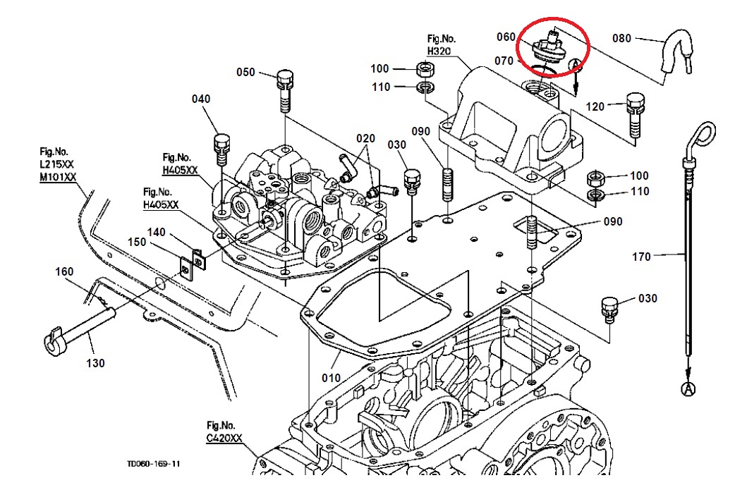

Hello all
Is anyone familiar with the thread used on the transmission oil inlet of the Kubota L4330?

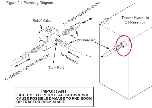

I have a Bush Hog post hole digger model # 2102, with the optional down force kit.
I am trying to plumb the downforce hydraulics to a Kubota L4330 Grand L tractor, but there is no available auxilliary inlet port as shown in the bushhog diagram, so i need to plumb into the existing oil fill.
The stock plug is plastic. I would prefer to use metal for the adapter.
i am unable to identify the threads of the fill port. i spent a few hours researching thread standards, and uncovered more than i ever wanted to know about the subject.
For example- twenty-three different exterior features of the thread ridge- per the Japanese Industrial Thread Specifications
The major diameter of the external thread (fill plug threads O.D.) is 1.272", which converts to 32.3088 mm. The thread count appears very close to 11 TPI (i only have an SAE pitch guage), which converts to 2.3091 mm. The thread is not tapered.

I have found a solution to my problem, Inland Kubota in Yucaipa, CA located a specialized adapter just for this issue. I believe it was manufactured by Gearmore, the part number on my invoice is 10761-KC. I don't know if this part number is Inland Kubota's or the manufacturer.
It is an adapter that threads into the fill hole for the transaxle, has a port for your relief line, and allows you to use your stock plug with the vent hole. All with the oddball thread that I was never able to identify.
Inland said that this fits the early Grand L tractors, and fits up to at least my L4330.
Thanks to anyone that spent time trying to find me a solution, and I hope this helps someone else out.

Well, Michael, seems like you didn't get any other responses but took the initiative in solving your problem anyhow, so good for you! You have come up with a solution I have never seen before in using the HST filler port as a return for the fluid. The Kubota hydraulics are the open-center type and there is a return port used by the loader hydraulics, etc., underneath the floorpan on the right side. Typically that port is plumbed into when adding more hydraulics. There are several threads in the Hydraulics section that cover this. But maybe your approach does the same thing.
