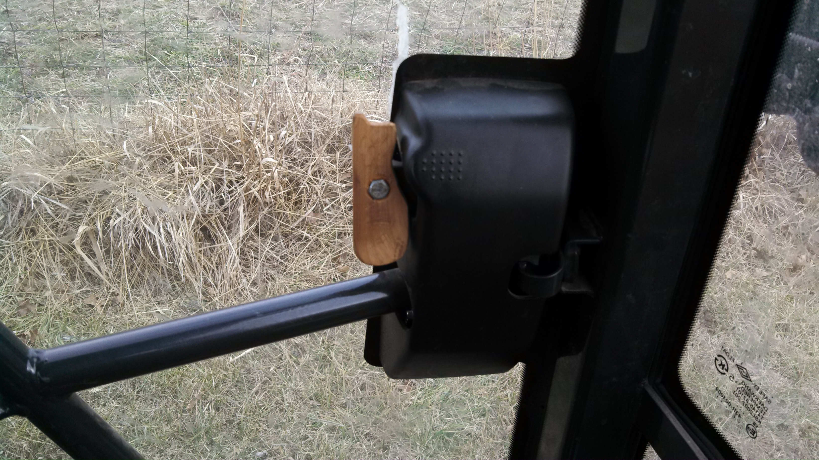

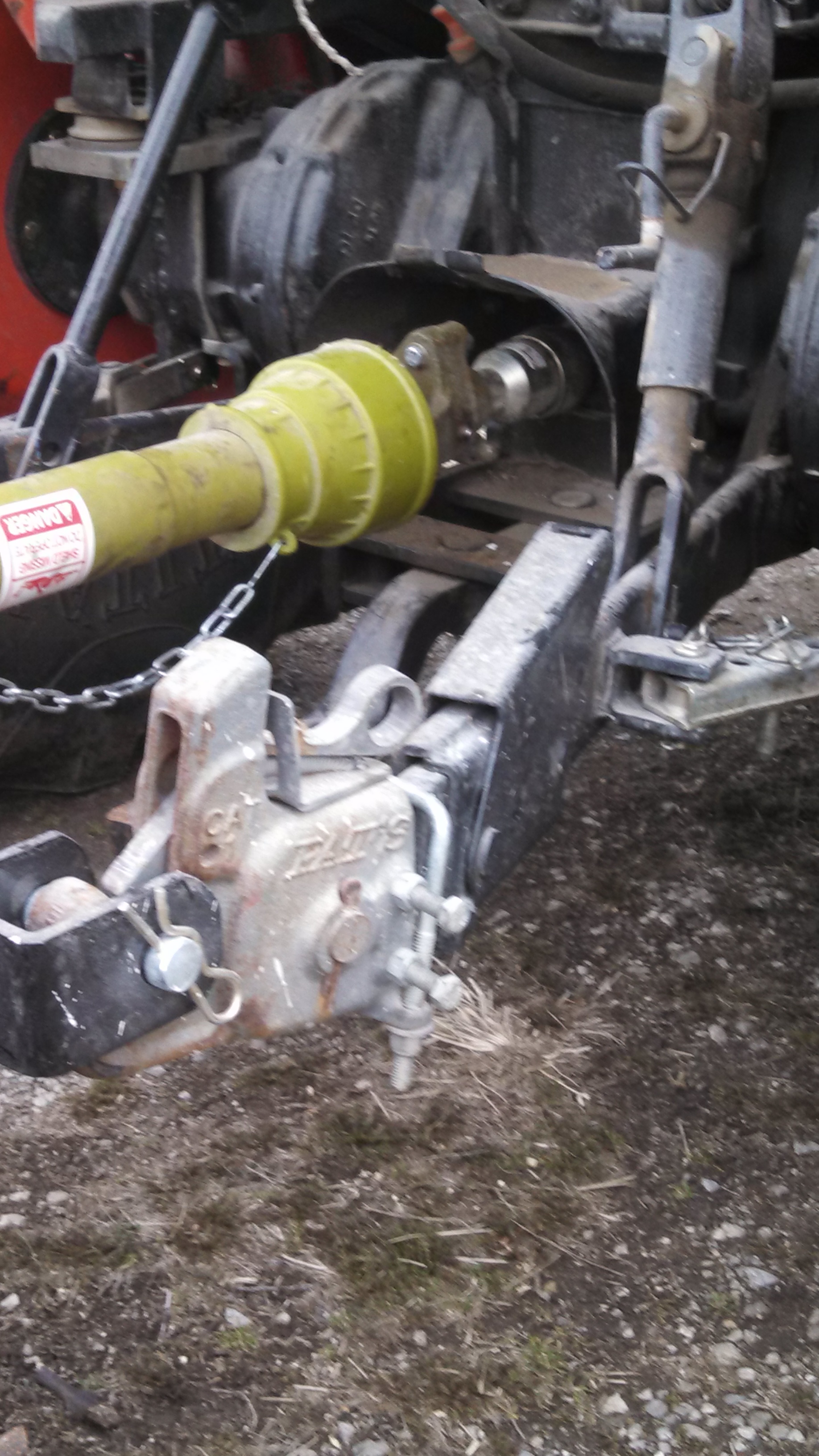

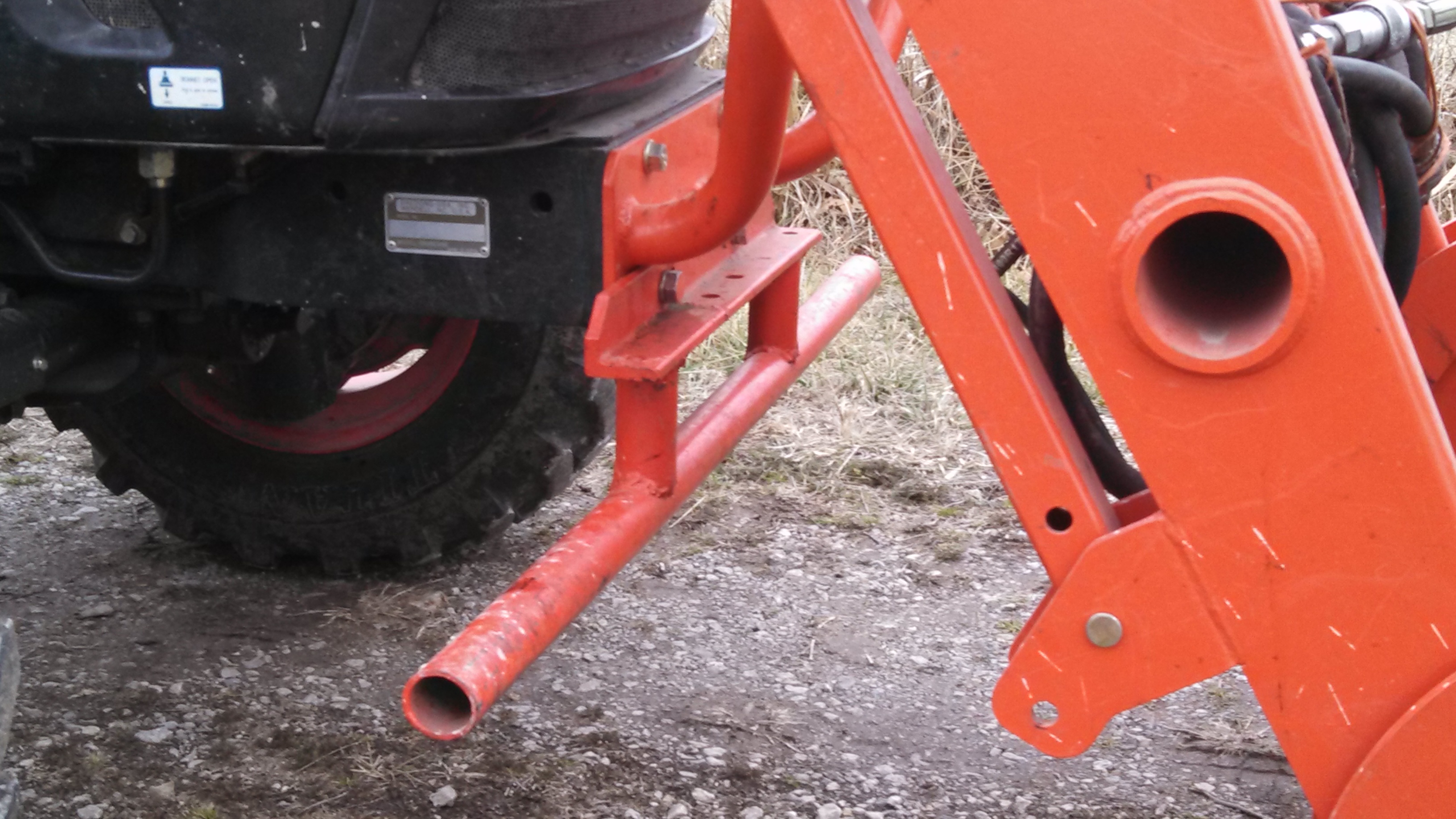

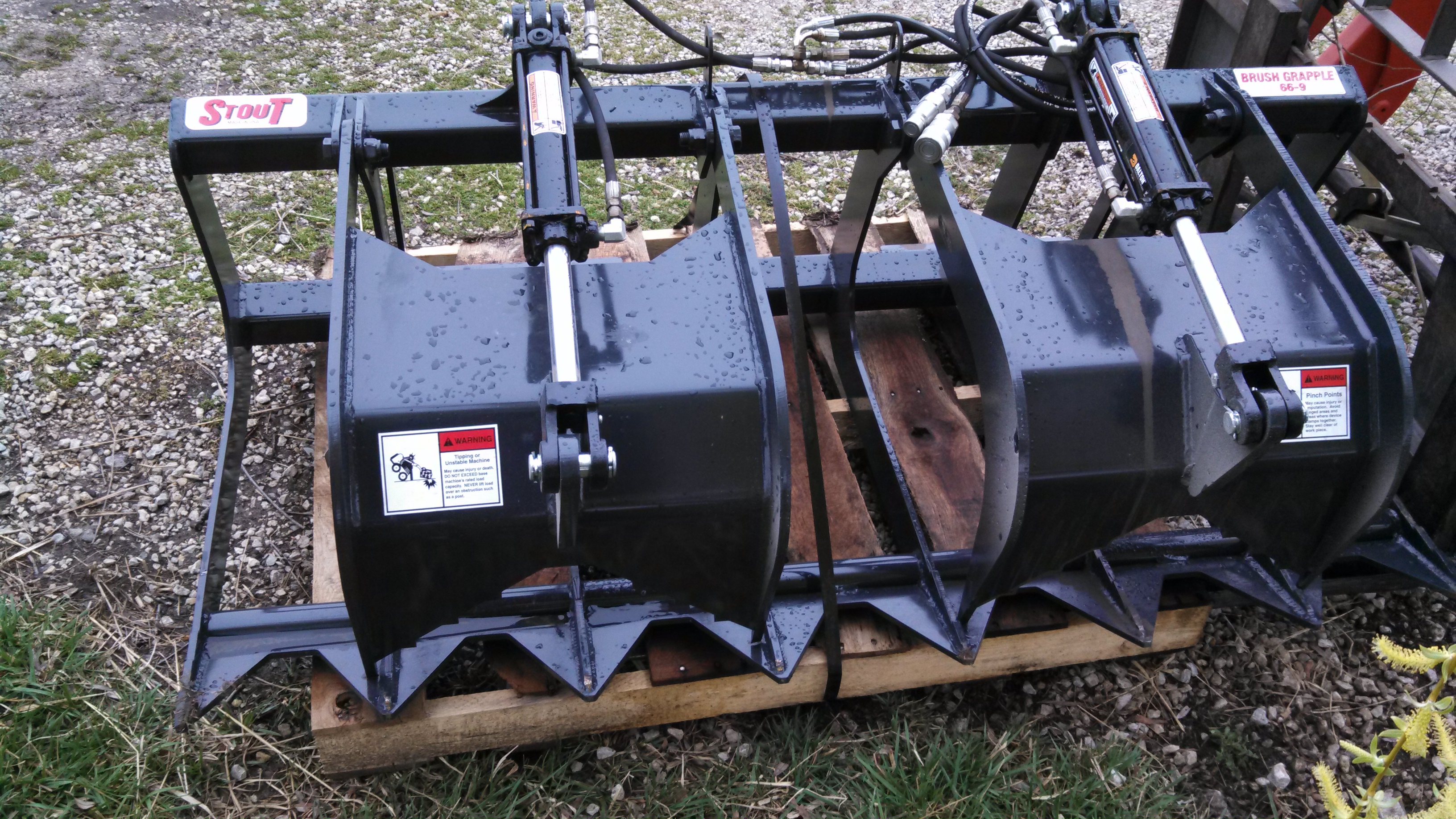

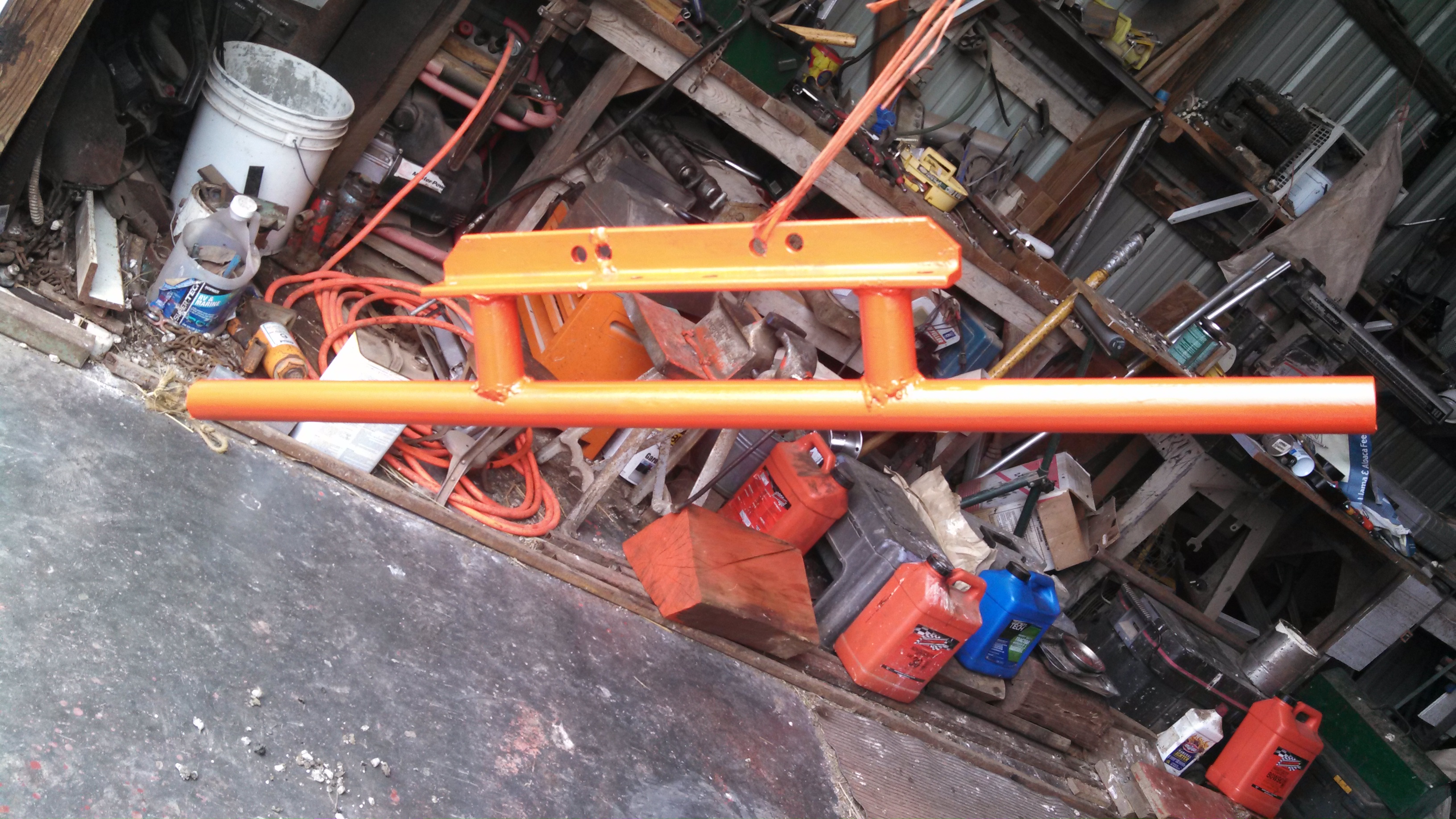

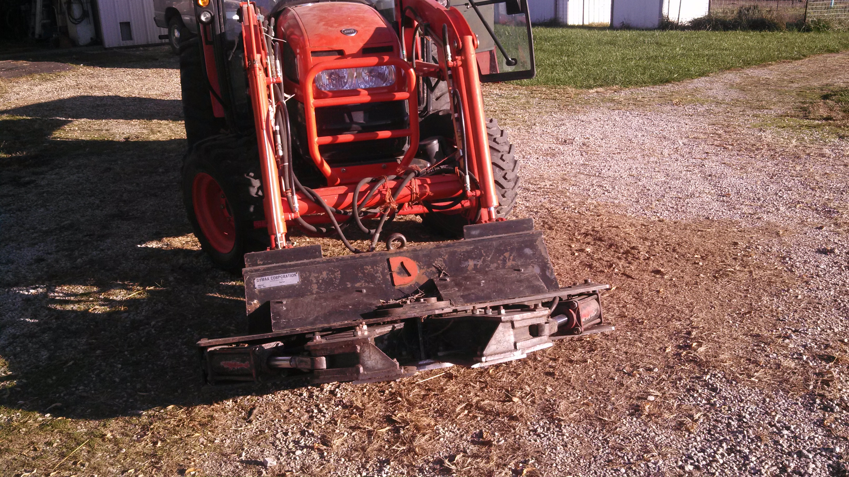

The jobs that I have used my DK45SECab for follows: FEL, Bucket work w/three weld chain hooks on an angle iron reinforcing and piraha blade, pallet forks, big bale spike, tree shear, 66" grapple; 3PT, 6' box blade, 6' tiller, 7' blade, big bale spike, pallet forks, 200 gal sprayer, WH-8H wood chipper, 6' finish mower; PTO implements, 7' brush mower, NH 269 baler; drawbar, hay rake. Because of the Cab:) and HST the tree shear and grapple are the most rewarding and enjoyable tasks and I can comfortably do in the winter. The tractor has been in the shop once for loose A/C belt, my excuse to have the dealer add beet juice and the second rear remote. The next oil change will be at 600 hrs since I am using a 150/300/600 hr oil/filter schedule since the hour meter on the SE is clock time instead of tach time. I have added five items to the tractor: a bar in front of the front axle, 3/4" plywood board under the center of the tractor, a little piece of wood to one of the inside door latches that makes it much easier to open, pat's 3PT quick connects and a PTO extension.

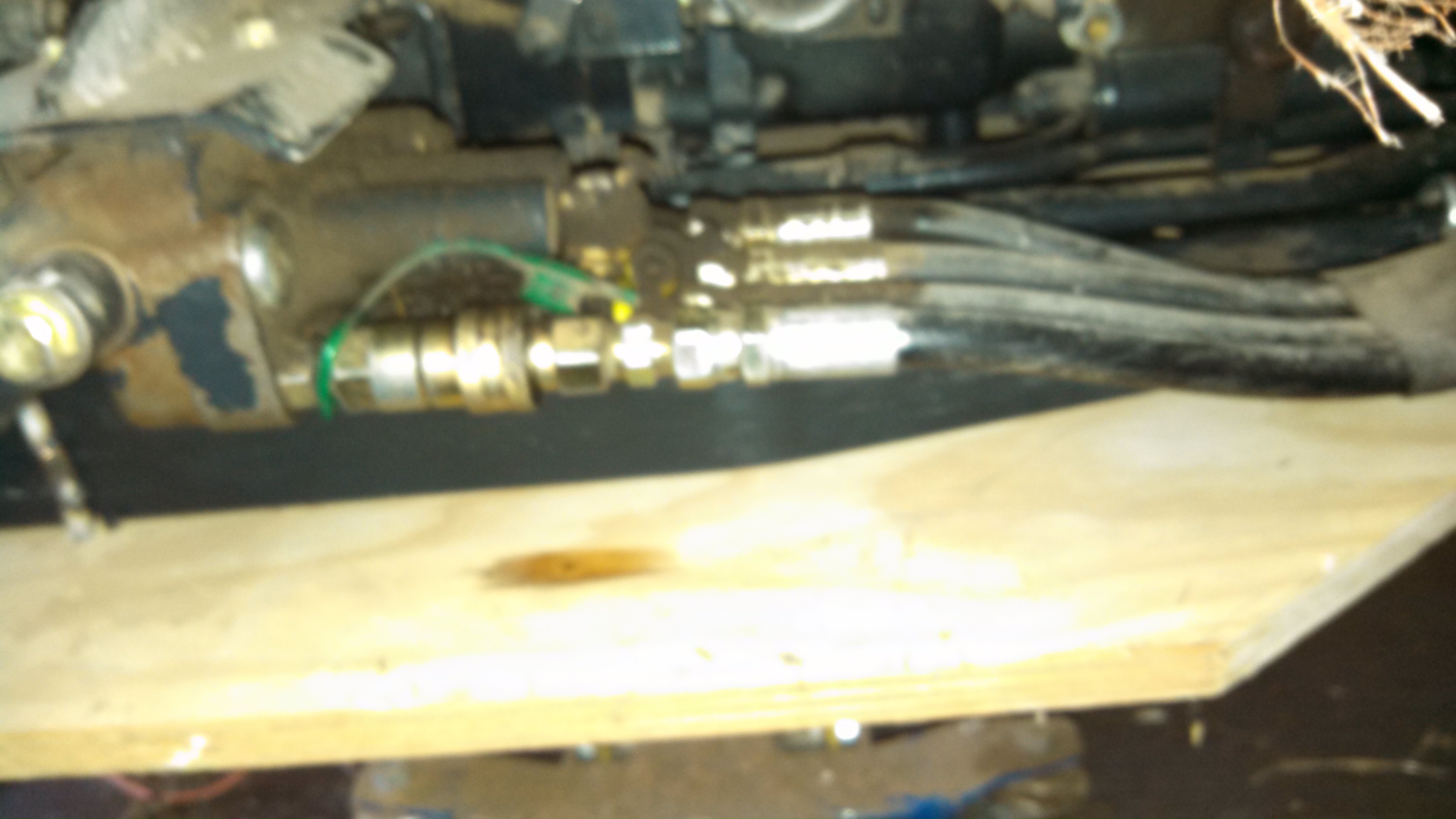

Is the plywood under the center to prevent damage from brush? Any pics?
   / Three and a half years and 500hrs
Yes under the center of the tractor installed with four j bolts. IMG_20160319_164946_522.jpg
IMG_20160319_165017_776.jpg This picture may show the wood brush belly guard better.

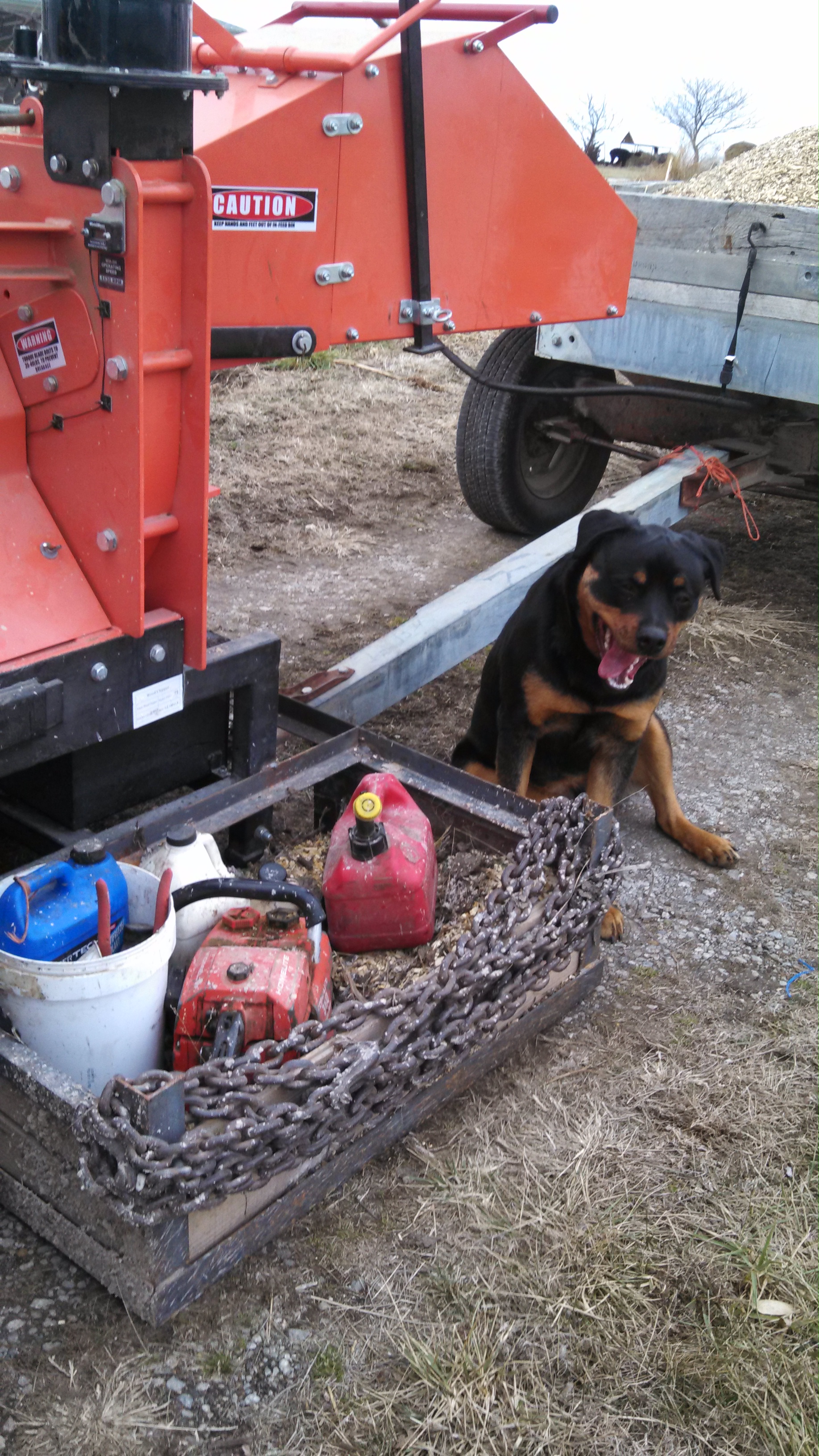

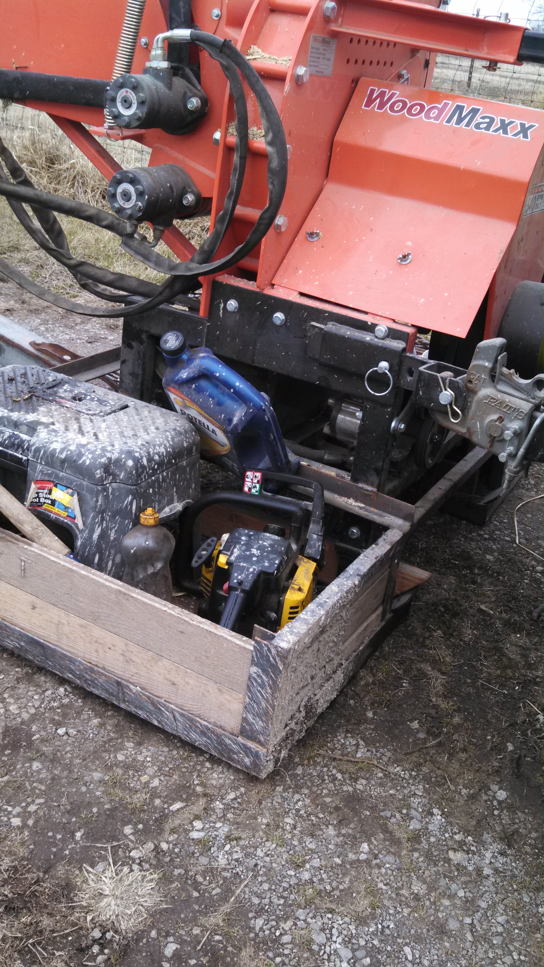

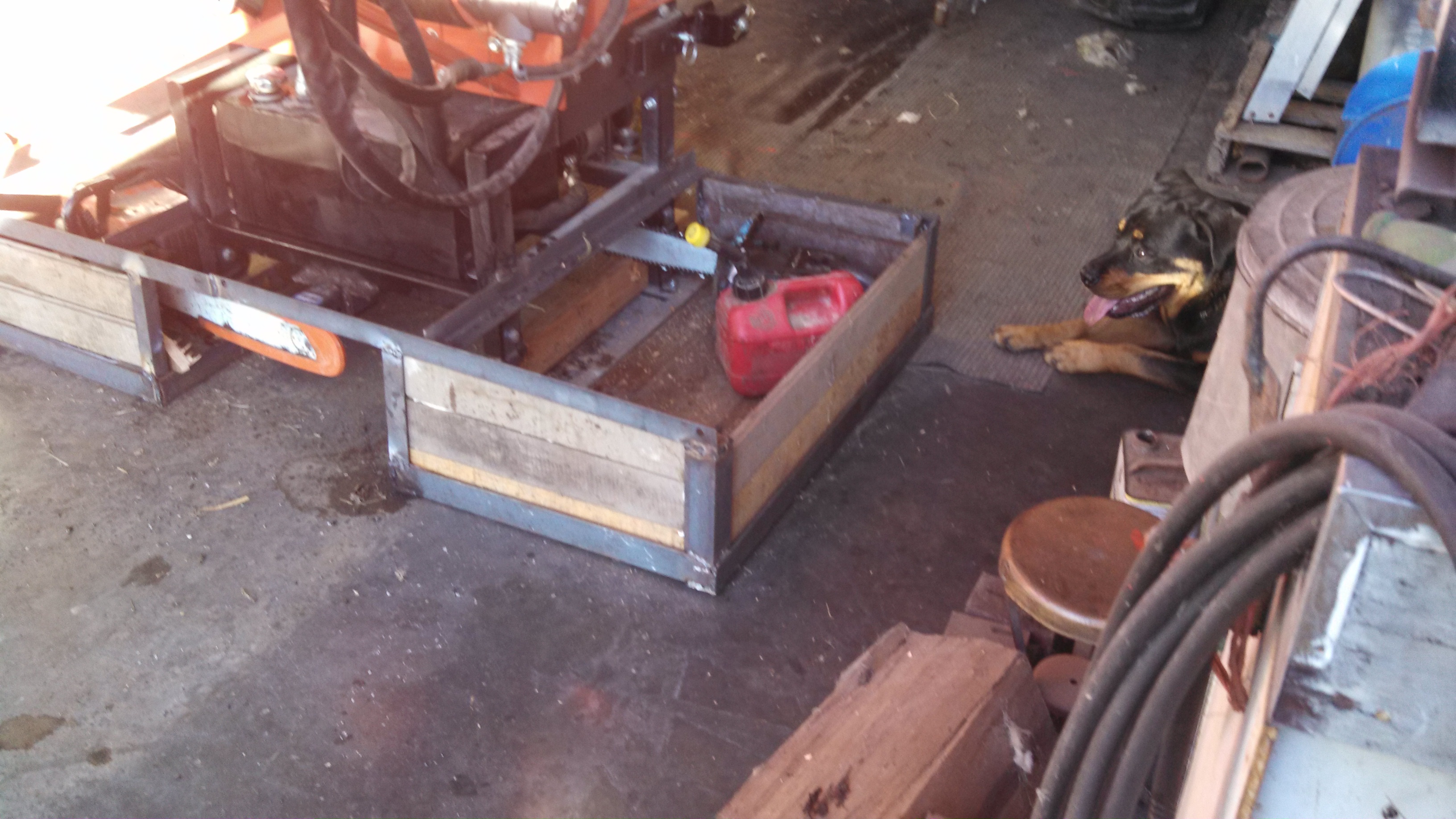

Like your carry all, did you do a build thread or could you post some more pics of that?

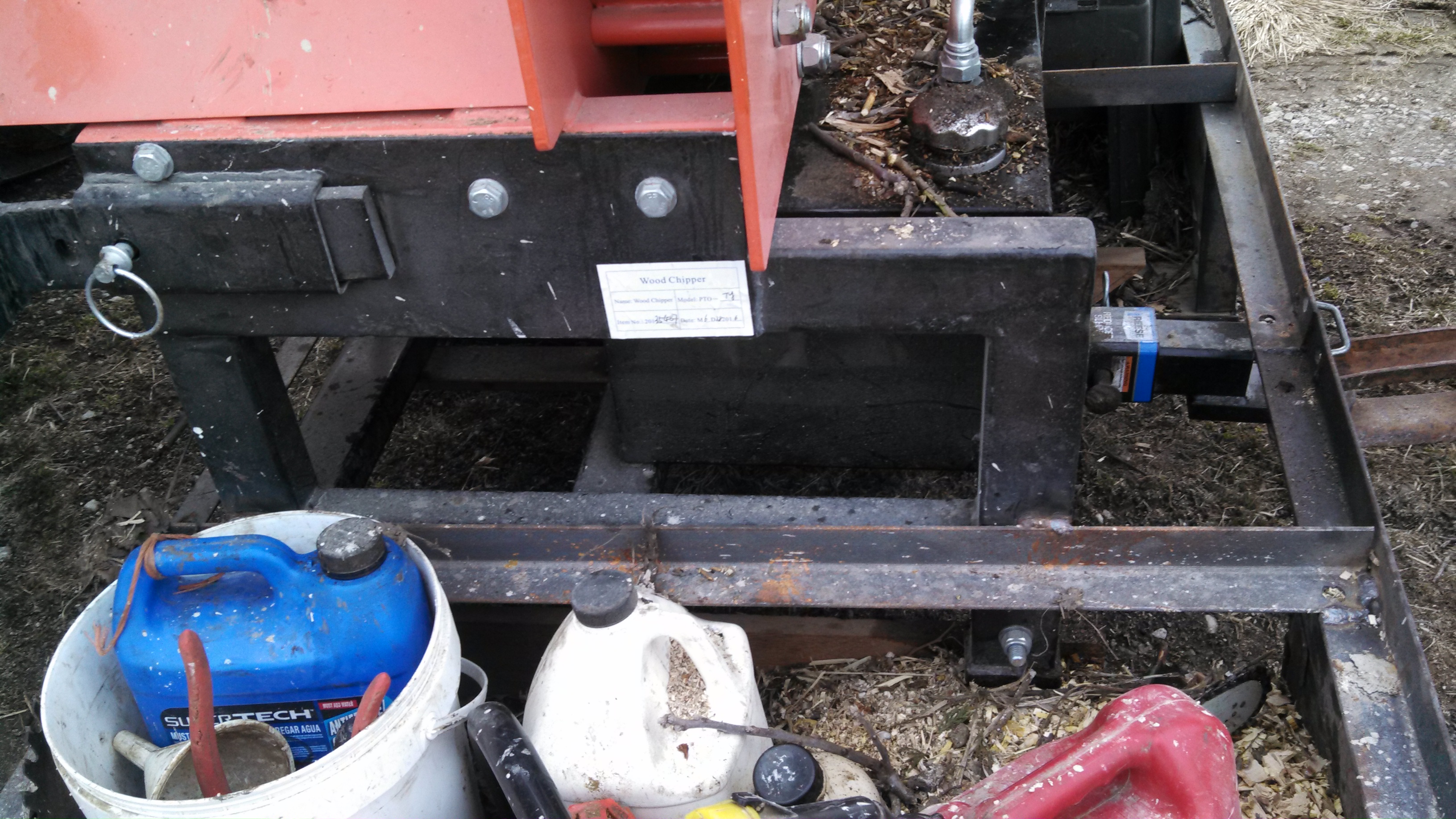

My understanding the DK series pre SE version had TACT total times and with the SE they are clock total time and the maintenance time didn't change. Also part of my decision to extend the oil change intervals is based on my New Holland with 300hr intervals between engine oil changes. On the carry all which is in the picture with the Woodmax chipper all I did was to cut up the angle iron pallet that the chipper came shipped in and weld up some trays on either side of the chipper to hold chains saw etc. I will try to take more pictures and add some later.

IMG_20170125_145323_554.jpgI will try to add some more pictures of the tractor add on and the carry boxes on the chipper. IMG_20170125_145459_608.jpgIMG_20170125_145444_291.jpgIMG_20170125_145406_339.jpgIMG_20170125_145154_588.jpgIMG_20170125_145346_425.jpg
