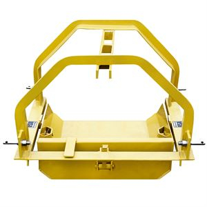

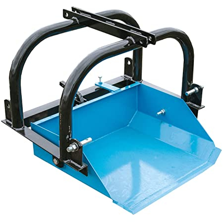

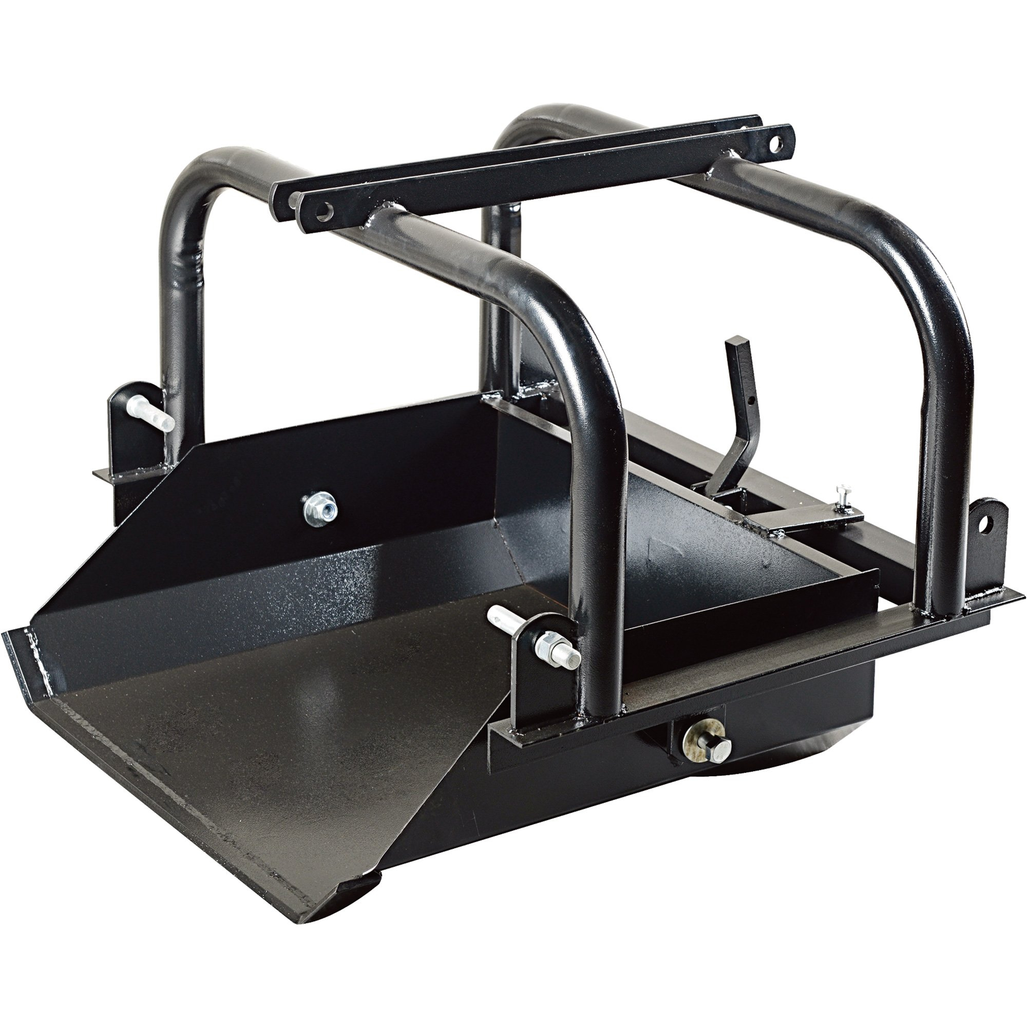

How about a 3 point dirt scoop?
It is reversible:

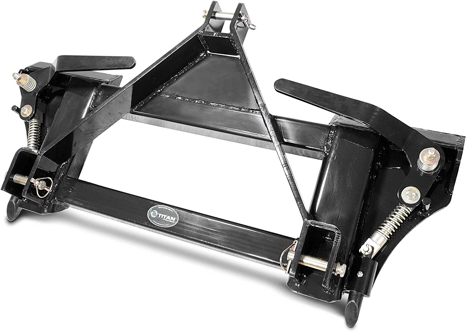

Not sure if this will work on your Steiner but I use this 3 pt to SSQA adapter to put a FEL bucket (or any other SSQA attachment) on the 3 pt hitch:
I back into a pile of material and once loaded, use a hydraulic top link cylinder to tip the bucket back.
