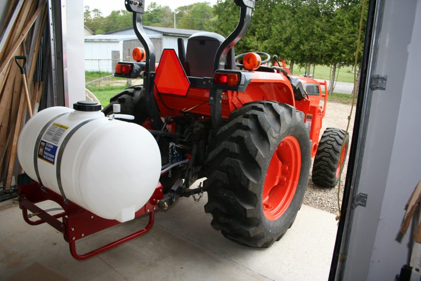

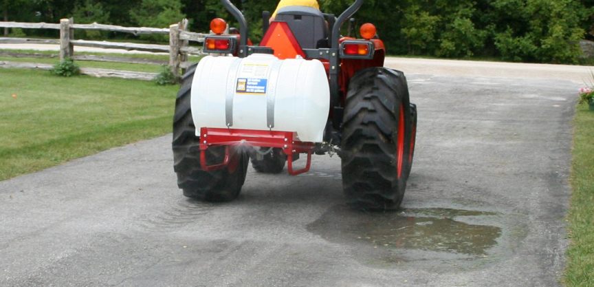

I have a 55 gal boomless sprayer. Only got to use it a few times last year. I was concerned with wind blowing the spay all over the place but I found that not to be the case. I used a blue die, as was suggested ny someone here on tbn, the first few times to eliminate over spraying. Being a boomless I can spray through the fence lines without loosing a boom to the fence.
picture 1 - boomless nozzel
picture 2 - sprayer on tractor
picture 3 - picture spraying with water
