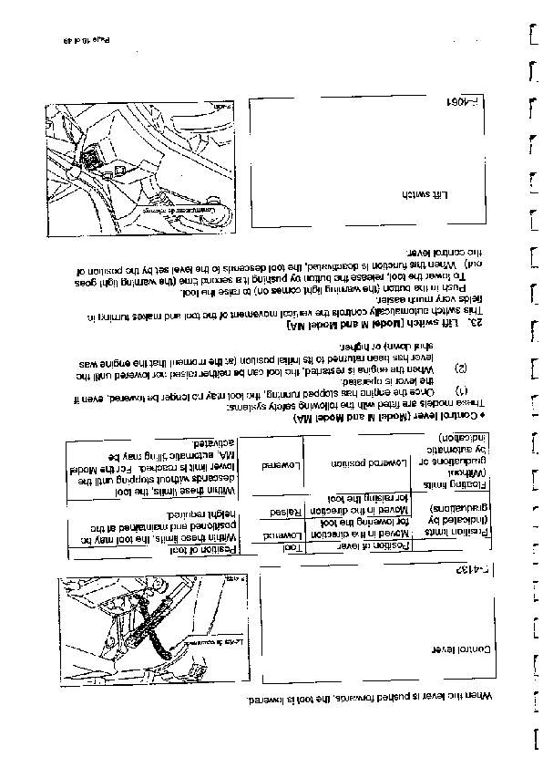

Hi, we have a kubota B1-17 with a problem in the three point lift when the engine started word does this by itself to high we go there on it Drops these and everything works properly electric everything good the problem is in the hydraulic system does some one knows what it is
Hi Bvanderweerd
If I understand well, you need that information in the attached file. There is a switch (green button) which is probably pushed in, it raises the tool.
