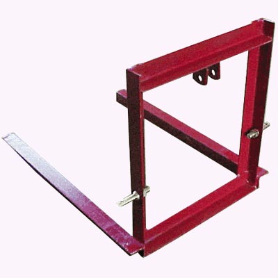

I'm assuming your forks are similar to the attached pic.
If you have a quick attach setup for your loader bucket then you could fabricate a matching quick attach plate. The plate could have a couple of horizontal tabs (angle iron) welded on with slots on the top edge that engage the lower pins (look at the way a Pat's Easy Change operates). Weld on a piece of square tube to engage the U bracket and pin on top. If you don't have a quick attach bucket you could weld similar attachments inside and on top of you loader bucket engage lower and top pins. If you go this way, the lower tabs inside the bucket could be made small so they don't interfere with or be damaged by with loader bucket use. You might need to add some intermediate attachment bars to connect your welded tabs to the 3 point top.bottom pins. These could be bolted onto your welded tabs which would take a little more effort to hook up/remove from your bucket, but would preserve the original configuration of the fork bracket so you could use them on the back.

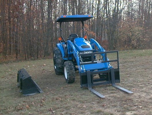

See my post "Post your pictures of forks". It has a lot of good ideas from many TBN'rs. l.

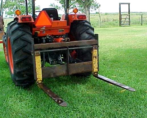

Suggestions:
1. Start with real forklift forks. They are very available. The metalurgy is much better that "make em yourself" forks.
2. You can make the framework yourself. Mine adjust by sliding on a round bar.
3. I first made mine for 3pt because I had no FEL. They were strong enough to lift the tractor fron wheels and not bend the forks. My FEL came and had has Bobtatch (very recommended) so I converted the forks to Bobtatach for FEL use. After a short while I wanted them to work on 3pt also, so I adapted the bobtatach to also work with my Speeco qucic hitch. The Speeco hitch is also very recomended.
I can put the forks on from or back in minutes. Yesterday I carried a 300 gallon water tote on 3pt end to water trees. I use them on the FEL for tree limbs.
Forks are a great addition. Build them strong enough that the tractor stops before the forks bend. You will eventually test them at maximum tractor power.
Photo shows before the bobtatch and paint.

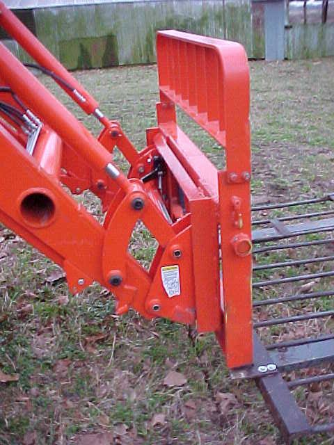

If you have the QA feature on your loader then I would seriously recommend that you construct a set that can be used with your loader. We use ours quite a bit and I can tell you that once you have used a set that can handle the same loads as your FEL you will be amazed at all the uses that you will find for them. The set in my picture are store bought not home made but if I was going to construct a set it would be safer to start with a good set of forks from a retired fork-lift. Call a few salvage yards and I'll bet you can come up with a set reasonable.
