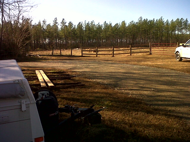

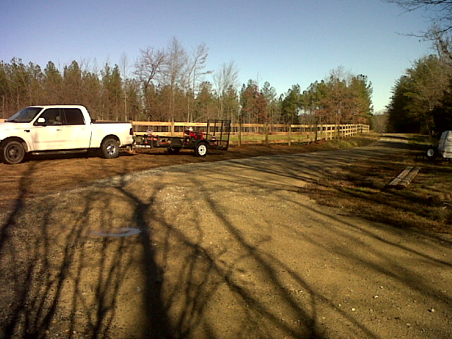

   / Three post horse fence help #4
Here are a couple pictures you can see how I built the fence...
I put posts on the outside, so my horses won't hit them. I spaced the boards with at least 12" open space between them.
For the electric, I don't have many pics (not all that attractive) but I used a combo of pounded in T-Posts, and step in fiberglass/plastic posts. in some places, I've added nylon line tied to pounded in wooden stakes to provide tension & stability to the step-in posts.
Hope this made sense.
Be well,
David
