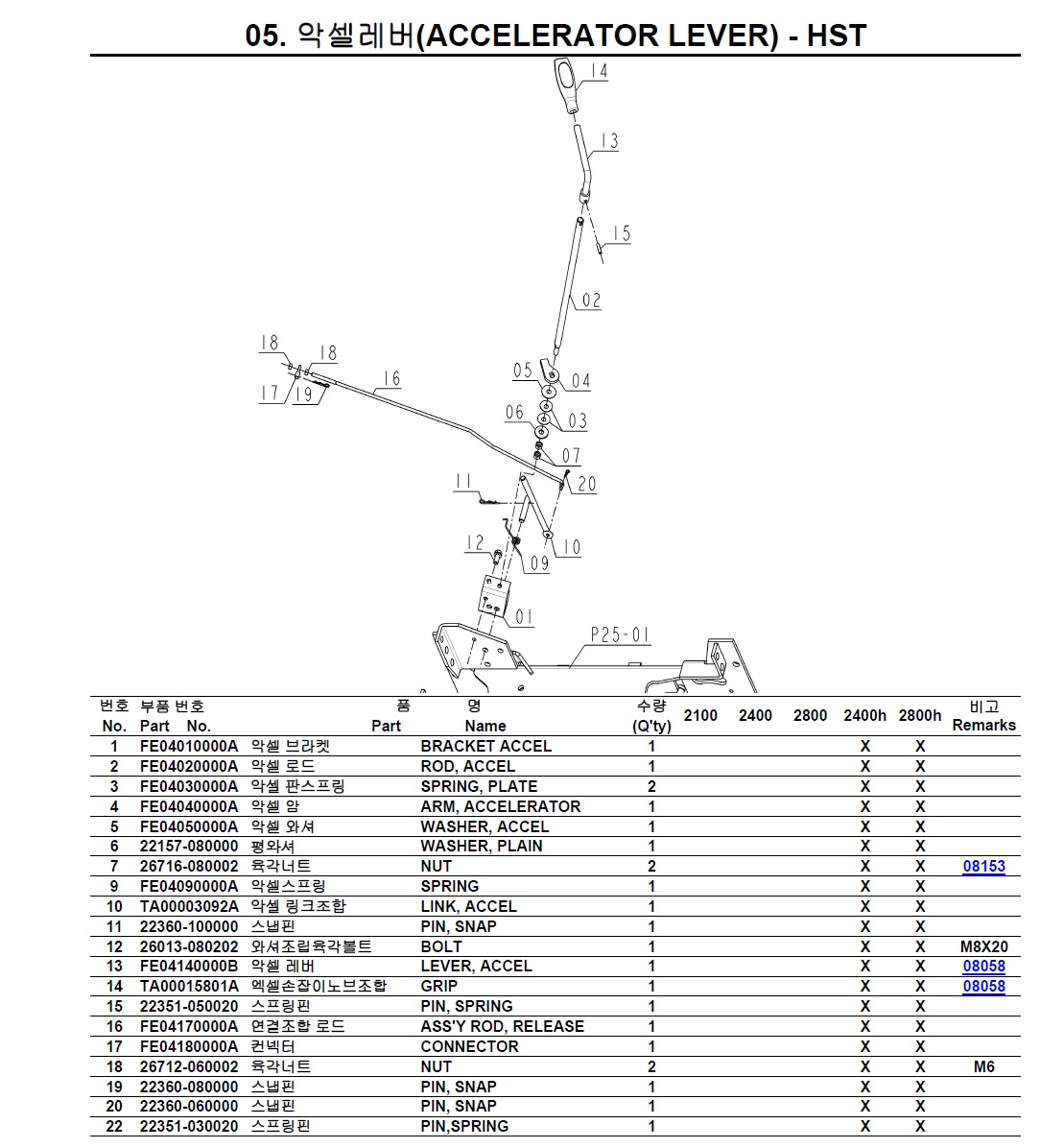

I have a Branson 2400H and I am having problems keeping the throttle set. There appears to be no friction to hold it in place. I tightened the nuts at the fuel pump (?) and that helped for a little bit but not now.
Is there another place to get more friction? I looked at the linkage and I don稚 see any. Or is there a spring that I can adjust to reduce the pressure.

You need to adjust the throttle lever. The friction discs and nuts to adjust are behind the dash.
Here is a picture of the parts list to help:
The nuts you need to adjust are marked as number 7.

You will need a thin 12 or 13mm end wrench to hold the top nut while you tighten the bottom jam nut. A little challenging to get two wrenches in that area but doable.
The design has a tendency to work these nuts loose.

Thank you both for the information. That fixed the problem. It is tight now.
And with the warning about needing a thinner wrench, I just ground down an extra 12mm wrench and didn’t waste time trying it without.
