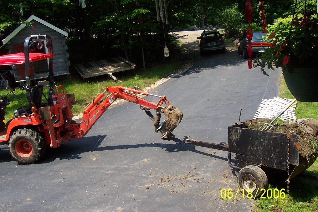

HI FOLKS,
I thought id show you how i haul my dump cart with my hoe on.Im digging under the eves of the house and putting in stone.I wanted to be able to haul my trailer along,putting the dug up grass and debri in as i go.I took a short peice of i beam,and welded on some braces so i could hook my reese hitch thingy majiggys to it.[is that a word?]Well any way i simply grab it with my thumb..and instant trailer hitch.heres a pic loading.
ALAN
   / thumb and tag along trailer
#2
LETS TRY AGAIN.Thanks to the changes i got to learn all over again

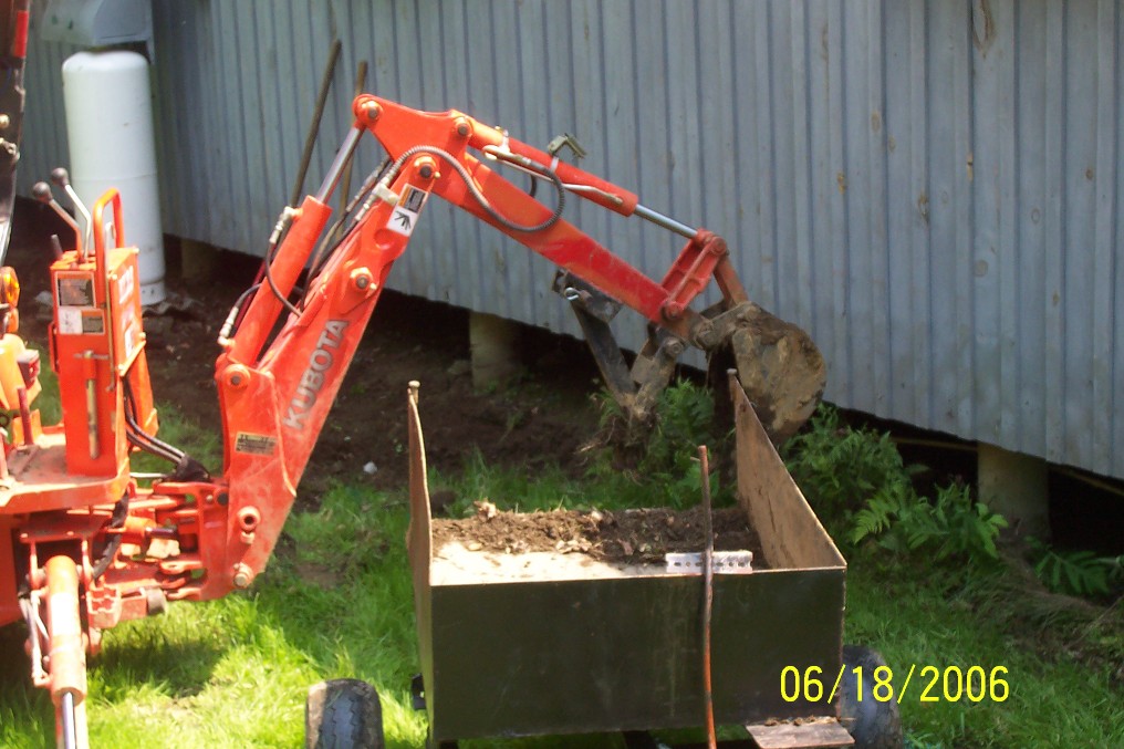

another loading

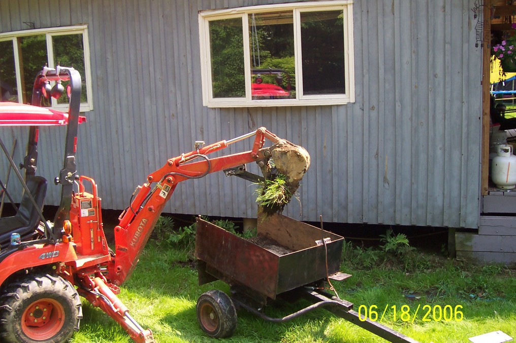

trailers full...now grabbing the i beam

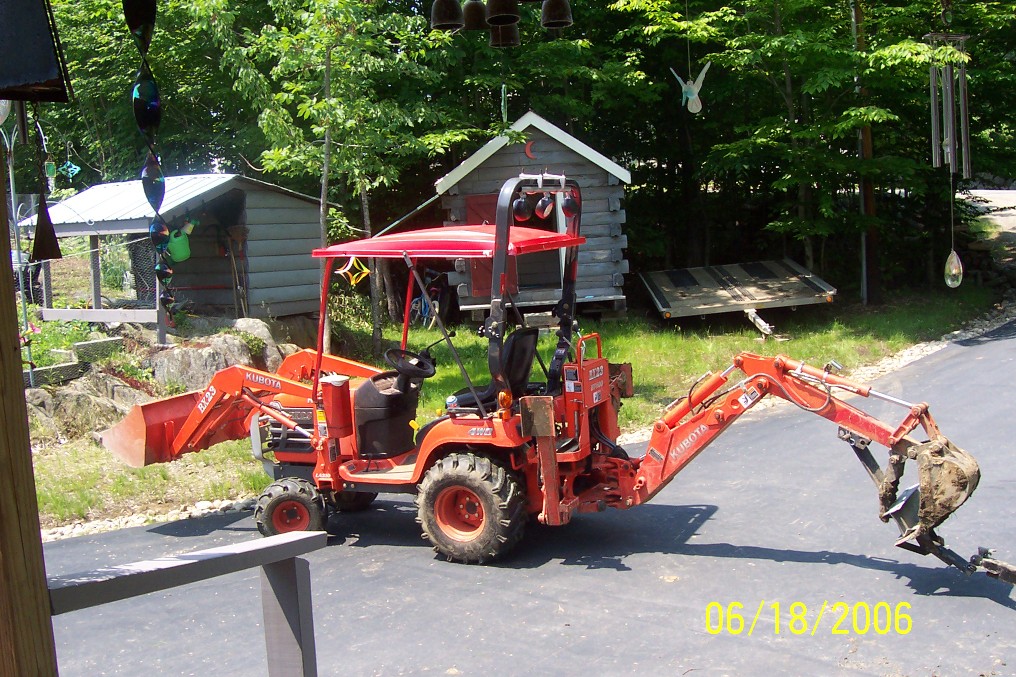

pulling the trailer.simply lift up the hoe to dump.It backs up easier than my atv too.hope someone can use this idea.
