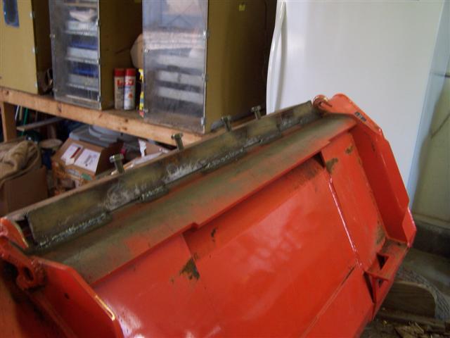

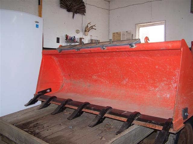

   / thumb attachment to my 66" hvy duty round back bucket #3

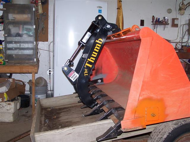

I am in the process of attaching a greens-machine thumb to a round back bucket(Kubota 854 loader)I will post pictures later ,but basicley what I am doing is welding on 3/8 by 4 flat plate on top of the round and braceing back to the bucket.The nuts will be welded to the bottom of the plate.

   / thumb attachment to my 66" hvy duty round back bucket #5
This is a greens-machine thumb attatched to a kubota round back bucket.
28 inch model.Bucket is for an 854 loader on a L4240.

Great pictures!! My 66" round back bucket is made a little different than your round back for your 854 loader. My top round edge is almost perfectly flat with the 3/8" bracing plate that welds to the round front edge. That being said I think I can fab a 1/2" plate 5-1/2" x24" and mount it to the factory 3/8" plate while laping over the round edge.
I just got my thumb from greens machine today and boy is it heavy duty!!
I for now will be using my rear remote for operating the grapple. Future plans are a true third fuction electric over hydraulic valve with joy stick along with quick disconnects.
I will post install pictures tomorrow if all goes well. Now if I can just get to sleep and stop thinking about all the uses I will have for my new toy..... :)
   / thumb attachment to my 66" hvy duty round back bucket #8
Make sure everything is where you want it before you weld solid.Tack up and install the all the thumb parts.Mine was the third version.I wanted the thumb to grip the bottom of the bucket.I had the third function valve already installed,if you run from the rear;check fluid levels after installation. Good luck with it.
