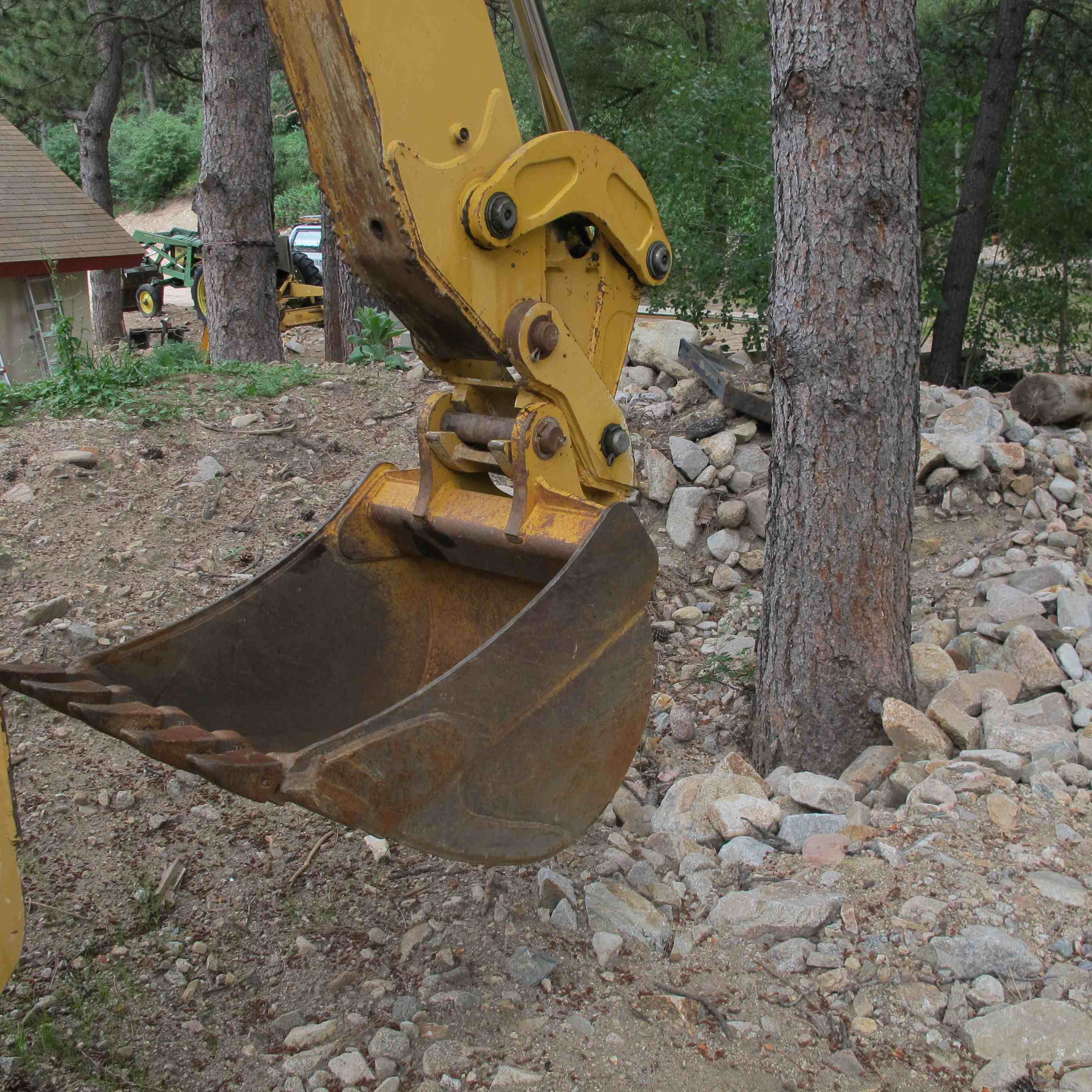

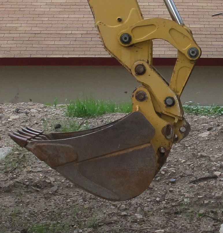

I'm thinking probably pin-on....The bucket is the size I like, and also I'm not sure about welding to the 310 with extend-boom....for that matter I'm not even sure about how a pin on fits on this type of bucket mount. Here are some pics; anyone have any comments?

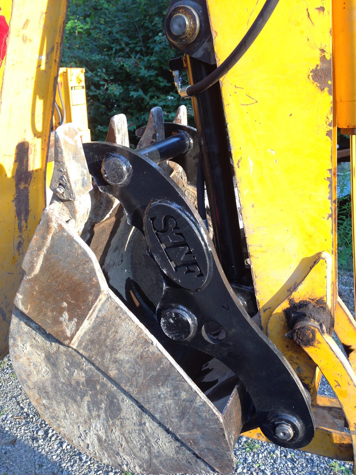

It looks like you have a quick coupler installed. You can ignore what I said about pin on thumbs interfering with bucket changes since you have the quick coupler. You would probably want to keep this as it makes bucket changes easier. Without a quick coupler the bucket and thumb would both pivot on the same pin (the one circled in blue in the attached photo), but with the coupler your bucket hangs off the coupler not on the dipper/stick. The thumb and the coupler would share the same pin (the one circled in blue). The only thing you need to make sure to do is tell whomever you buy the thumb from that you have a quick coupler installed. They will then make the thumb a bit longer to compensate for the coupler.
attachment.php

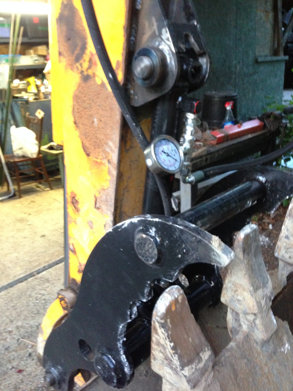

I've attached another photo that shows the pin on thumb mounted on my backhoe. As you can see the thumb and bucket both share the same pin, on yours the thumb and coupler would share the same pin. Oh and you still need to weld on the upper mount for the hydraulic cylinder to the stick of the backhoe. It's just that with a pin on thumb there is a lot less welding to the stick.
attachment.php
Here is a shot that shows the upper mount, that needs to be welded to the stick.
attachment.php
