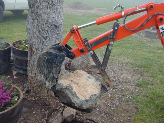

Hard to imagine how I ever got along without it.
Pretty simple bolt-on design.
Material is from 3/8" x 1.5" concrete form stakes.
Of course, after putting it to use, I have some design flaws but none are evidenced buy falure of the thumb itself nor breaking part of baby.
Cheers!

Re: Thumb ... GEEZ IT\"S HANDY !!!
On to getting trash outta the creek...

I think this is the first time I have seen anybody put a thumb on a BX23. It looks good - I have been toying with the idea of putting one on my BX too but I haven't yet seen one small enough to fit the BX23 backhoe - I want one that folds out of the way so I don't have to unbolt it when I am not using it.
Hmmmm, I hadn't even thought about folding it back cuz it only has 4 bolts attaching it ... but, I removed all but the foreward top bolt and it folded back pretty nicely. I'm thinking if one used 1/2" pins with hairpin retainers, it would probably fold up out of the way enough to get, at least, most normal backhoe work done ... who'd-a thunk it. Thanks for the thought Jim.

That is a nice setup, and easy to remove too. Have you seen the other mechanical fold away style of BH thumbs? Yours could easily be adapted as a bolt-on type of mechanical fold away. That is some nice work! /forums/images/graemlins/wink.gif

Ya know, I don't remember seeing a foldup style of thumb before. Would you happen to have a link or pic. Um, I am assuming you're speaking of a thumb that is "designed" to fold up ... not one that "folds up" due to failure /forums/images/graemlins/wink.gif

Ohhhh, I like those thumbs (drool). Somebody was using their first-string brain when they thought those up.
Thanks for the links.

Hey, fold-away was Sky's idea first.... /forums/images/graemlins/smile.gif
Excellent work Brew. You should dial that in a bit and sell them as bolt-ons for BXs. I've never seen one for a BX before. You got me thinking about a thumb for the L39 agian. They essentially double the value of a hoe....A must have.

Thanks, Jim. You're right, the thumb at least doubled the usefulness of the hoe ... it's really like having an additional machine. As you say, a must-have!
