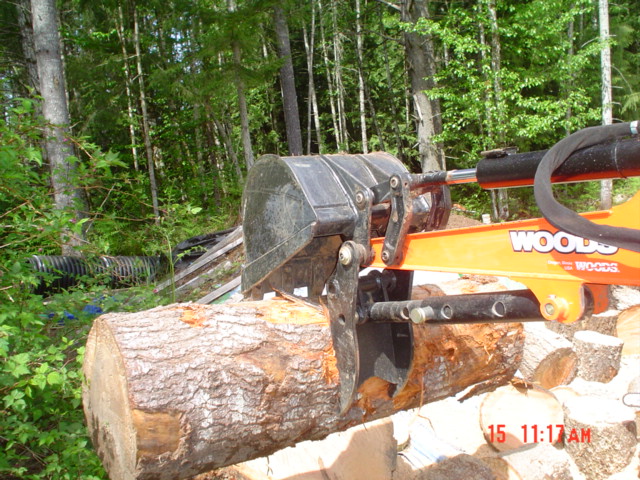

I have a Woods BH80-X which originally only came with the mechanical thumb option. They now offer a hydraulic version and I bought their conversion kit, which comes with all the hoses, a valve, the cylinder and the foot control. It was expensive. I paid $955 at MB Tractor, which is where I originally bought my tractor, but they also had the lowest price on the kit. I'm sure you could do the conversion cheaper, but I really wanted the foot control.
The kit looks top quality. All the hoses are sheathed just like the originals. All JIC fittings and the foot control and mounting plates are 1/8" steel.
You wouldn't happen to have the p/n for that kit would you? I have the same BH80X with mech thumb and wouldn't get a BH without the thumb.
part #1031115 HYDRAULIC THUMB CONVERSION KIT for BH80-X
If you go to the woods website you can download the installation manual and see what is involved in installing the kit. You have to do some cutting on the console as well as drill two square holes. :cool:
PLEASE document and photograph the heck out of your installation and post it!
I've the 70X w/ thumb and would love to put on a hydraulic control, even if it was jury rigged as a hand control.
Woods documents both the BH80X and BH70X thumbs as the same item. http://www.woodsequipment.com/workarea/DownloadAsset.aspx?id=17359
