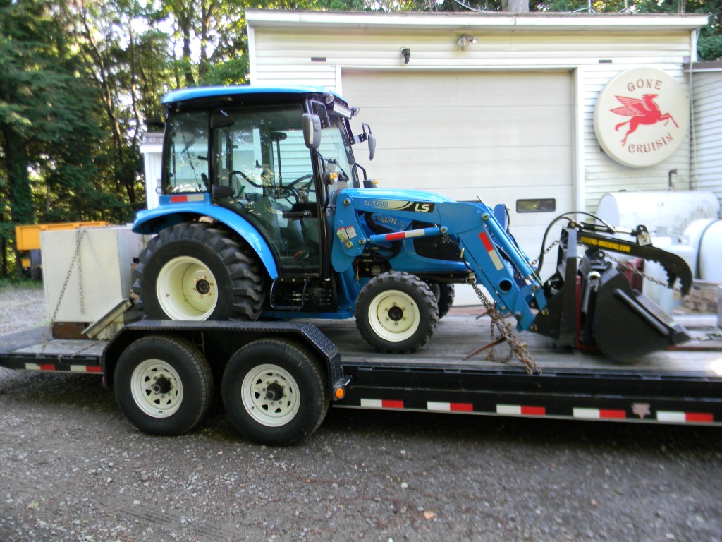

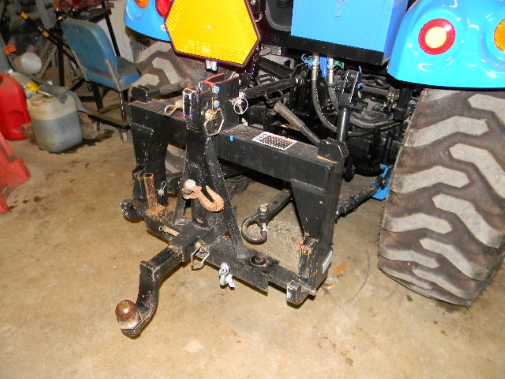

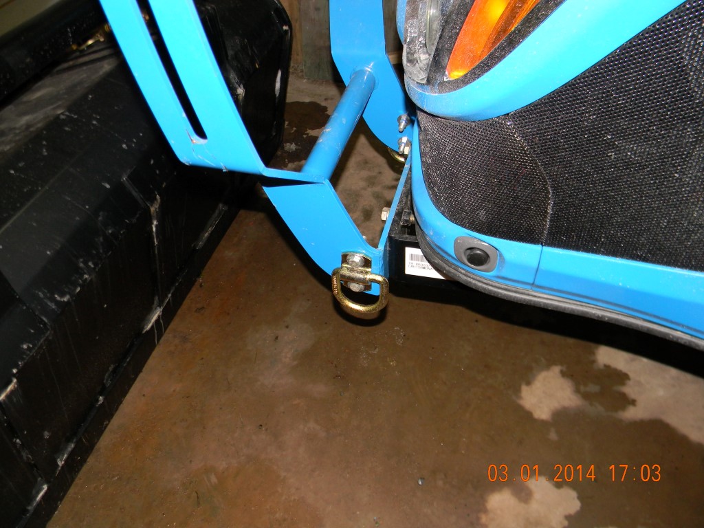

You can buy a couple of bolt on D-rings and either bolt them to the brush guard or tractor frame. I've attached pics. I first bolted mine to the brush guard and later moved them to the frame.
On the rear I tie down through a twisted clevis on the drawbar.

Concur with chaining to the brush guard or frame instead of the front axle.
The reason they don’t want you chaining to the axle is because it pivots in the middle. There arent any front to rear torque arms or drag links to keep the front axle from being twisted side to side.
If you chain to the outer end of the axle on one side, you are putting stress on the center pivot point before you can tighten the other side. If one side is tighter than the other and then you were to slam on the brakes, you could amplify the effect and possibly break the casting.
I also believe that is why you dont see front locking differentials as optional equipment. With an open front diff, both front tires pull equally until one loses traction, then neither one pulls on the axle..
   / TIE DOWN locations on tractor for towing??? #6
I’ve always used the brush guard although welding D rings to the frame would probably be better.

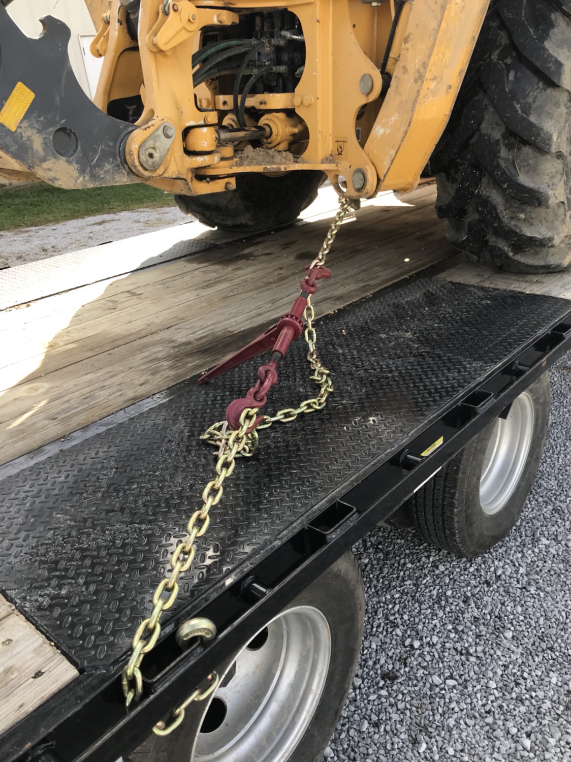

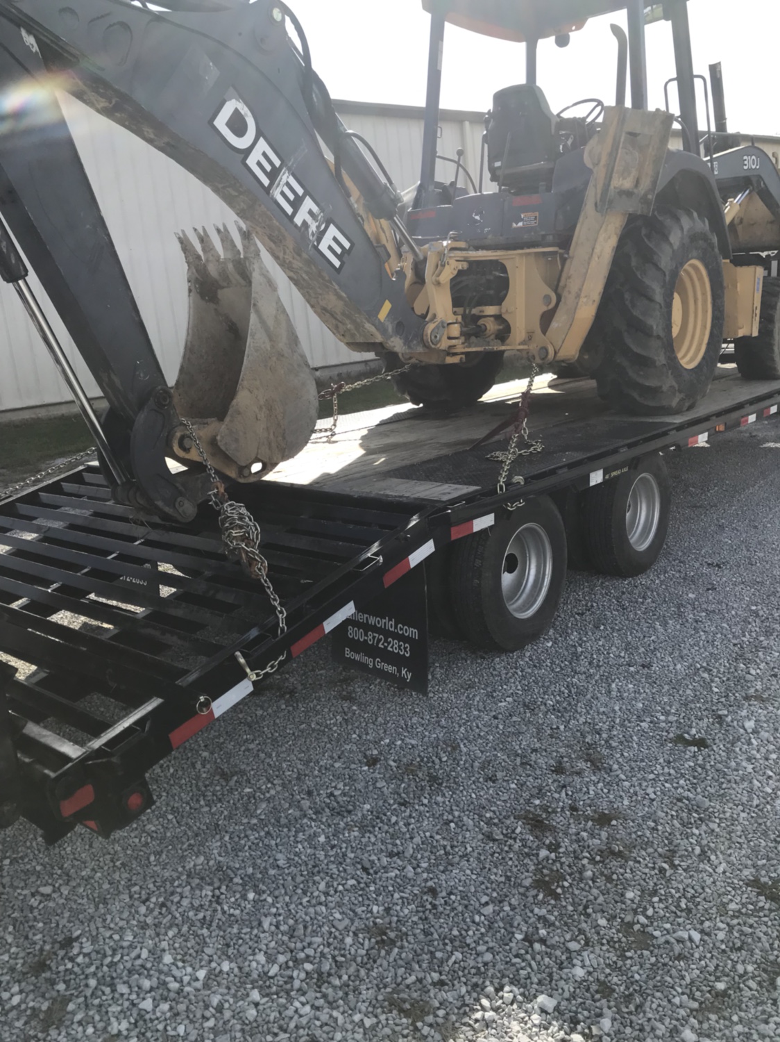

What’s your view on this? I’ve been told the angles are too long. I did end up moving true hook points forward to the next stake pocket which I think looks a little better. From the tie down material standpoint those are 6800 pound WILL chains on the machine and the chain on the boom is a 4700 pound WILL chains. The red binders on the machine are 9200 pound WILL all the chain hooks on both ends exceed the chain limit. So I think that part is good. And the backhoe has nice convenient hook points at all 4 corners. IMG_0780.JPG

I recall reading some guide that said to try for 45 degrees. You are trying to prevent both front-back motion as well as side-to-side with the same chains, so split the difference.
