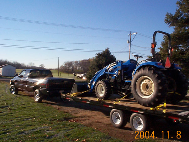

It's been awhile since I've posted but sure feels good to be back on TBN again. So much has happened since I was last on. I must say wow what a TEXAS SIZE team effort on the bridge for DON(txdon). Well done!!!! Sorry for the long post but here goes.
Took my TC45DA SS down to the dealer last Tuesday morning to get the front end looked at and my 50hr service done for free labor just the cost of filters and fluid.
If not for the front end being a little out of adjustment I would've picked up the filters myself and done the service but what the heck it's her first 57hrs and labor was free.
<font color="red">Anyway my point of this post was to ask if anyone has had problems with their TC's toeing out of adjustment? And do you think this could be more so Super Steer Related than not? </font>
I noticed mine was really out of wack the last time I cut with it. It was really noticeable when I went to make a turn. One tire was no where near in the same turning angle as the other.
I called the dealer today and it's ready to pick up so tomorrow I'm going to pick her up. He told me that the left tie rod was 3/4" out of adjustment and said he thinks Super Steers tend to have a better chance of this issue happening due to the over traveled steering. I'm just happy she's fixed and ready to start working again. /forums/images/graemlins/smile.gif
