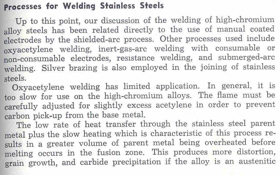

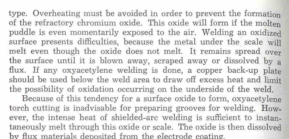

OK, so I was out tonight with an old school welder. Friend of friend. I was on about the new toys, mentioned the thought of doing some aluminum and stainless and getting a tig for my Lincoln stick and he asked me why. His feeling was that I could get the same results with a torch.
I asked about thin stuff and he said it torch is just as good as tig. I guess experience would be the great leveler in this conversation, but thoughts on his thoughts?
   / Tig vs Torch #2
Stainless steel with an O&A torch? Never seen or heard of this. Be interesting to see it done.

Sure it can be done with a torch. And just as good. But tig is easier and faster.

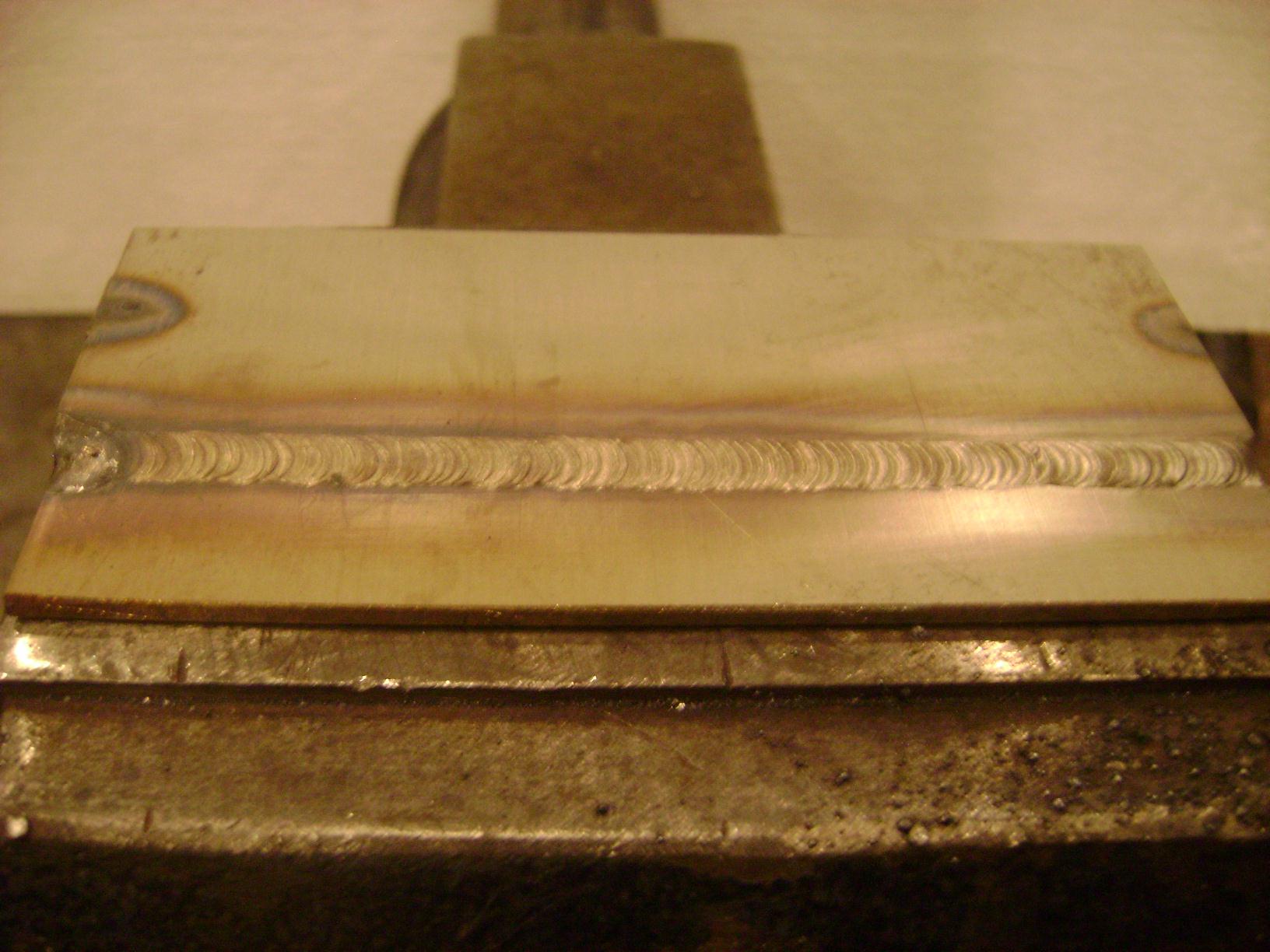

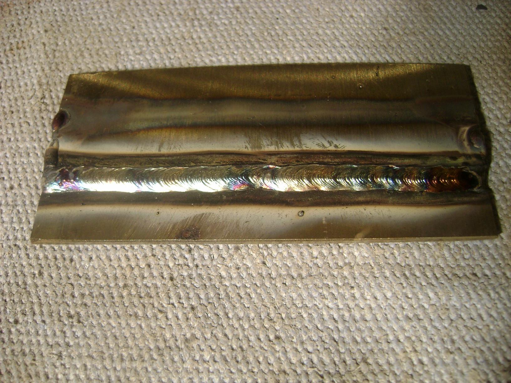

I doubt I will ever try welding stainless steel with O&A. What little I do with stainless steel I'm very happy with GTAW, and SMAW. Both of these were done with my Everlast PA-200. First one is with a Tig rig, second one stick.
While looking for pictures, I found this, I'll bet I scanned it out of the Lincoln Procedure Handbook of Arc Welding. Boy is my memory going or what?:shocked:
