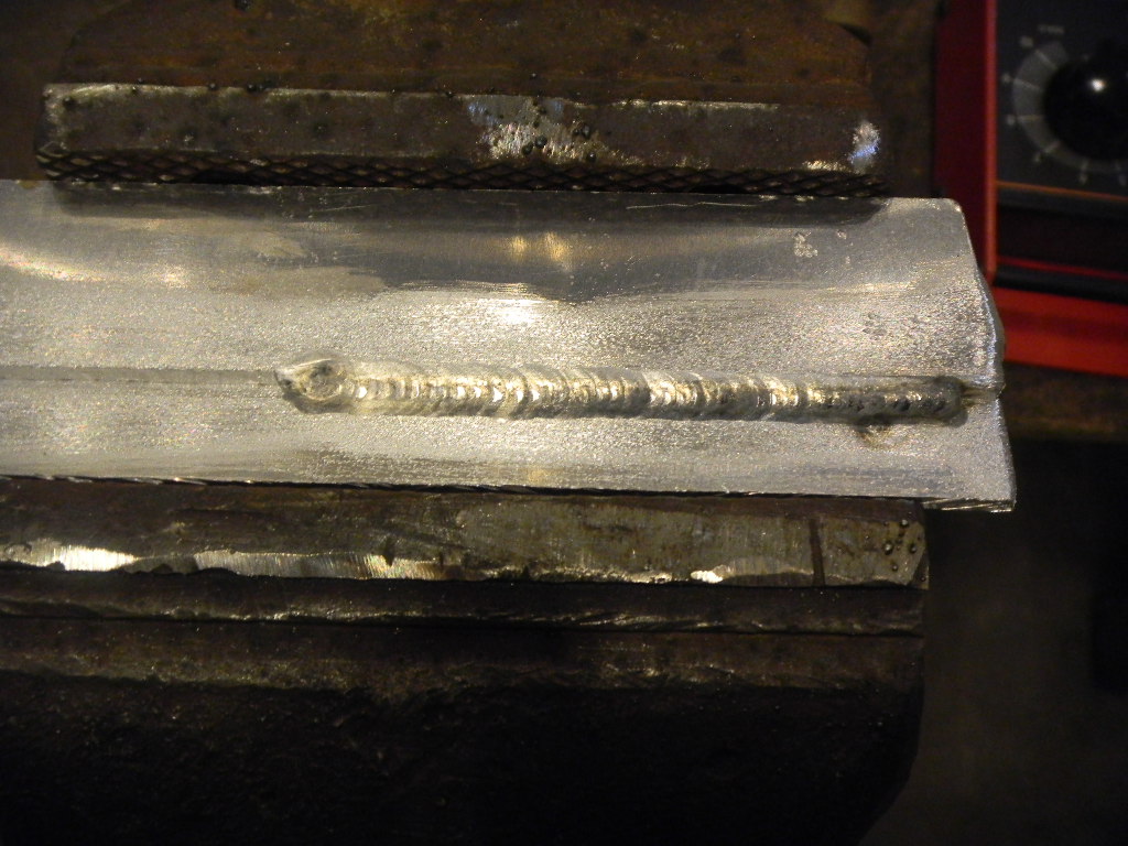

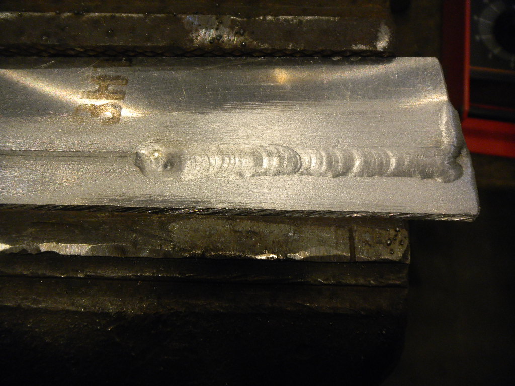

I have read somewhere were guys have used 100% argon on a DC welder. I don't think I've ever tried it. I've only used 100% helium.

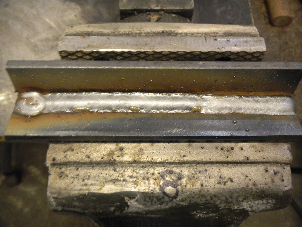

Now I've run Mig on a CC only engine drive welder. But you have to run it really hot. So technically it is in spray.
