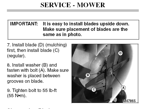

Not sure if I should post here or in Lawn & Garden...mods move post if necessary.
Bought an LX178 (94 model) with the 44" mulching deck. I'm cleaning up the deck and sharpening the blades. When I first got the mower deck turned over (three spindles with two blades each for total of 6 blades) I found the two outer sets of blades would spin independently of the pulleys which told me they weren't torqued down all the way. The center set of blades spun together with the pulley.
Now I'm putting it all back together and the manual says to torque everything down to 55 ft-lbs. I'm trying to tighten the bolts but need a way to keep the pulleys from spinning. Is it ok to stick a screwdriver through one of the four openings in the pulley and hold the pulley against the aluminum spindle housing? I just don't want to break anything. Is there a better way to keep the pulleys stationary so I can torque the bolts to 55 ft-lbs?
Enclosed is a photo of the top of the deck from the manual. The openings in the pulleys can be seen in the top most pulley (the other two pulleys are under the side covers). The other photo is from the operators manual.

I used my impact to tighten the bolts and that worked great but when I used my torque wrench to do the final tightening to 55ftlbs, I found that even though the bolts were at least 55 ftlbs the blades could still be moved independently of the pulley (not by hand but with the blades blocked with wood against the deck and using the torque wrench on the bolt). It's almost as if the the washer under the bolt isn't thick enough to apply enough pressure on the blades to keep them from spinning. Is this normal? Maybe so if you hit something the blades will give a little without the transmitting all the shock to the spindle/pulley? Or should I put a second washer in there as a shim to make sure the bolt applies enough pressure to sandwich the blades in place?

I used my impact to tighten the bolts and that worked great but when I used my torque wrench to do the final tightening to 55ftlbs, I found that even though the bolts were at least 55 ftlbs the blades could still be moved independently of the pulley (not by hand but with the blades blocked with wood against the deck and using the torque wrench on the bolt). [[[It's almost as if the the washer under the bolt isn't thick enough to apply enough pressure on the blades to keep them from spinning. Is this normal?]]] Maybe so if you hit something the blades will give a little without the transmitting all the shock to the spindle/pulley? Or should I put a second washer in there as a shim to make sure the bolt applies enough pressure to sandwich the blades in place?
Theres something wrong - worn as you surmise, or missing parts. See if you can get a look at some new parts then correct yours accordingly.

I think I'll do that. There isn't much to it. The deflector (#15 in the diagram) sits between the blades and the spindle and then there is the washer (#24) and bolt. I guess the deflector and/or washers could be worn enough to make a difference but they look to be ok.
Does the bolt screw freely into the shaft far enuf to clamp everything up? You could be running into grody threads at the bottom of the hole.
