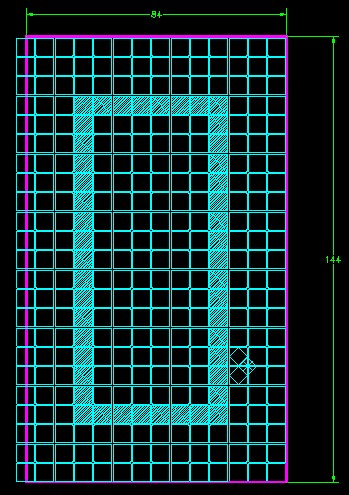

I'd like to tile our laundry room and I need some ideas on pattens and designs.
Most books show the "how to" but don't have much in the way of designs.
Know any websites or books or have a simple pattern that you like.

The room is 12x7 but it has shelves and washer and dryer so it looks smaller. It ajoins the kitchen which is much larger so I thought I'd carry the pattern into there on a larger scale. I guess what started this was a trip to HD or Lowes about a year ago. On the wall in the tile section was a really nice pattern using the tiles you could purchase below the display. My wife and I liked the pattern but we were in the middle of finishing the MIL's house so project was put on hold. Now they don't sell that tile anymore. All I remember is it was 6x6 with a straight set border around the walls and a rectangle in the middle but some of the tiles were cut at 45deg.

First off, thanks for all the replys. I looked at the Daltile link and I think this is the one I saw at Lowes.
I guess I need a mix of 4x4 and 6x6 to do this pattern.
I laid out a pattern with all 6x6 with two colors. The main is a sandstone and the inlaid is an olive green. What else can I do with all 6x6
