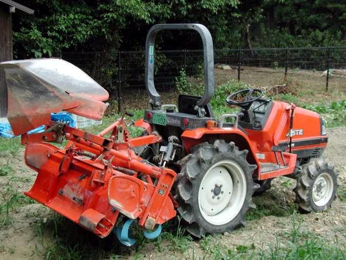

I'm wondering if anyone has a method for marking rows behind a rotary tiller. I usually till a row thoroughly, then go back and make small furrows for planting seeds, using a triangular hoe.
I was thinking I might attach something to the rear door of the tiller which would drag along behind and make evenly spaced furrows. Any thoughts?
thanks!
tony w /forums/images/graemlins/smile.gif
   / tiller--row marker #2
Sounds like a reasonable idea. A bar (angle iron) across the back of the rear door to which you'd attach a variable number of little weighted hoes to make furrows. They need to be independently attached so they can ride up and down separately. A downside would be that you couldn't back up without risking damage unless you lift the implement and the dangling attachments free of the ground.

   / tiller--row marker #5
I was thinking the same thing my papaw has a tiller from lowes an MTD and it has a shank on the back that makes perfrect seed row.
and I also seen a kubota tiller in japan (someone posted here) that has an attachment off the back for making rice paddy rows i think it looks like a 1' ripper v-plow i'd about bet it'd work something like that.
