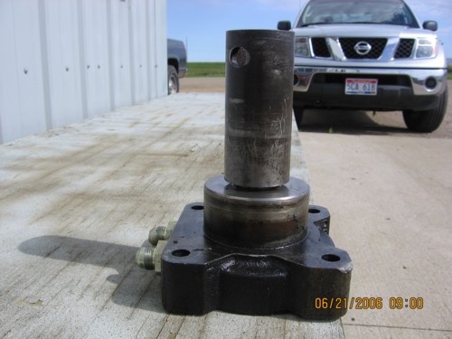

My tiller hydraulic motor developed a leaking seal by the shaft. The motor shaft is mounted to a threaded 8 inch cylinder that goes over and attaches to the tiller shaft. Removing the cylinder from the tiller tyne shaft was easy. I have been unable to remove the cylinder from the shaft of the hydraulic motor.
Has anyone replaced their tiller motor seal and do you know the procedure for removing the cylinder?

I have removed the motor from the trencher. Maybe it is the same. Look for my post on that or send me a picture of your tiller.
Bob Rip
   / Tiller seal replacement
BobRip,
I looked at your trencher post and I believe the connection it is similar to my tiller.
Dale

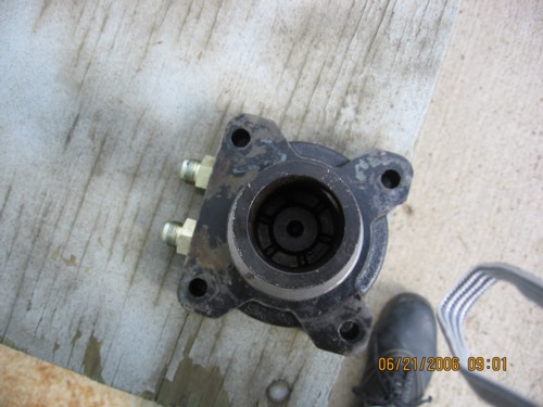

BobRip,
The is another picture looking down the barrel of the beast. I ordered the seal kit and bearing from PT. They will loan me the tool to extract the nut.

Yes, it looks the same. If you call Terry at Power Trac, they will loan you a special castellation socket. They have these custom made. They charge it to your credit card, and when you send it back you get credit. You pay shipping both ways.

If it follows the stump cutter - i.e. 4XX has a straight shaft, while my 2445 has tapered - you should be alright there, else you may want to have a press handy too.
I put a seal kit in my PHD recently and it's not too bad of a job.
