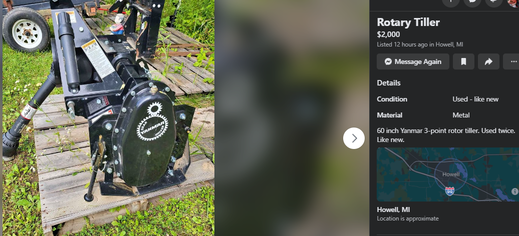

Guys in Michigan. This is a very good buy on a Woods RTR60.40 Tiller. The guy has it listed as a Yanmar, only the paint is Yanmar! I have one and they go for about $3700 new. Jump on it!
