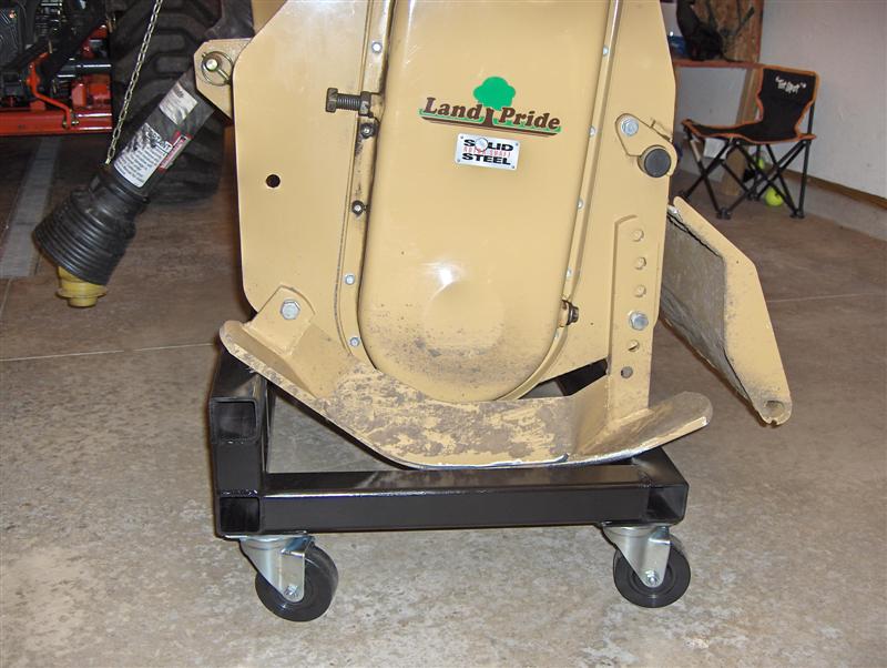

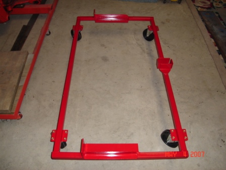

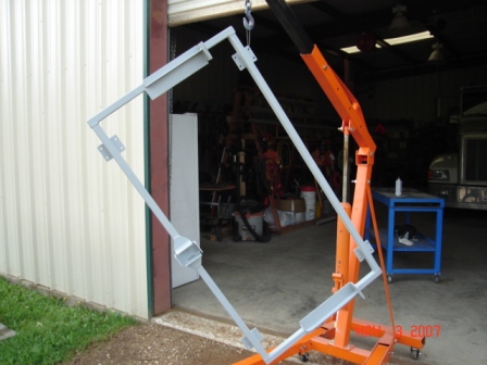

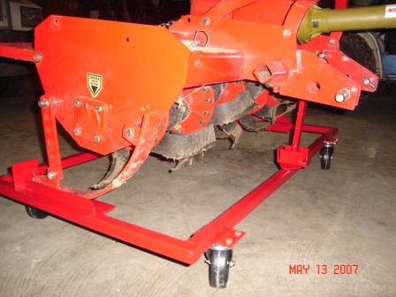

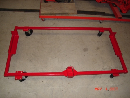

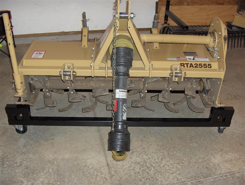

Since I recently purchased a new tiller and all that good happy stuff, the new tiller needed a good stand when not in use and to be easily manuvered when hooking & unhooking up easily....here is what I put together.
I used 5" casters, 1 1/8X1/8 tubing and some other 1/8 and 3/16 angles & flats, I capped the ends for a clean look and covered it with some Rustoleum paint, It moves so easy I can move it around with one finger:)

Very nice. nice attention to detail. do you have to put it at the max height adjustment to put it on the rollaway stand?

Yes Mj I have to put the skid adjustment at max height for it to set level due to the ft. stand height is not adjustable.

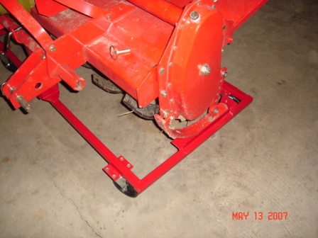

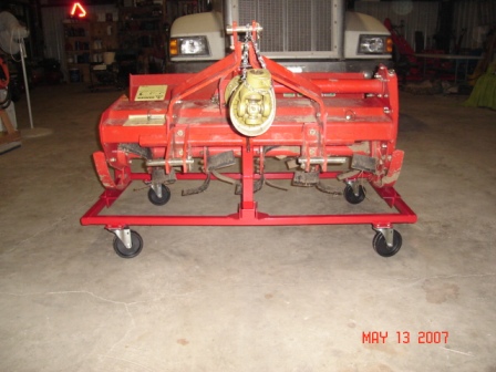

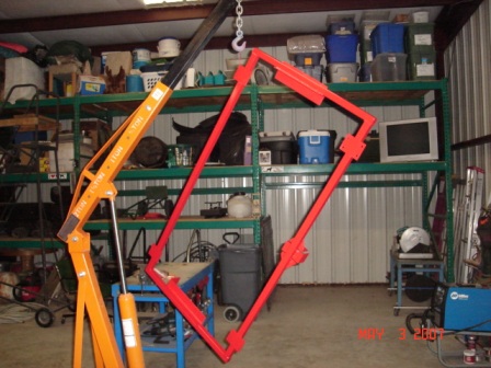

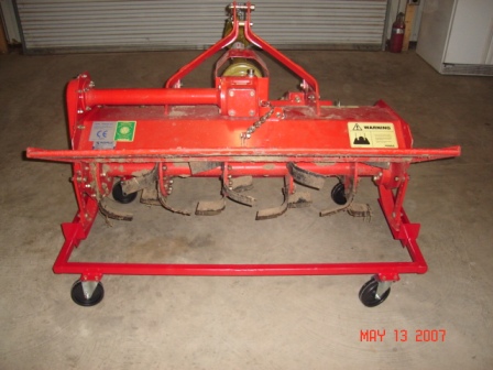

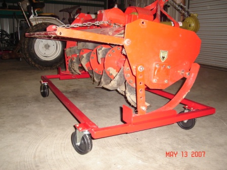

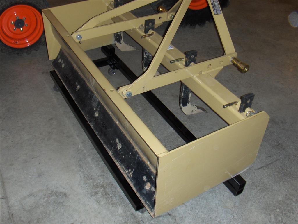

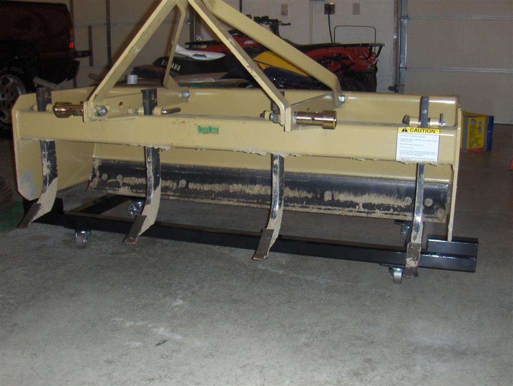

Looks very nice! I made a stand (dolly) for my tiller too. It makes them very easy to to attach on a smooth concrete floor. I made a dolly for the box blade and my middle buster. Life is good!
