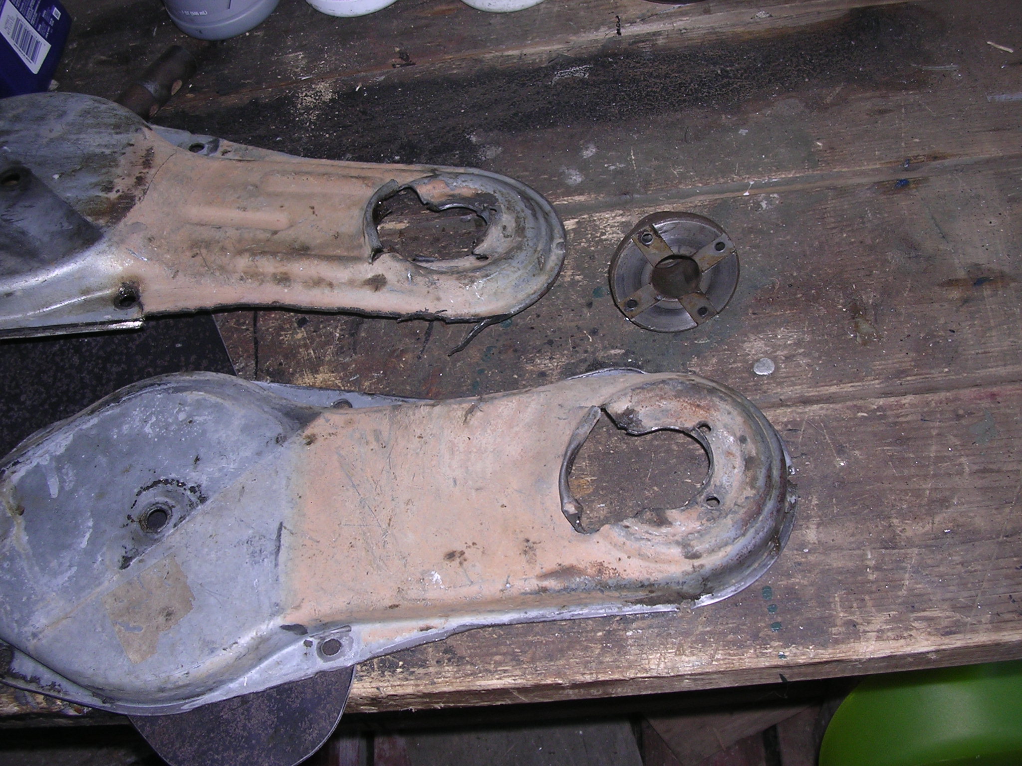

Yes, I know, not connected to a tractor, but this is the best audience for this kind of threat.
Anyway, I killed my tiller last year. The transfer case got busted - see the picture. It was stamped metal to start with and those little rivets just didn't hold.
It is MTB I believe, chain driven, front tine tiller.

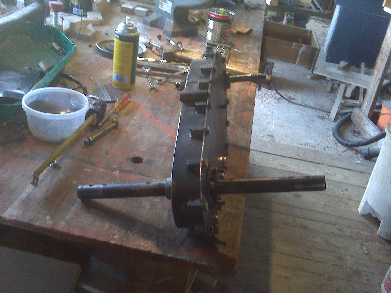

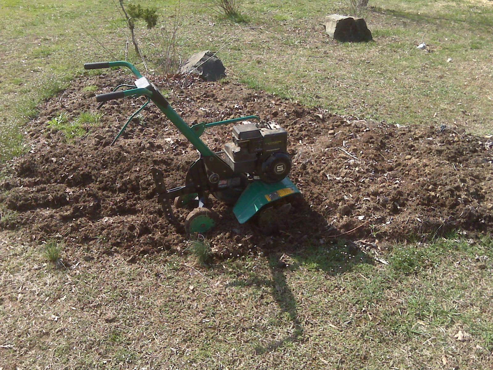

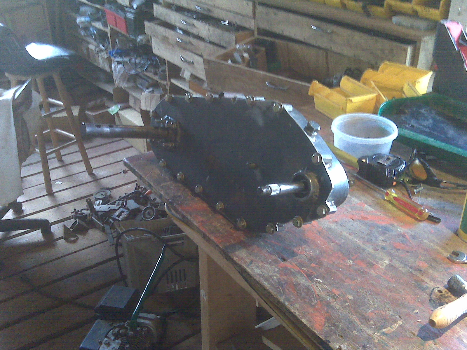

It took me almost a year to build a new transfer case. I used 3mm thick steel, reused the tine shaft bearings and oil seals - this time bolted them to the case - and after much head scratching and impro and compromising I have a working tiller again. The case is servicable, unlike the original and built much much stronger too.
I sealed the case with silicon, there appear to be no cracks and it is - so far - not leaking oil. I also used grease to coat bearings and left quite few scoops of grease in the case - the plan is for the gear oil and grease to mix to thicker goop than just oil.
It works and yes, the case looks like something from Jules Verne:)

The chain drive is forgiving, otherwise I wouldn't try it without better equipment - like a mill.
