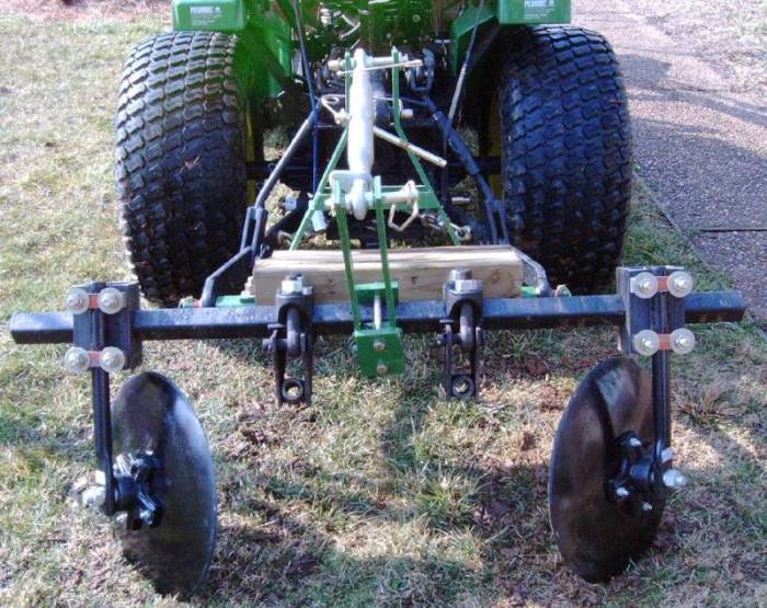

Attach a couple potato plows in the back? Attach 4 disc hillers?
Depends on what your tiller has to attach these to.
Here's a pic of mine, by attaching a couple 20" disc hillers to an old diamond bar from a JD M soil ripper.
