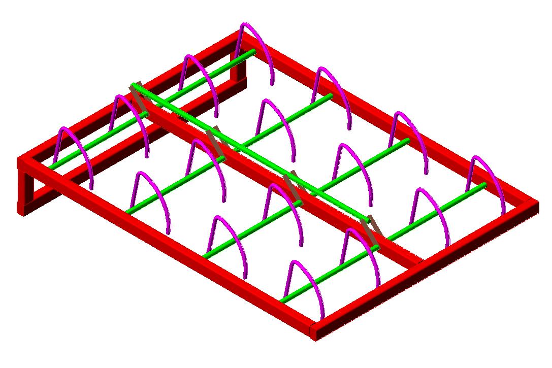

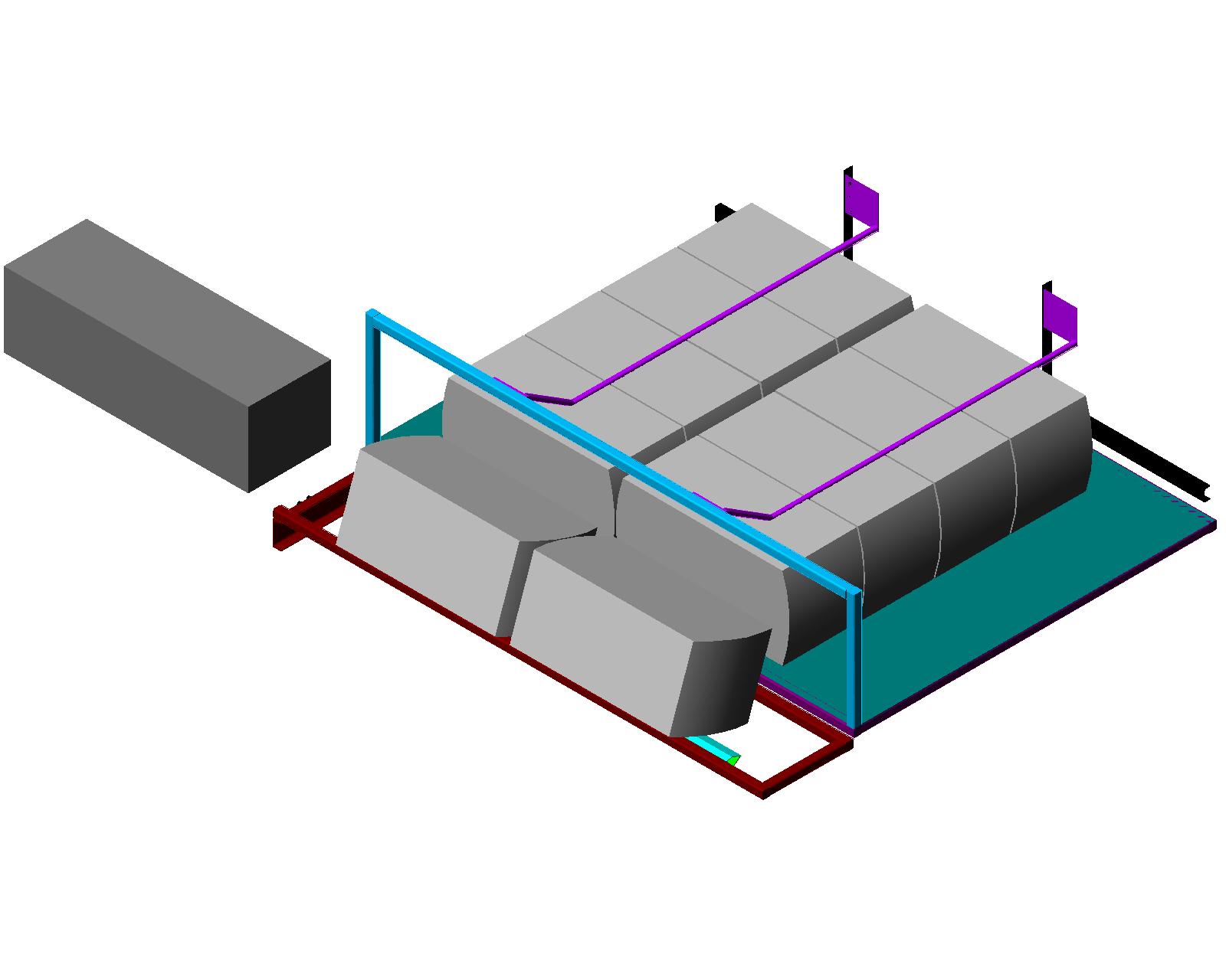

I am thinking of building a tilt bed bale accumulator to attach behind my wire tie square baler. Here are some preliminary cad drawings of what I am planning on building. I would like some constructive critisism on my design so I can improve it before I start to cut steel. I am designing it to collect 8 bales and then the bed will tilt and drop the 8 bales onto the ground. Once the bales are on the ground they will be picked up with a grapple attached to the front of the loader and stacked onto a hay wagon or semi trailer.

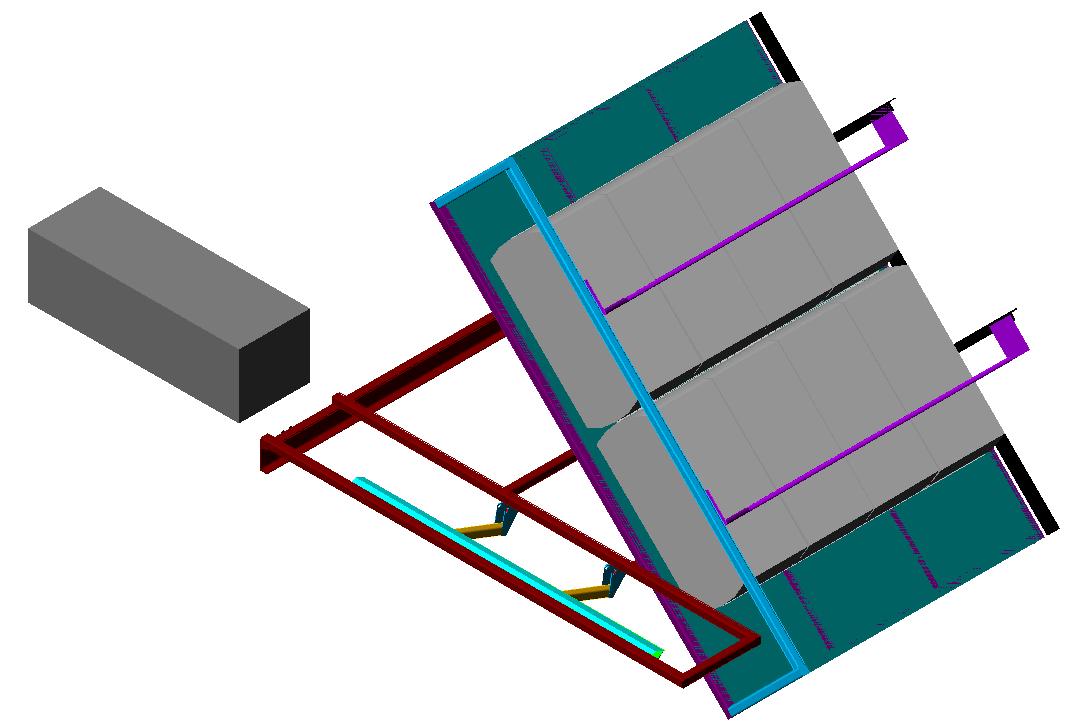

Here is a drawing of the accumulator with the bed tilted. I forgot to mention in my earlier post that i have not got the wheels designed yet, but they will be caster type so i can attach the accumulator to the baler in two spots. This would alow me to keep the baler running as i am making turns.

This is a drawing of the bale grapple that will be attached to the loader. There will be a hydraulic cylinder in the center that will rotate the circular speers into the bales.
