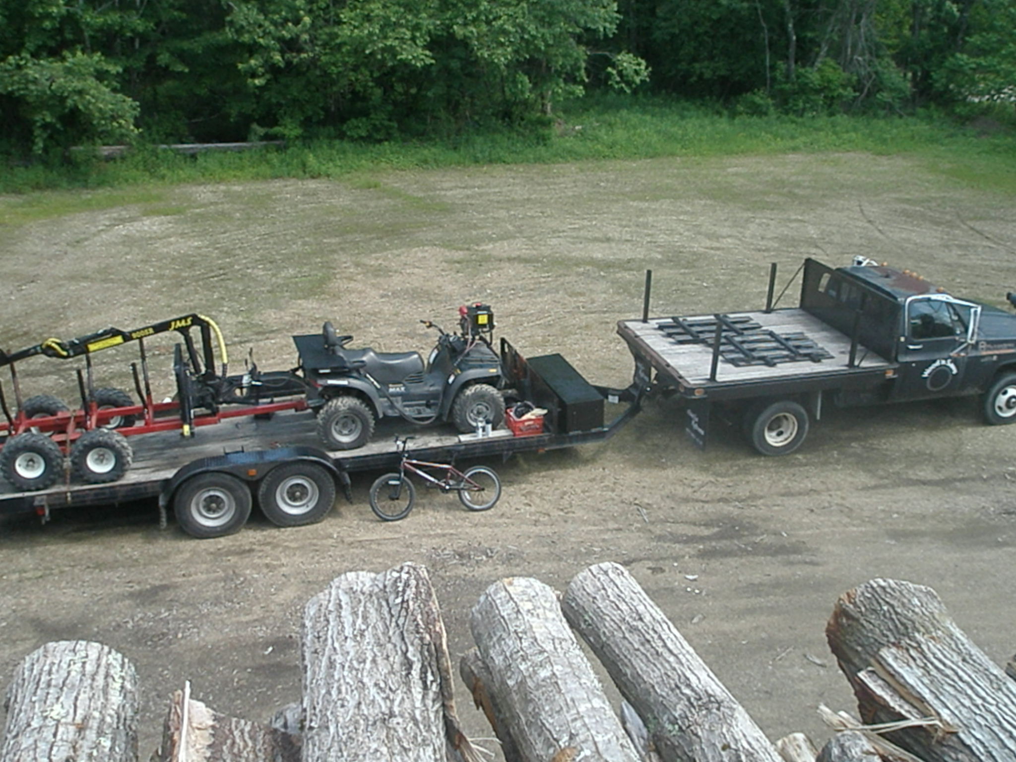

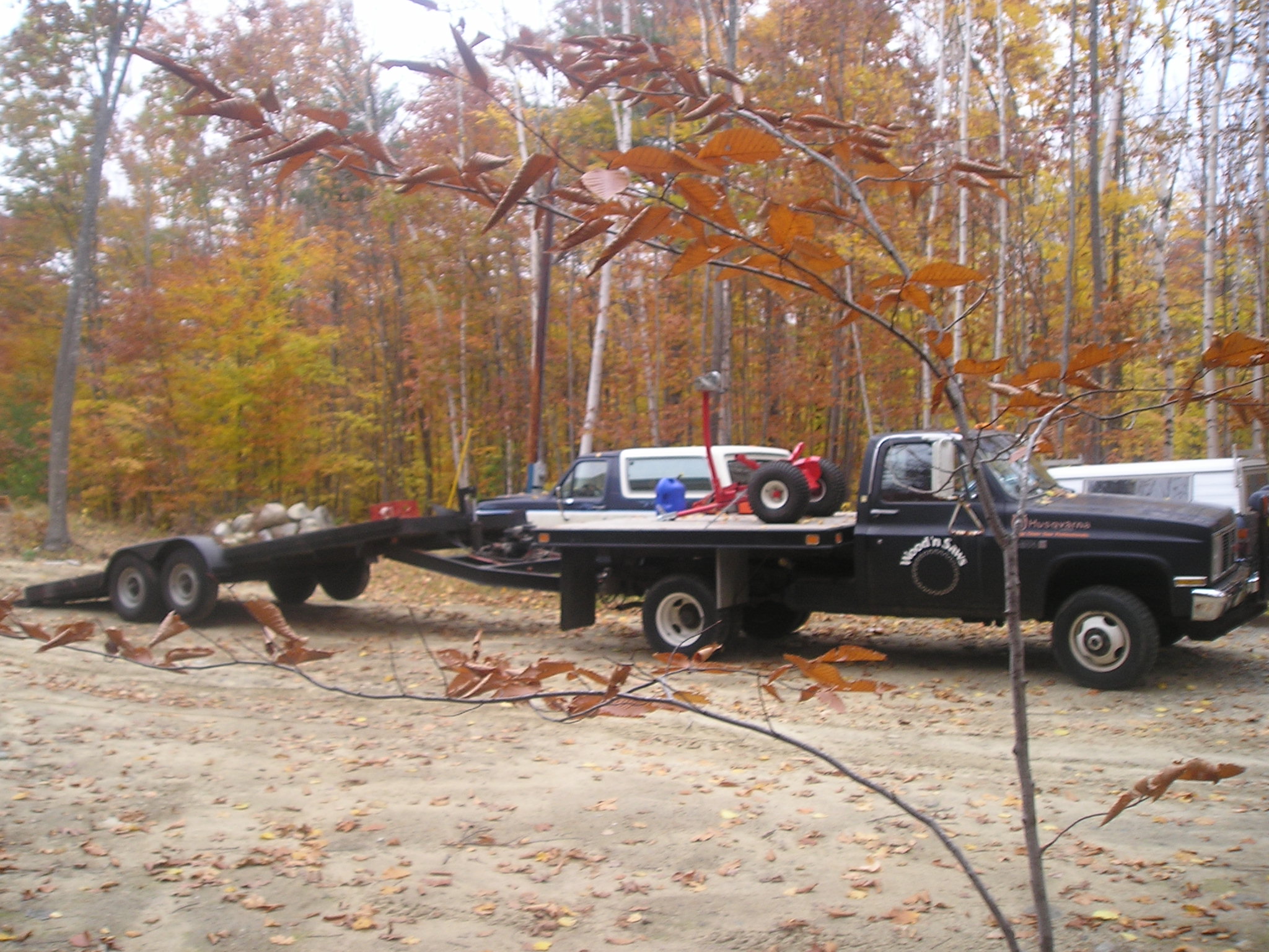

here's 2 pic's of my tilt car hauler it has 2- 6,000 lb axles.registered for 9,000 lbs.it will haul 3/4 ton pick-up real nice.car's are a pain,gotta climb out window.it's also got hydraulic winch to pull things up on the deck

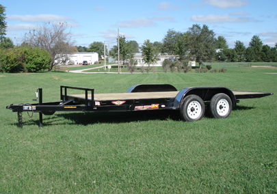

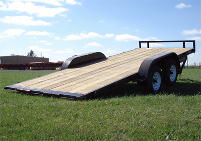

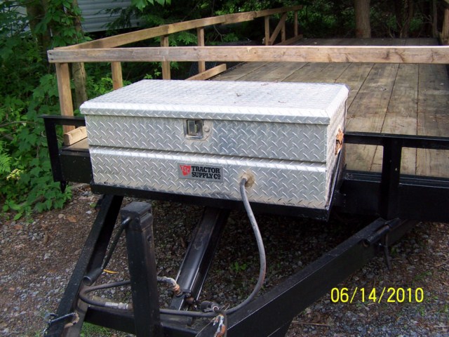

I have a tilt bed made by HHTrailer.com
8.5 x 20'. I bought the MX (manually jack to tilt) but shortly after converted it to 12V electric / hydraulic. The manual took too long to jack it up. Each pump only moved the cylinder about a 1/4" to 3/8". The elect / hyd. I added tilts up in about 10 sec. I bought new in late 2005 (its an 06).
Well satisfied with the trailer but not happy that I have to scrape and repaint every couple of years. That's not the trailer fault, its because I live in the snow belt of upstate NY and haul it in winter so it sees a lot of road salt. On mine the entire bed tilts.
Pics MX1 and MX4 are pics from the Mfg. website. The other is the box I added that contains my electric hydraulic unit and winch.
The gravity tilt trailer you mention uses a shock absorber type cylinder that allows it to tilt up or down slowly.

Hi Jack and welcome to the group. You may be able to use the existing cylinder, not sure though. I bought my cylinder from Northern tool. The 12V powerpack is a power up and gravity down unit which I bought with hoses from Graingers. My total cost for the pump, hoses, and cylinder was about $600. I did my own fab work and mounted everything including a winch inside a diamond plate box I bought from Tractor supply for about $160. The box is mounted to a 1/4" thick steel frame system I built from scrap steel and welded to the trailer. The factory power tilt option was about $1600 more so I saved over $800 doing it myself.
