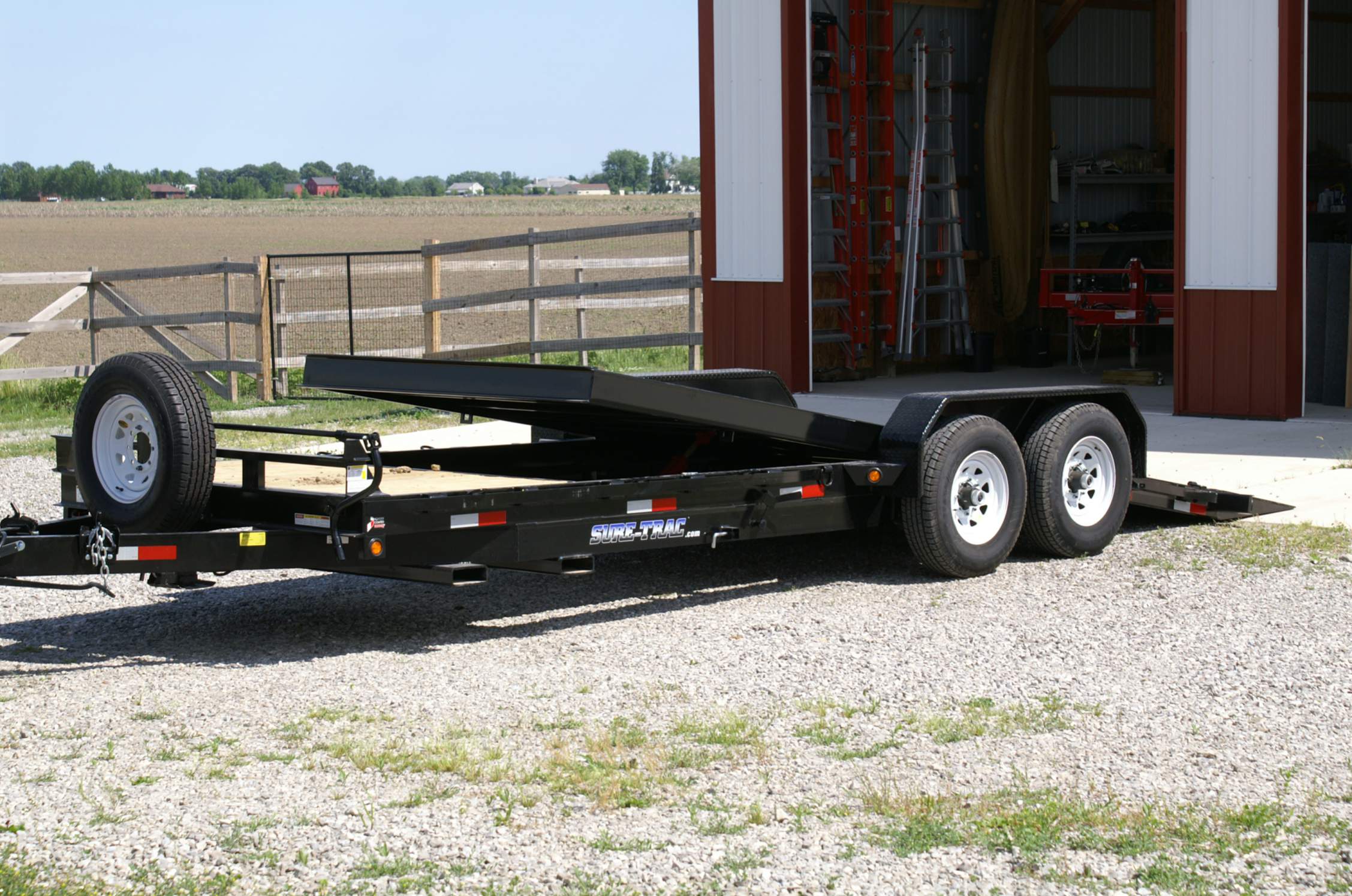

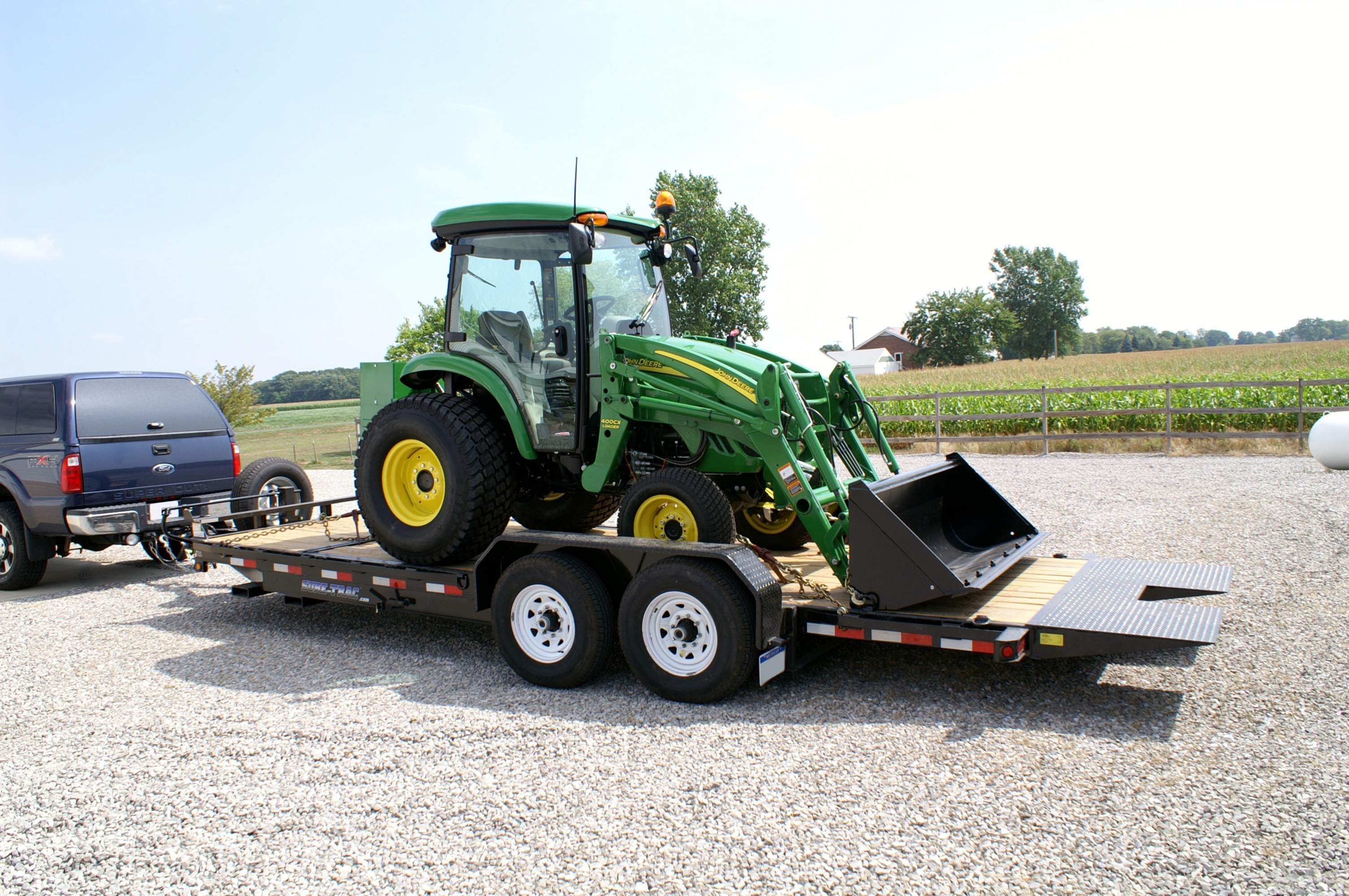

I like my Sure-Trac tilt deck, but it is all gravity and does limit you to one piece of equipment at a time. It has a fixed 4 ft front which is nice for implements and helps place the axles in the correct spot to balance the load, but you would be hard pressed to fit a very large piece of equipment up there. I know that they will custom build just about anything you want and should be able to do a power tilt in a non-deck over setup. As with most custom shops, they will build whatever you want, just bring money.
Sure Trac | Home
   / Tilt deck trailer? #10
That looks just like a Cam Superline trailer. The plate mount looks like it is going to get mangled where it is now.
