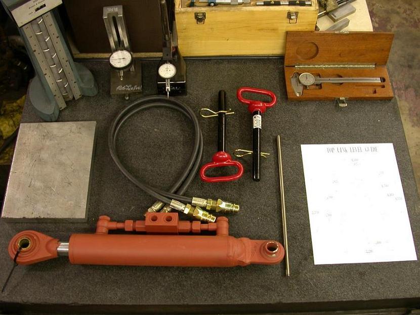

what kind of top link do you have I'am looking to put one on for tilting my carryall
/ TILTING BOX BLADE #9
</font><font color="blue" class="small">( what kind of top link do you have I'am looking to put one on for tilting my carryall)</font>
I got this one from CCM. See picture...and THIS is the link to it.
Hope that helps.
