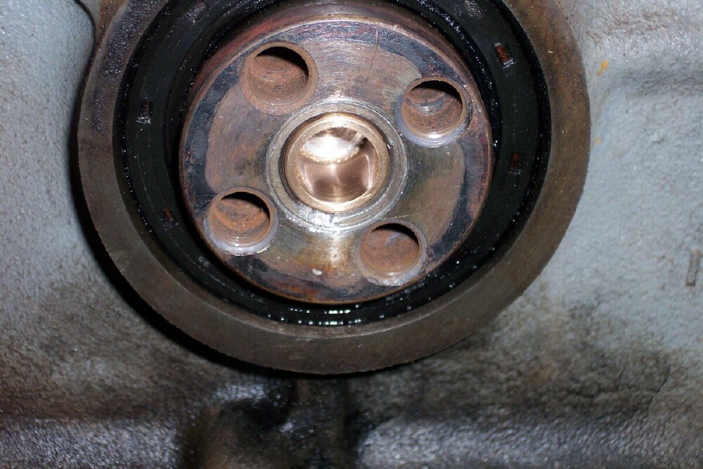

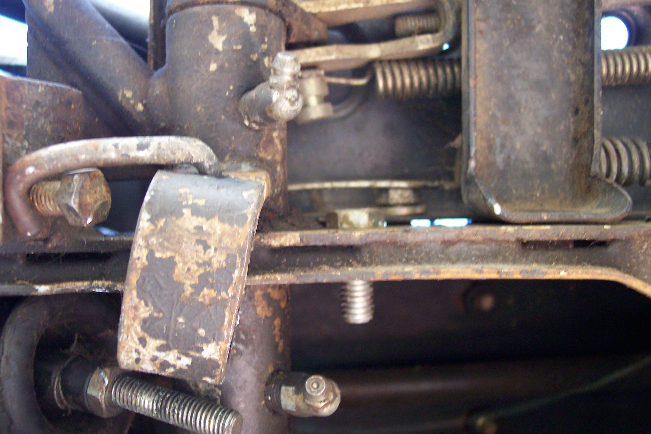

Did you try to adjust the clutch linkage? My tx1300 had the clutch
pedal twist where the clutch rod connected. this twist was enough
to affect the clutch disengagement. here is a picture of the pedal
from underneath the tractor showing the twist.
Also a picture of pilot bushing.
