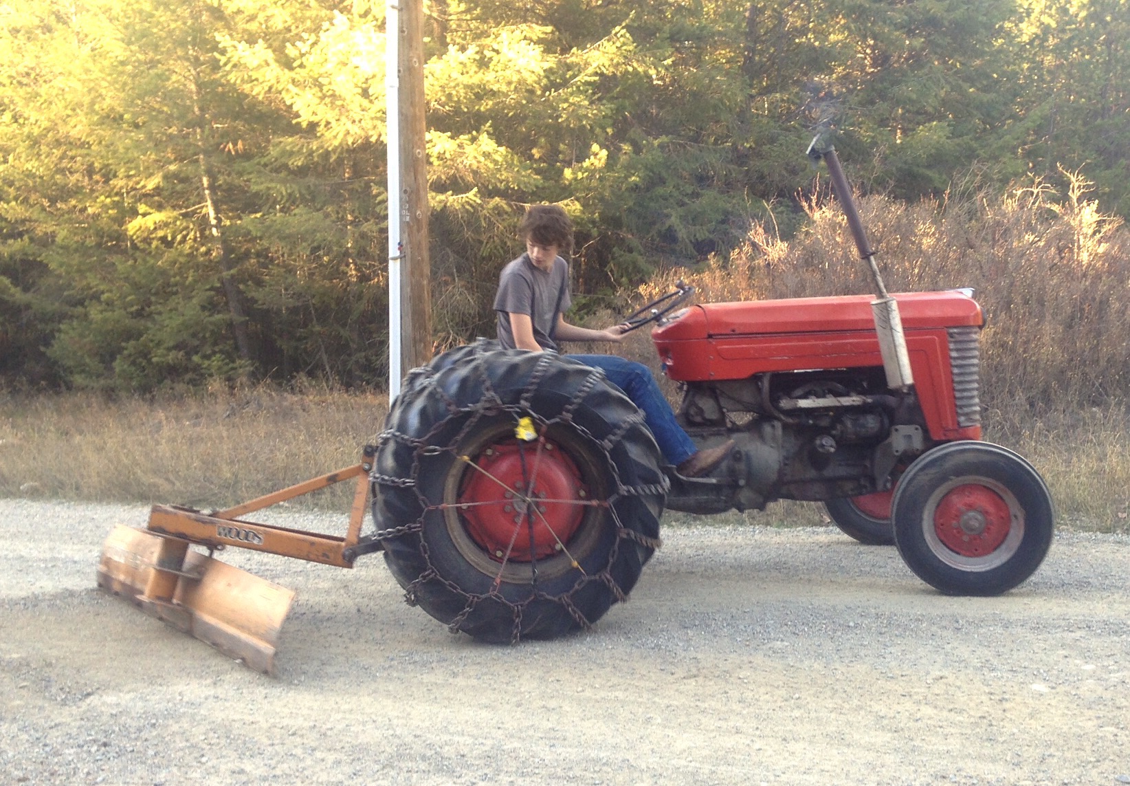

See the part that states "Woods" on the side, try to get this horizontal when pulling snow. The blade will scrape better that way. I have this exact same blade ( for 28 years) but needed something I could off set to get close to buildings. I cut it up and made it into a "slider" type blade.
Yep, I overlooked that one.
To further the information, the reason you want that level is so when you go from angle to straight, or angle the other way, the blade stays level. It has to do with the "plane" that the blade rotates around. With it downhill like showed in the picture, the side of the blade going toward the tractor is headed "downhill" while the side going away is headed "uphill". You can correct that and level things with sidelink tilt adjustments, but when you want to angle the other direction it will be way off again.
Same goes for truck plows. A-frame has to be level otherwise it wont scrape clean on one side of the blade when angled
