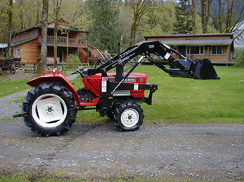

New to this forum, and I'm lookng at a reconditioned YM2310D (4x4 version) in WA State today. Would appreciate any tips you can share regarding issues to examine carefully. I'm an owner of a larger farm tractor (1956 International Harvester 300 Utility) so I can glean through most issues, but just wondering if anything unusual should be looked at more carefully. thank you.

If you search this forum for "reconditioned" you will find a lot of opinions on reconditioning. Find out just what is ment by reconditioned in this case. Sometimes it just means paint. There are stories about vietnam recons being put to gether from parts from several tractors. I have no personal knowelege of this. I have a used not recon yM2020 and I am very Happy with it. The 2310 is a powershift tractor which means it has a shift on the go trans infrount of a multi speed manual trans. Shifts should be solid and immediate. No slippage on powershift. Drain a little fluid from each of the front drive wheels, and the trans. (These tractors were run in a flooded rice patty). Check front drive fluid level and look at pivot point on the front axle. There should be 0 play at this point. Put something heavy like a bushhog on the tractor raise it and see it it stays up or leaks down. Of course you are the judge of the warranty.
   / tips for evaluating a reconditioned YM2310D? #3
</font><font color="blue" class="small">( ...just wondering if anything unusual should be looked at more carefully. )</font>
Sounds like you know what to look for mostly but as Norm said these were mostly sold for rice paddy use so check the front axle.
This promotional photo was on a Yanmar International corporate website. Apparently Yanmar considers running half-submerged in a rice paddy as normal so they are pretty well sealed. But occasionally posters here have found nothing but dried mud in the front differential of their "new, reconditioned" tractor.
Aside from that it should all be normal stuff to check.
