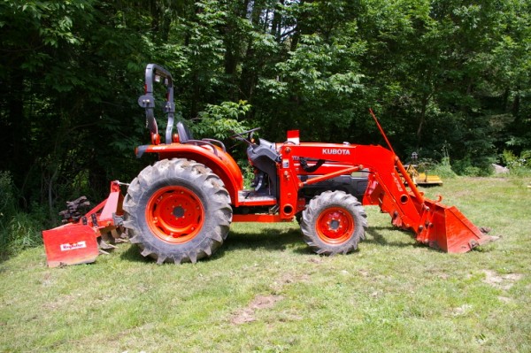

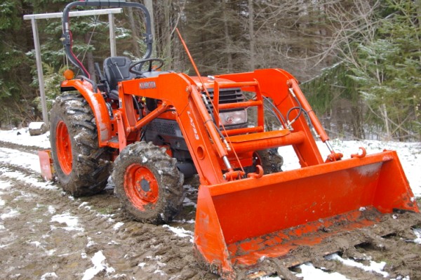

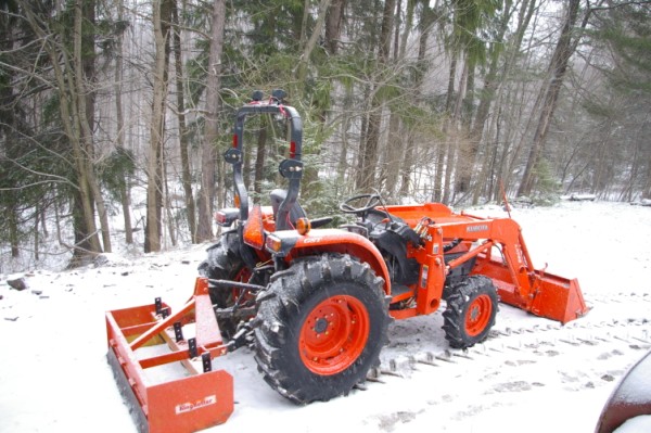

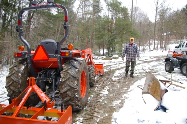

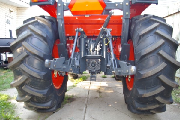

I have a 3130 and have ags off a 3830 which are the larger size you mentioned. The clearance for the rear is a little tight and had to move them out 1 setting. They work great. Great traction in mud and snow and actually a little better floatation on turf becauce of the wider rib riding on the ground.
