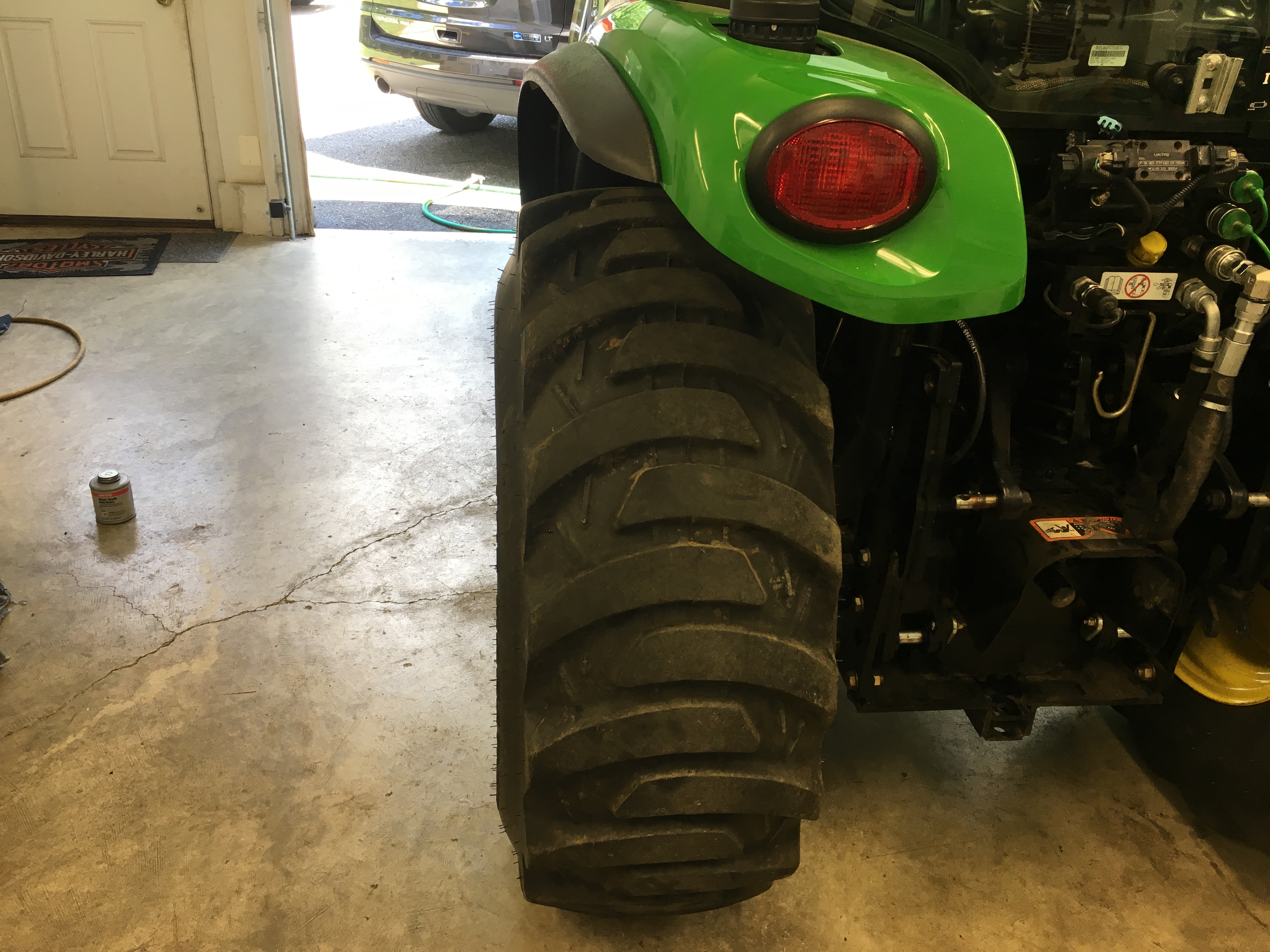

Anyone had any luck fitting a set of rear chains on a 3R series? I have a 3039R with turf's and the dealer sold me a set of OFA Easyon 5 chains stating those would fit fine. They don't fit. The chains make contact with the fender where it's mounted. There's very little fender clearance on the 3R series to begin with. Dealer didn't have any other options and I'm thinking chains are not going to work on this tractor.

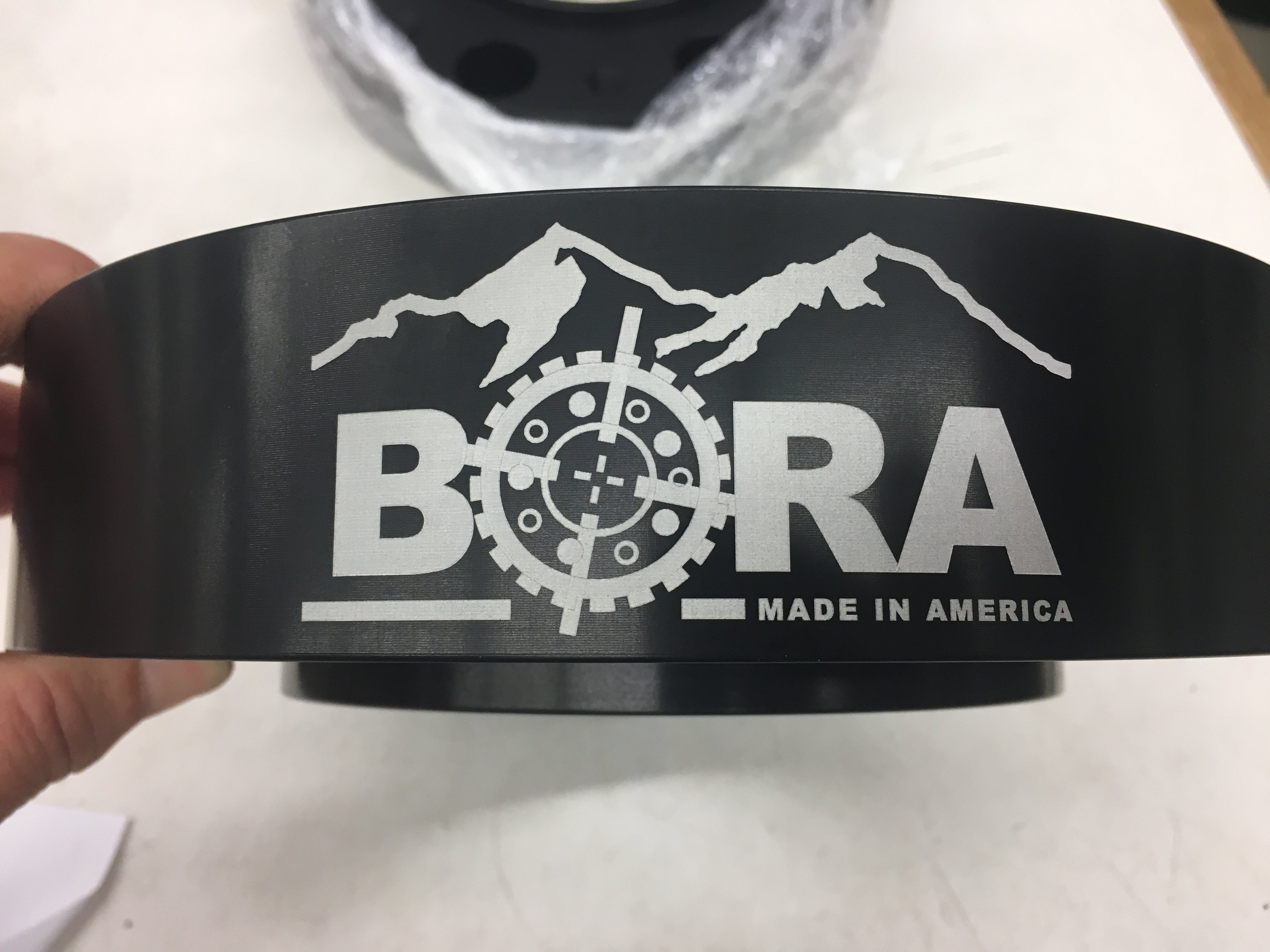

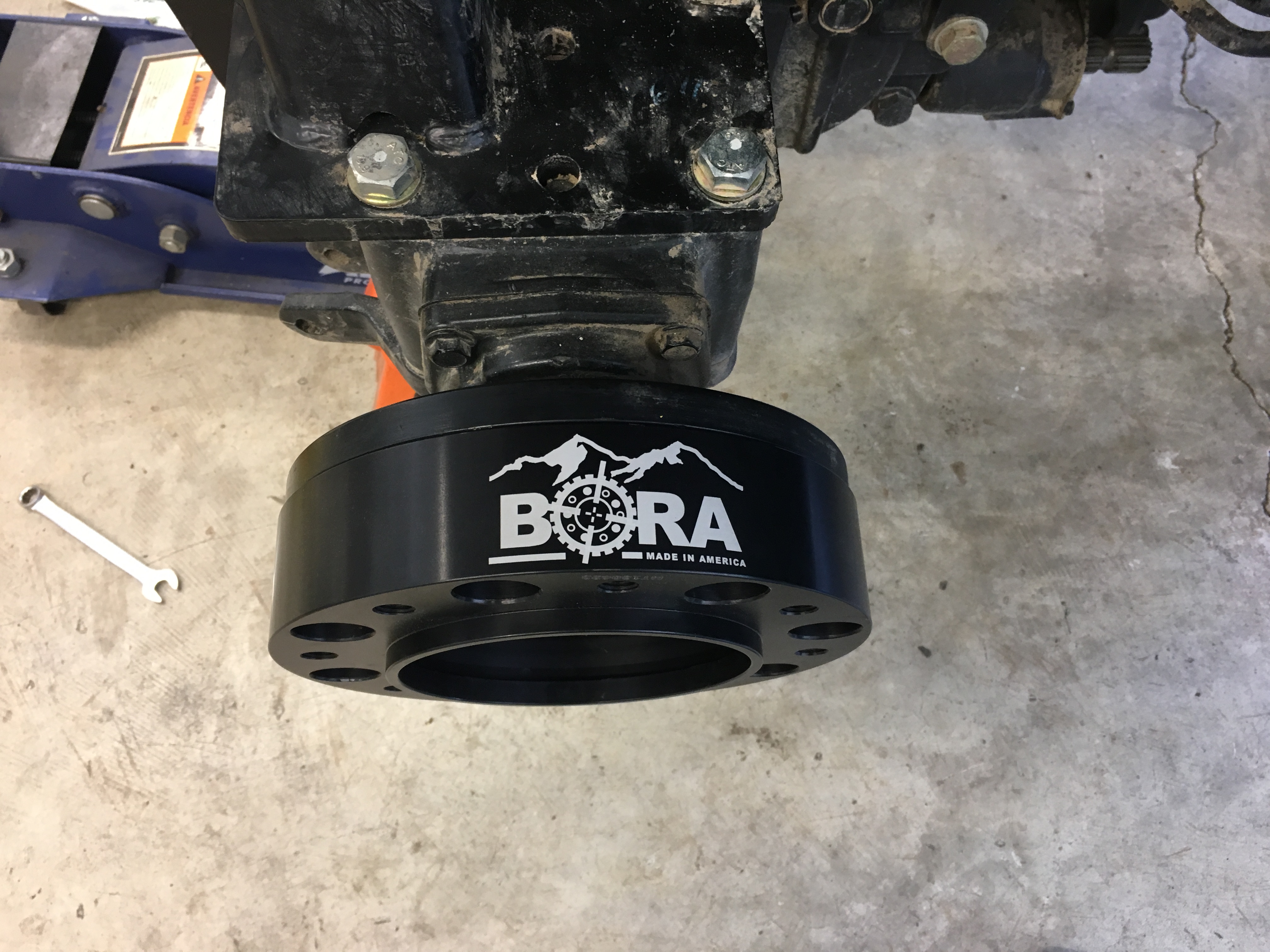

Yup, close fit, most guys including myself end up running running at least 2” spacers to fit them, I got mine from Motorsport Tech/BORA.
   / tire chain clearance 3R series
Thanks! Did the 2" spacers provide enough clearance or did you end up going with a wider spacer?
   / tire chain clearance 3R series #4
I used the 2" aluminum on my 3720, sorry I wasn't clear on that-was in a hurry when I replied:
Wheel Adapters, Wheel Spacers, Hub Rings for your car! | Motorsport Tech
Thanks Kennyd. I looked them up and just ordered a set. They can not come soon enough. We just got two early snow storms and getting up my driveway is a bit tough without chains.
