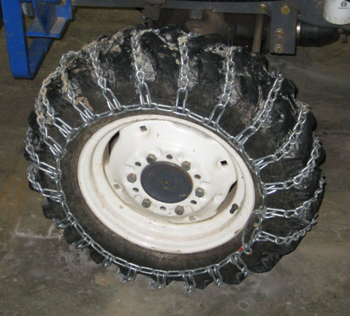

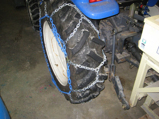

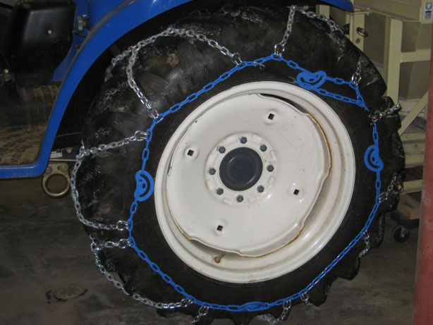

I bought a set of tire chains from Costco online. See here. With shipping and tax they were less than $130. They fit my 11.2 x 24 rear tires quite well and are actually a little longer than required. They are made for heavy trucks like semis and such and I got the largest size. The cross chains are square 5.5-mm manganese alloy. Cam tensioners are included. Overall I'm pleased with the quality and you can't beat the price.
I tried them out in a recent snow and they work pretty well. There are some problems with the chains falling in the lugs but they definitely help with traction and stability. I run 2-link ladders on the front too. I run my chains pretty loose without tensioners and apply the rule of being able to get a fist between the side chains and tire. I think this is by far the best way to go with low-speed tractor chains on ag tires. All the banjo-string-tight tensioning that people do is pretty silly IMHO.
Anyway, I thought I'd share my tire chain solution for less than half the cost of most anything I've seen.

I run double rings and keep them as tight as possible. There's not a lot of clearance between the tire and the fender.
   / Tire chains from Costco for less than $130 #3
Yup I'm one of those chains snug as possible types also. Just don't like things loose and sloppy, not sure if the traction is any better or worse but it's not hard to do and some of these modern machines have sensitive components not far from the minimal clearance inside/near those fenders.
Anyway that's a good deal for the chains at Costco, just not sure about those rears with the link parallel to the rotation? I know any chain is gonna be a big help but that doesn't seem like the max traction. Maybe that makes for a smoother ride?
I have 2 links on the fronts and 4 links on the rear, 4's on the rear are way to bumpy, I've got to splice in more cross links to smooth it out, I think I have enough surplus chain around to do it.
