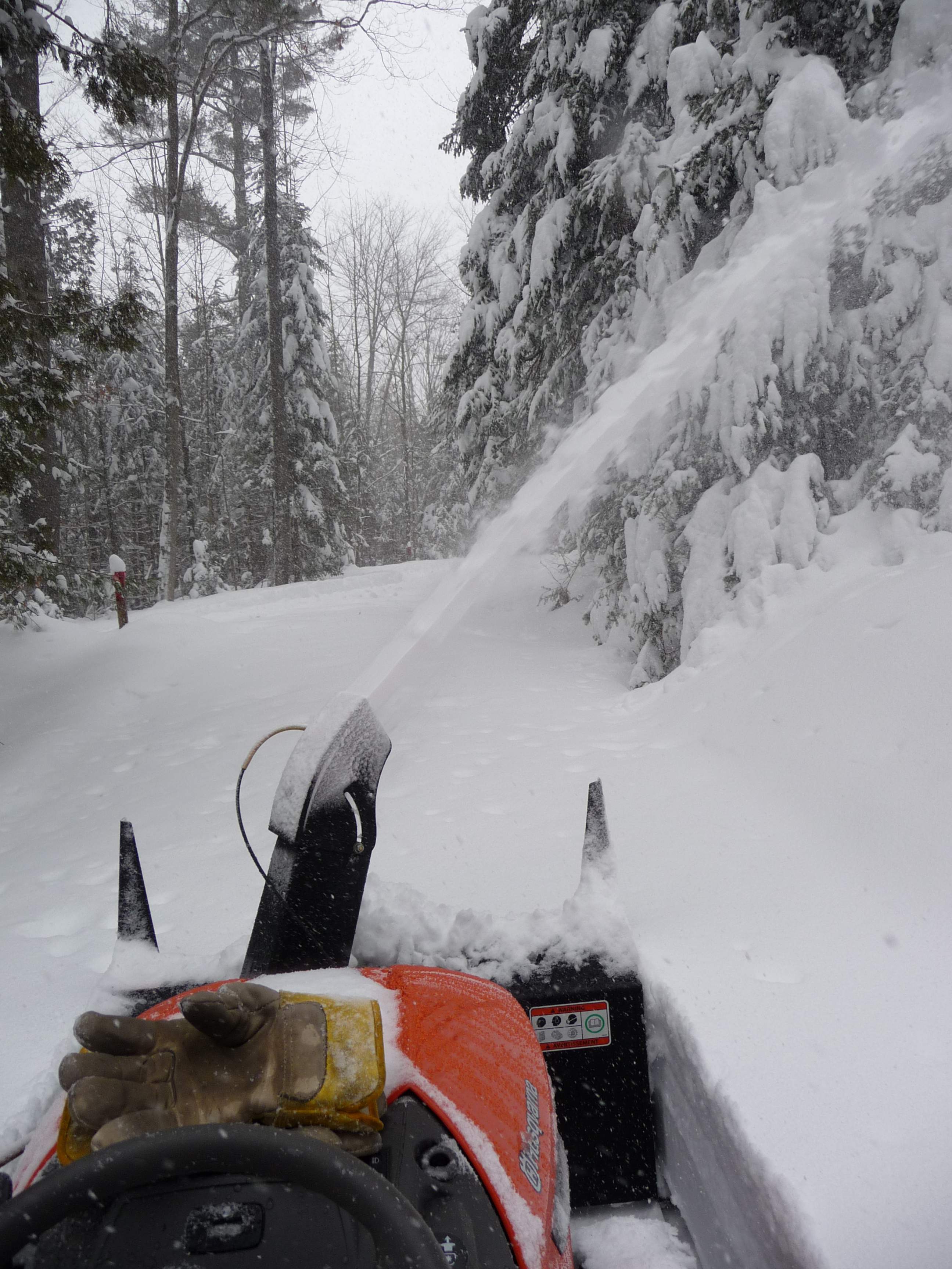

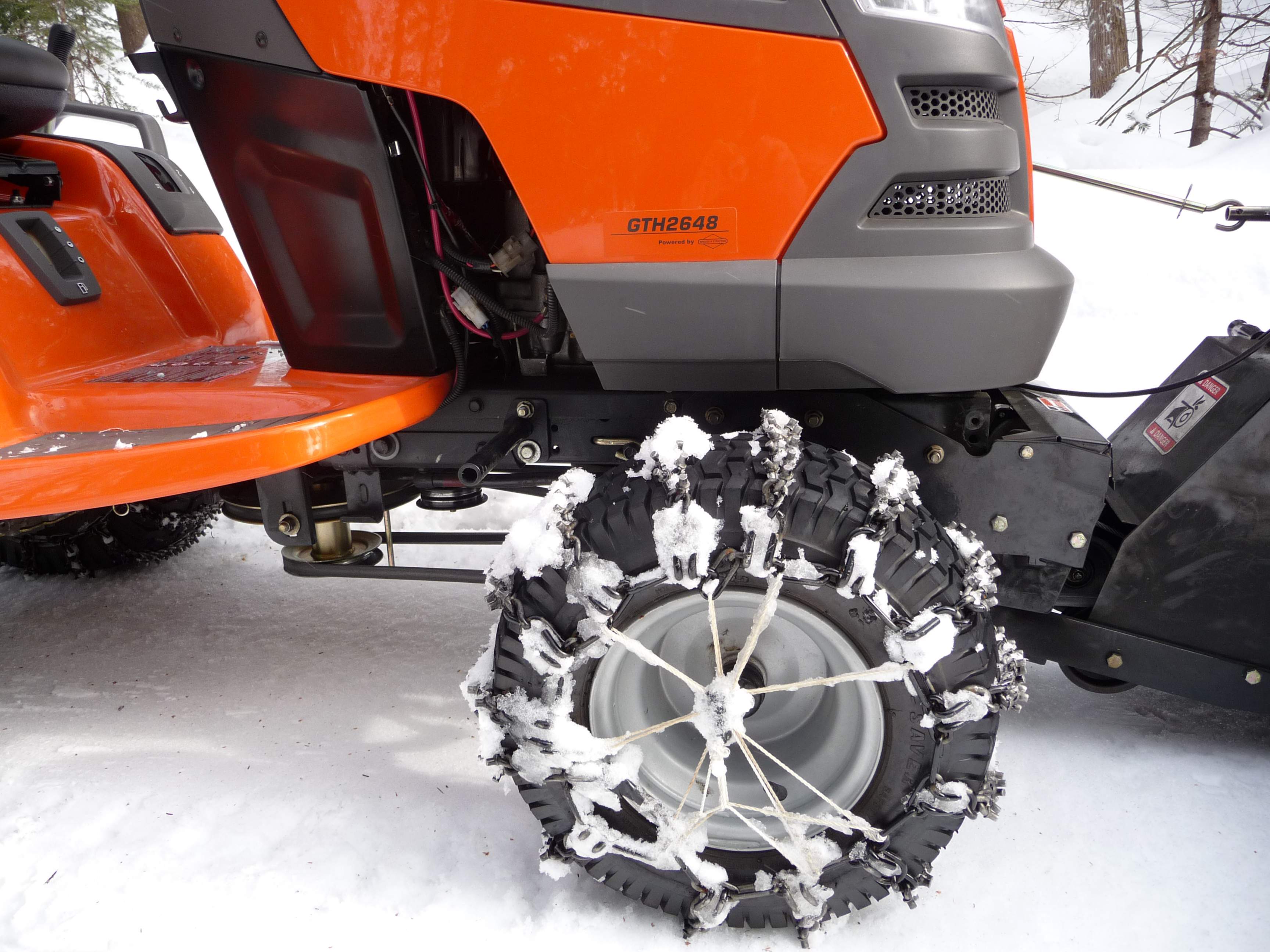

I know your feeling. I had the same problem with my previous tractor. One of the salesmen could not understand the need for front chain. When there is heavy snow, the tractor just want to keep going into a strait line. With the added studded chain, the front snow blower became a pure bliss. Almost a 4X4! The solution came from a guy who makes custom chain for ATV. I am sure the same type of product is available in USA! Better try an ATV dealer ship for your tire size.
Good Luck, you will love your JD with front chain!

Post your front and rear tire sizes.
Correct size tire chains will almost certainly be available on eBay.

I have noticed that (Temporarily blocked due to reports of company closure) lists tire chain modification tools on their site. I used truck tire chains from NAPA and cut them with cold chisel to fit length. I think front chains are more beneficial on ice/snow pack than are rear.

I have to disagree with you here. The rear wheels have more weight on them so drive chain studs deeper into the ice. Also the rears are by design the main driver of the tractor and are built much heavier then the fronts which have to be flexible enough to provide steering. They also have a much larger tire to ground contact patch so have many more studs in the ice at any one time. The fronts when in 4WD are helping the rears pull the tractor forward a bit and can pull the nose in the direction you want to go built are not the main driver of the machine. Chain your rears first then add front chains if you find you need them but don't chain just the fronts.
Just my. :2cents:
