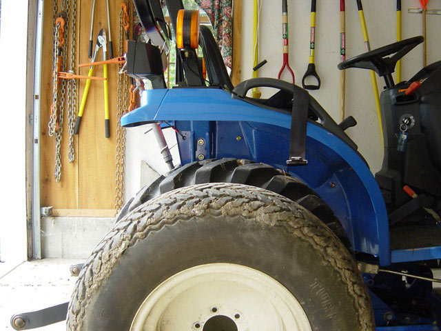

Some of you might remember, I've got both types of tires on my TC18. A while back I asked how to change the loaded tires. Thanks to the expertise here, I was able to do it safely & easily. Some pix are attached (man I love my new camera).

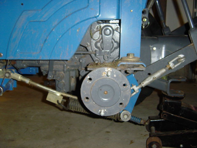

Front "jacked" up

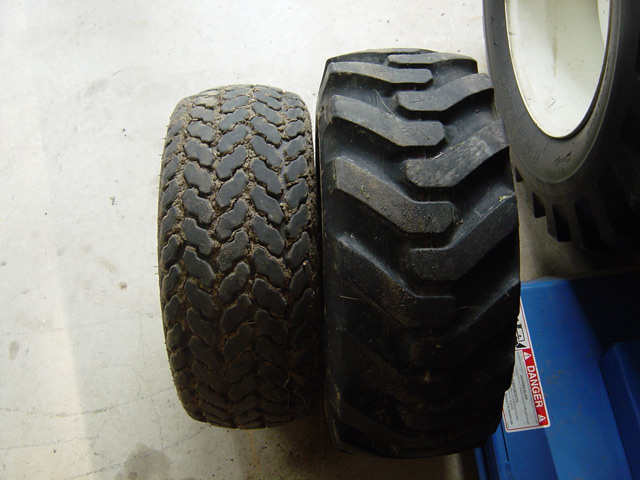

Front tire comparison - side view

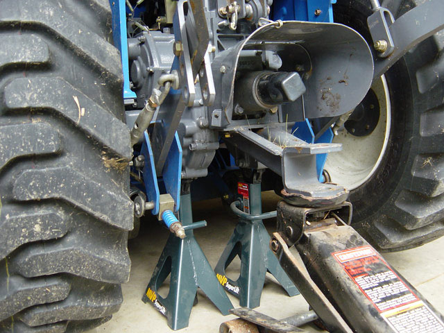

Rear jacked up

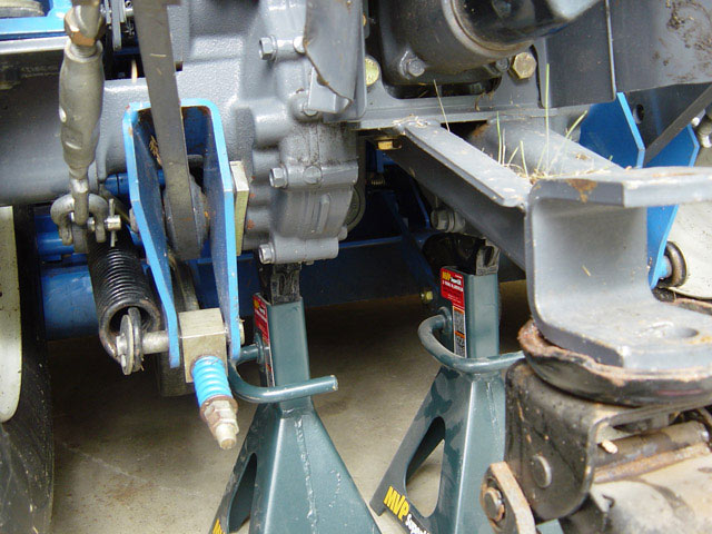

Close up of jackstands

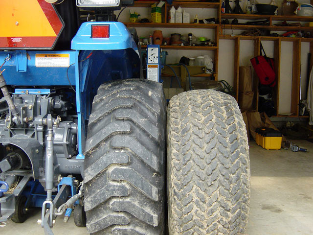

Rear comparison rear view

#9
Studs make it easy to align tire.

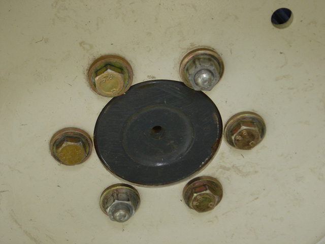

rear all bolted up
