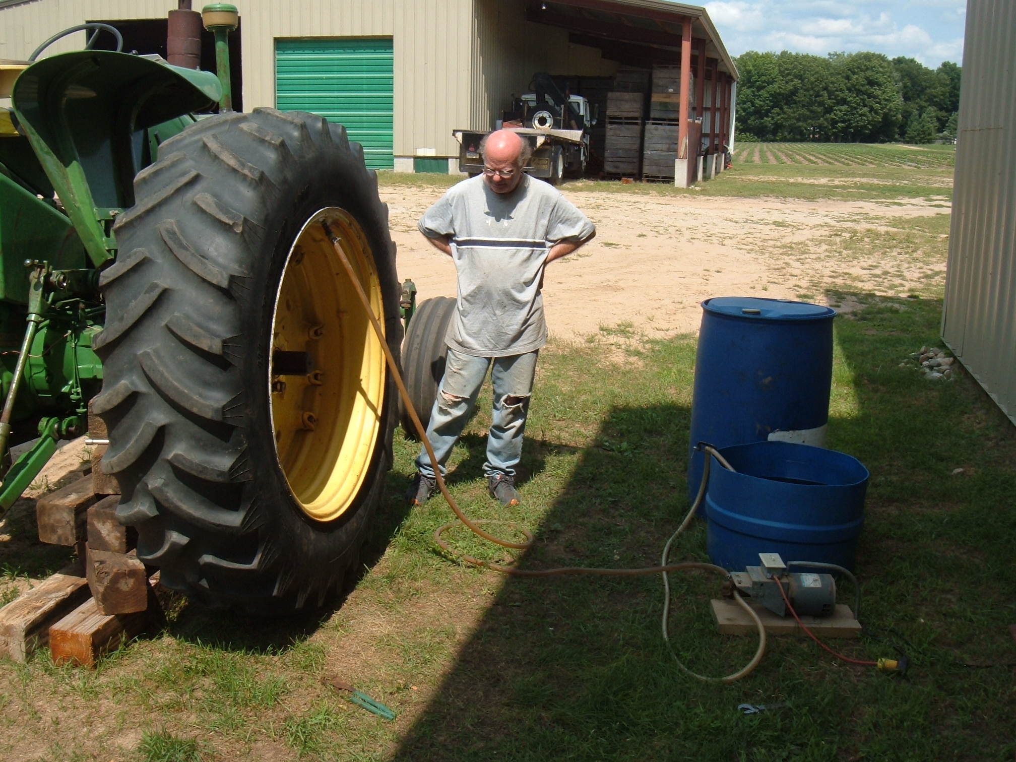

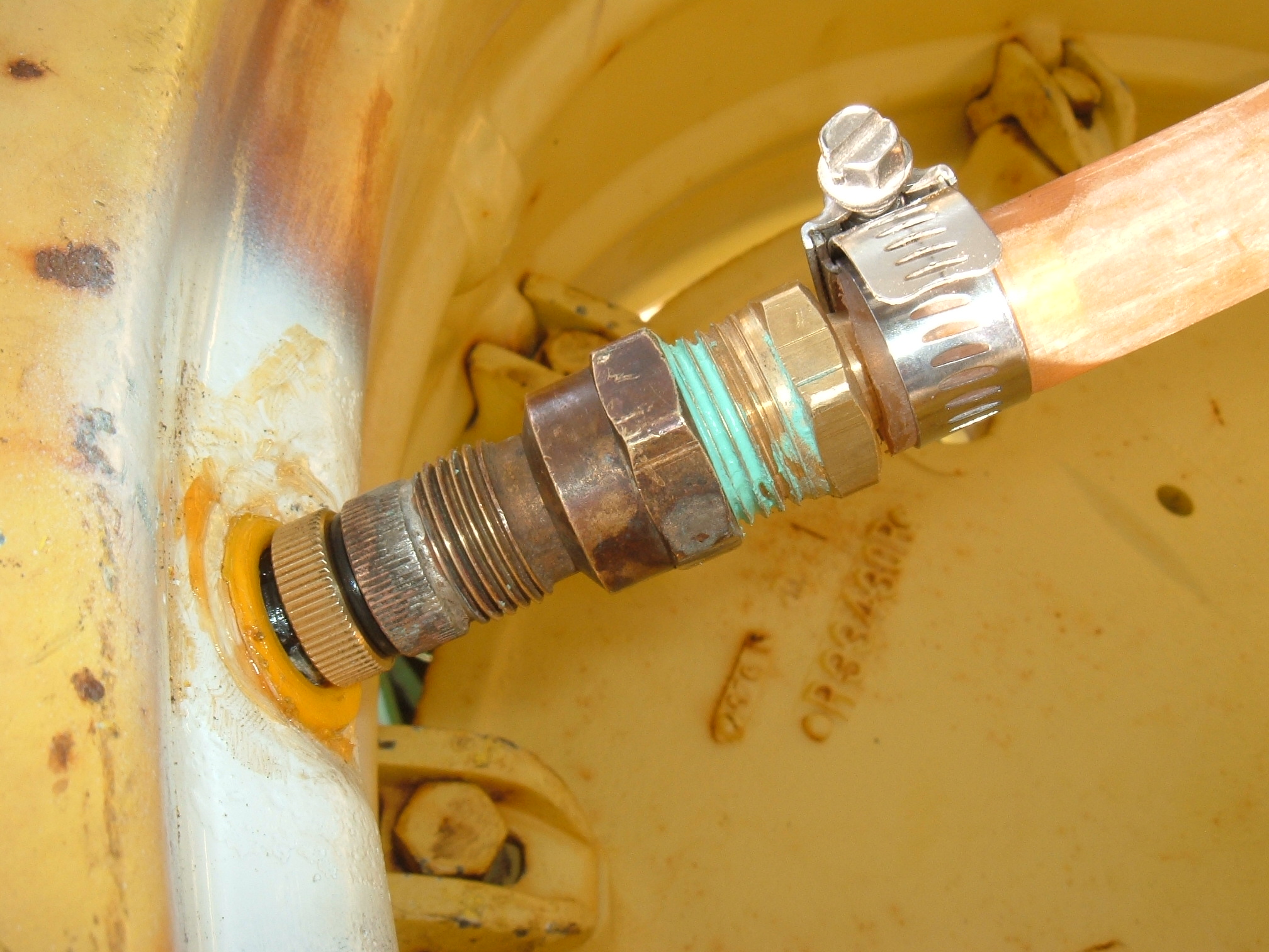

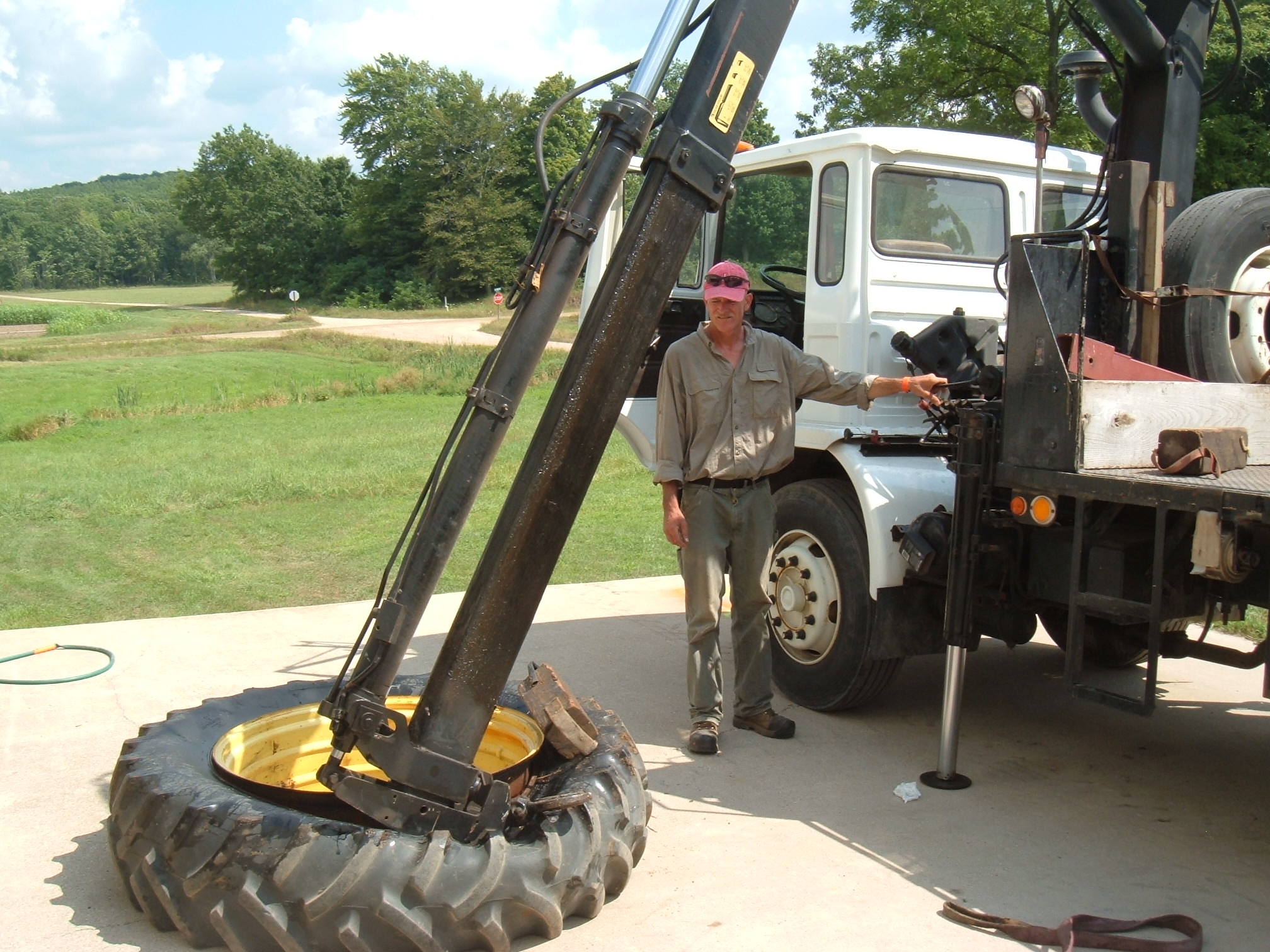

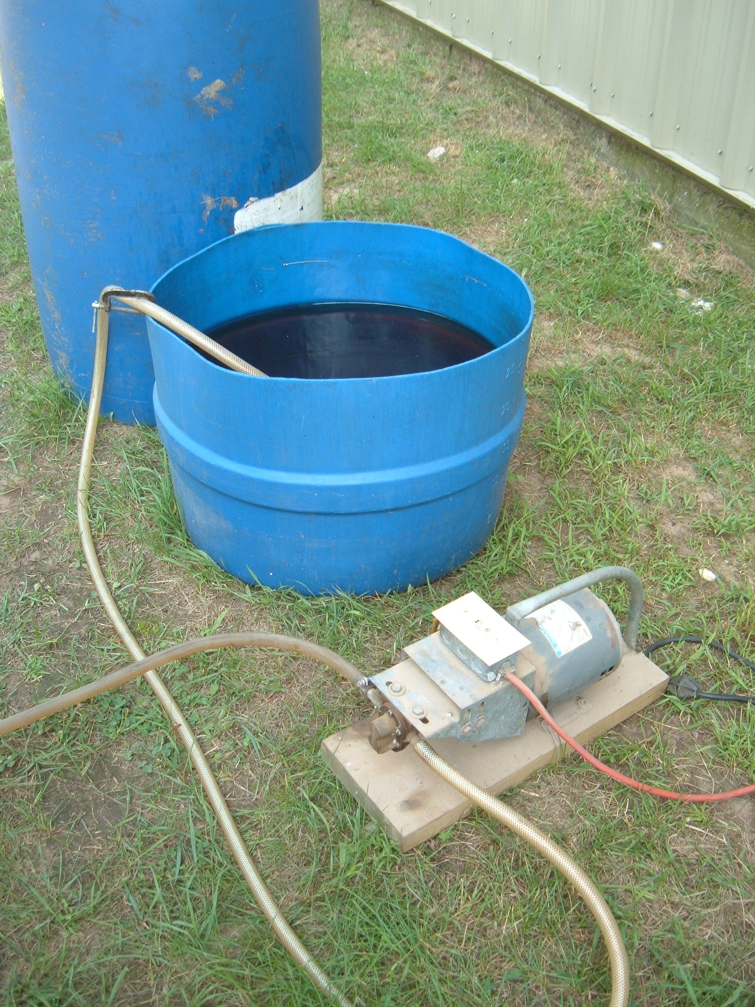

Finally got the stuff together to roll my own. I can clean and repair so much better than the tire guy. My Bud Lar soldered up an adapter from old valve stem parts and I actually had the pump, never really occurred to me to do tires. I should have done this a long time ago.
What is being pump back in the tire? I had calcium put in my tube so it wont rust the rim, my first set that came with the tractor had sticky beet juice in it, wont cause rust.
The trouble with the some tire guy's is they don't know the difference between trailer truck's tire's and tractor tire's psi. air pressure. When the tire company replaced my tractor tire's last year, a 11.2-24 tire calls for 18lbs psi.+or-, the tire guy put in 45lbs. maybe he was going by pis. instead of psi. I was an hour draining calcium and air back out, messy. Next time, if there is a next time, I'll take day off from work and go out there with my son, stand there watching making sure I have 18lbs psi, not pis.
