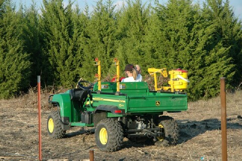

I don't know what kind of tires I have on mine. Let me post a pic and maybe you guys can tell me.
Thanks,
D.

I have the same tires you have. I use them on my lawn. We just received a ton of rain and the ground was really soft. I was driving all over my property with them and I did not leave a mark. So far I have really liked the tire.
I would like to go to a Maxxis Bighorn though. Does anyone know if I can get 12" rims for the Gator? Can I go with a 25 or 26" tire? If so what will that do to my low end?

These tires work really well - I am not sure if they are the more aggreesive ones or not.
D.

Those are the more agressive ones. They would be perfect for plowing and for soft ground. I dont thing there would be a problem The ones that more like turf tires wouldbe better for grass but they will not be as good at all for mud and plowing.

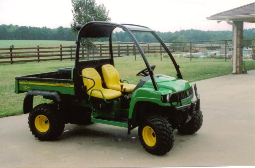

Those are the HPAT tires. They've worked really well for me.
