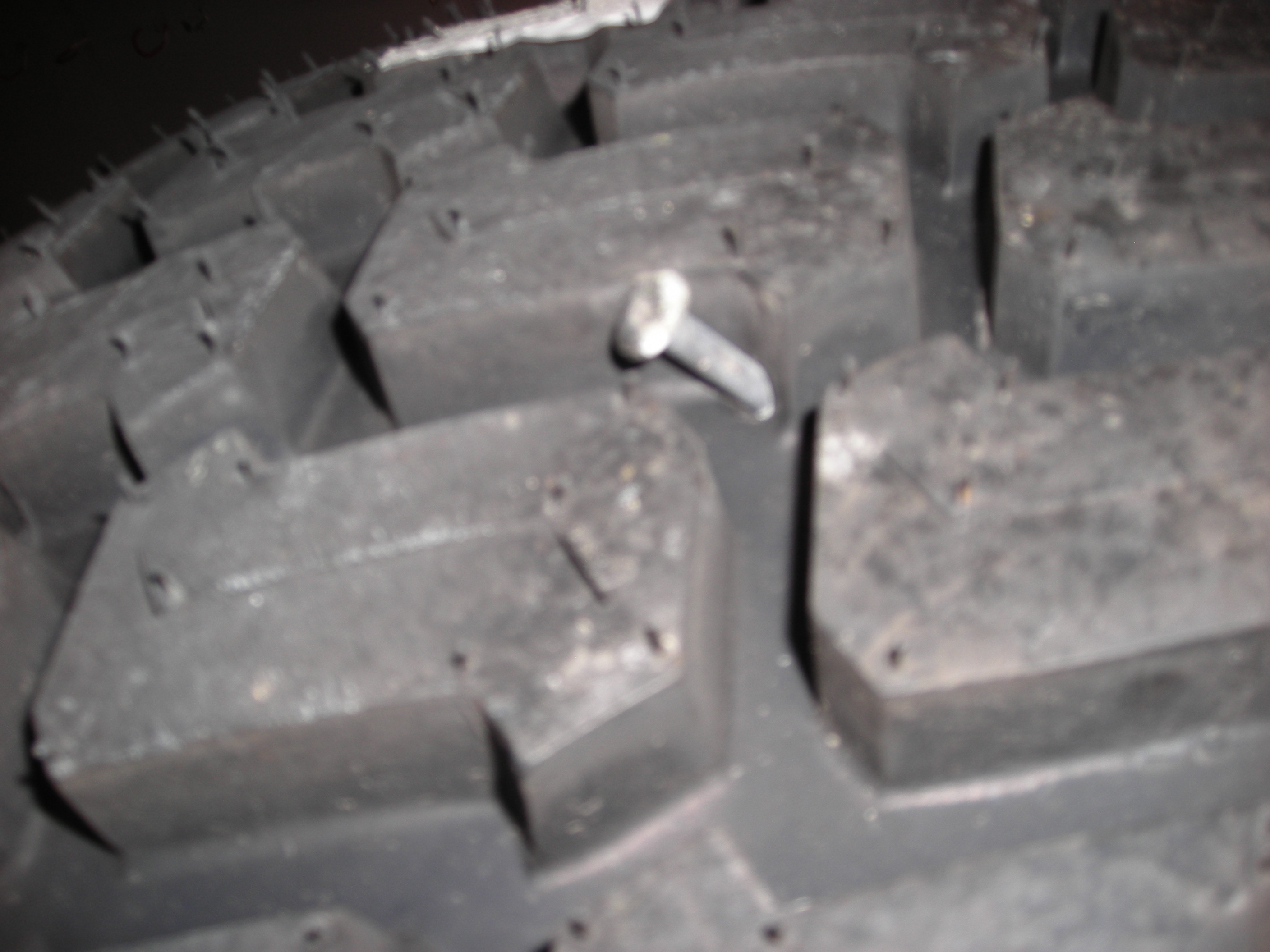

I was driving my brand new tractor home from the dealership, owned it less than 15 minutes, and had this 1/4" button head screw go thru my rear tire. I nearly cried. You can still see the manufacturers sticker on the tire! I performed an external plug job, 3 years later, no issues. Philip.
/ Tire Repair - Inside patch or Slime? #11
Sheet metal screw with rtv on it. Nip the head off when it's cured.
