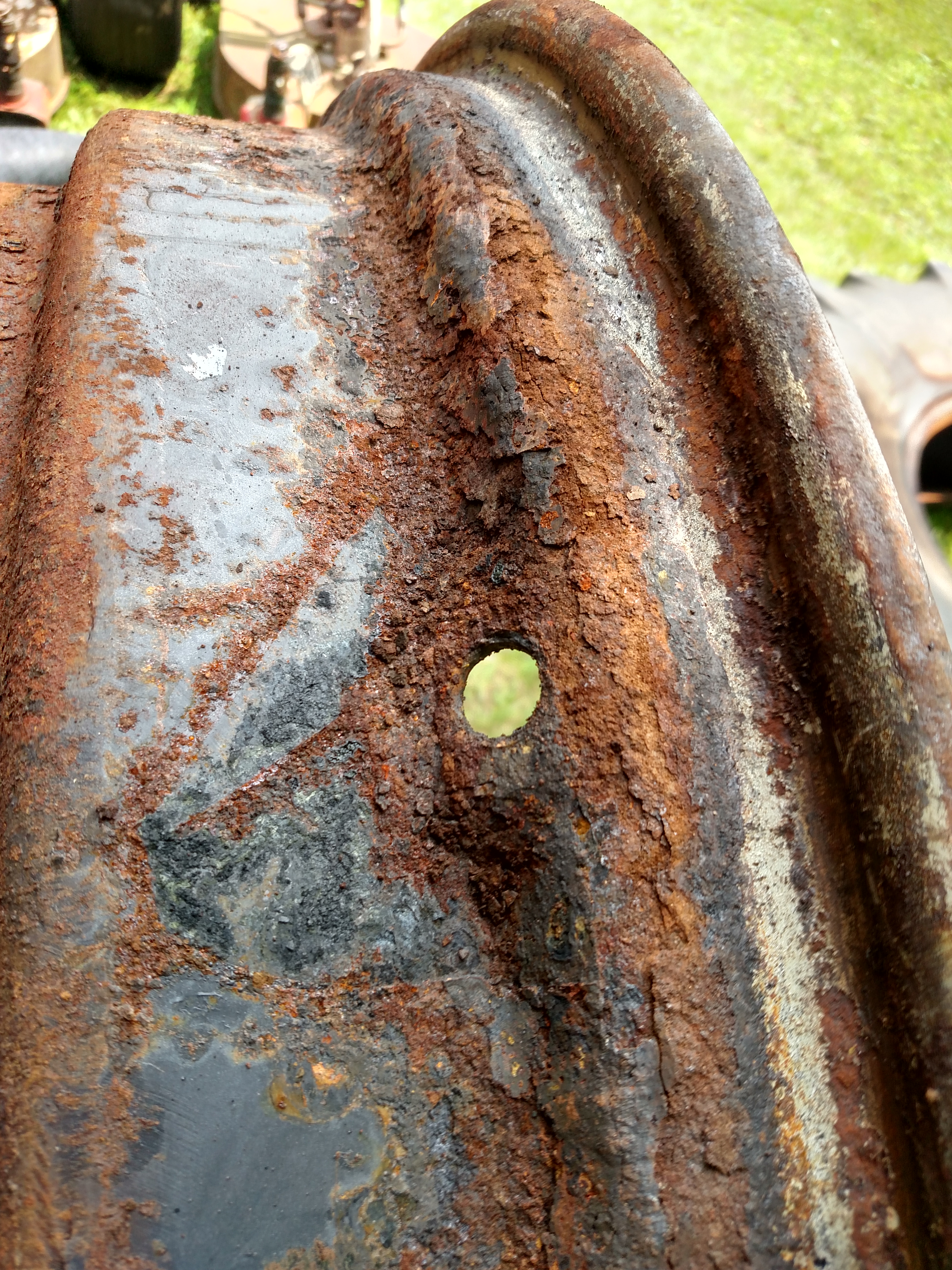

Fluid filled tires on a John Deere 950. My metal stem is leaking and loose. Looking at options.
Ch3 stem is what I知 holding with my broken thumb. I can稚 find another part number what is the larger part?
Ive never used metal stems. That larger knurled nut at the base moves when I wiggle the stem and leaks air, and the stem itself also won稚 close the valve so it leaks with the cap off.
With that much rust what are my options? Is this tire tubed? Can I replace the base the core screws in? Use some kind of cement or epoxy on the base?

If you are wiggling the large knurled nut next to the rim and you are leaking from below that your actual valve stem is leaking.
That to me looks like a tubed tire and the tube is actually leaking, maybe right at the base of the valve stem.
That knurled nut should have been snug to the wheel and securing the valve stem.
If your tire is still mostly filled you will likely want to find a tire shop to do a service call.
It will not be cheap, they will need to pump the fill out into a barrel, break down the tire, pull and repair or replace the tube, clean and dry the wheel and tube, remount the tire, install the tube, refill the liquid and possibly add more.

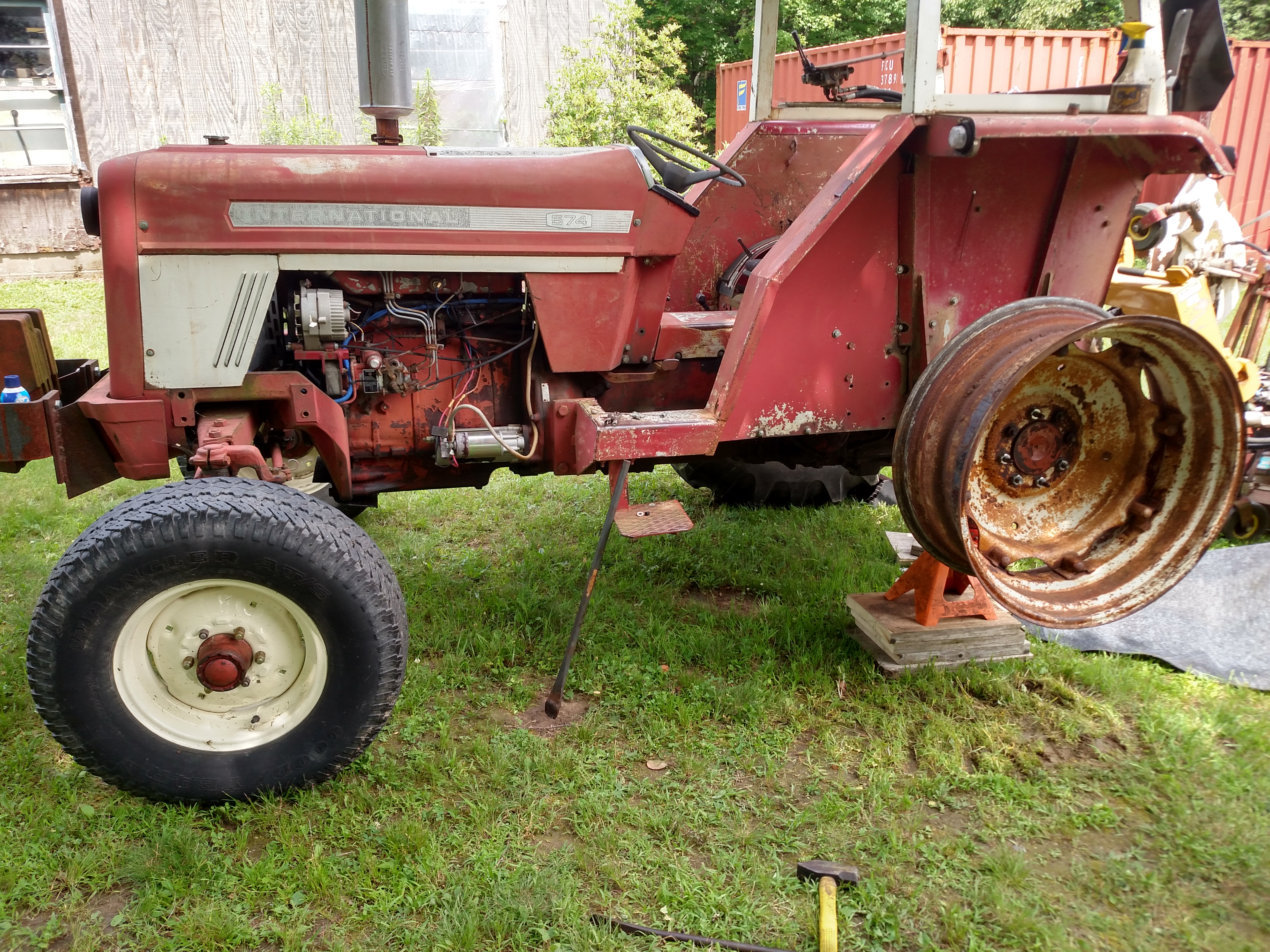

You can also do it yourself, it will only take a day or 2 or 3 depending on what all it needs and a few special tools.
View attachment rim 1.jpg View attachment rim 2.jpgView attachment rim 3.jpg View attachment rim 4.jpg View attachment rim 5.jpg View attachment rim 6.jpg

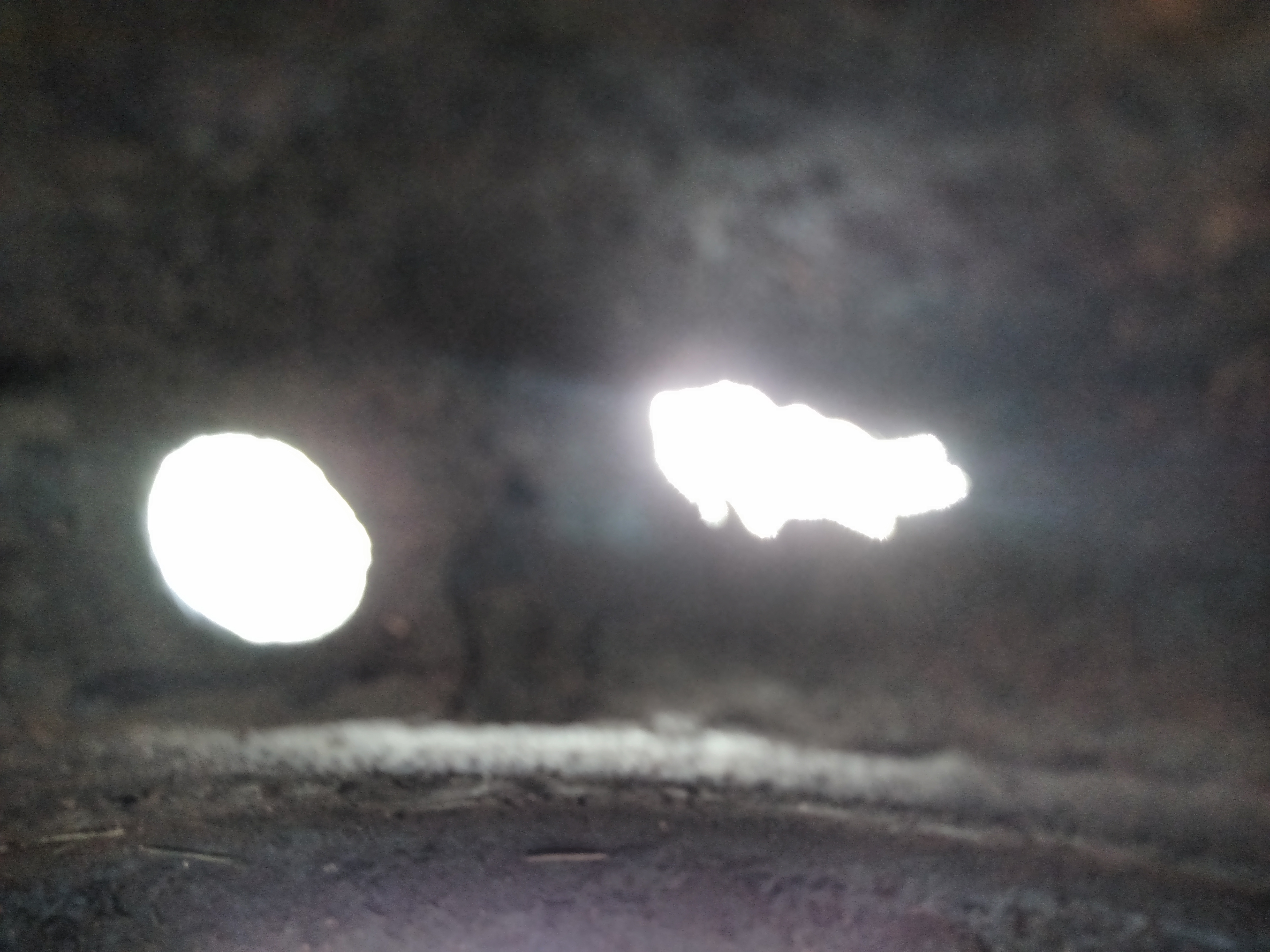

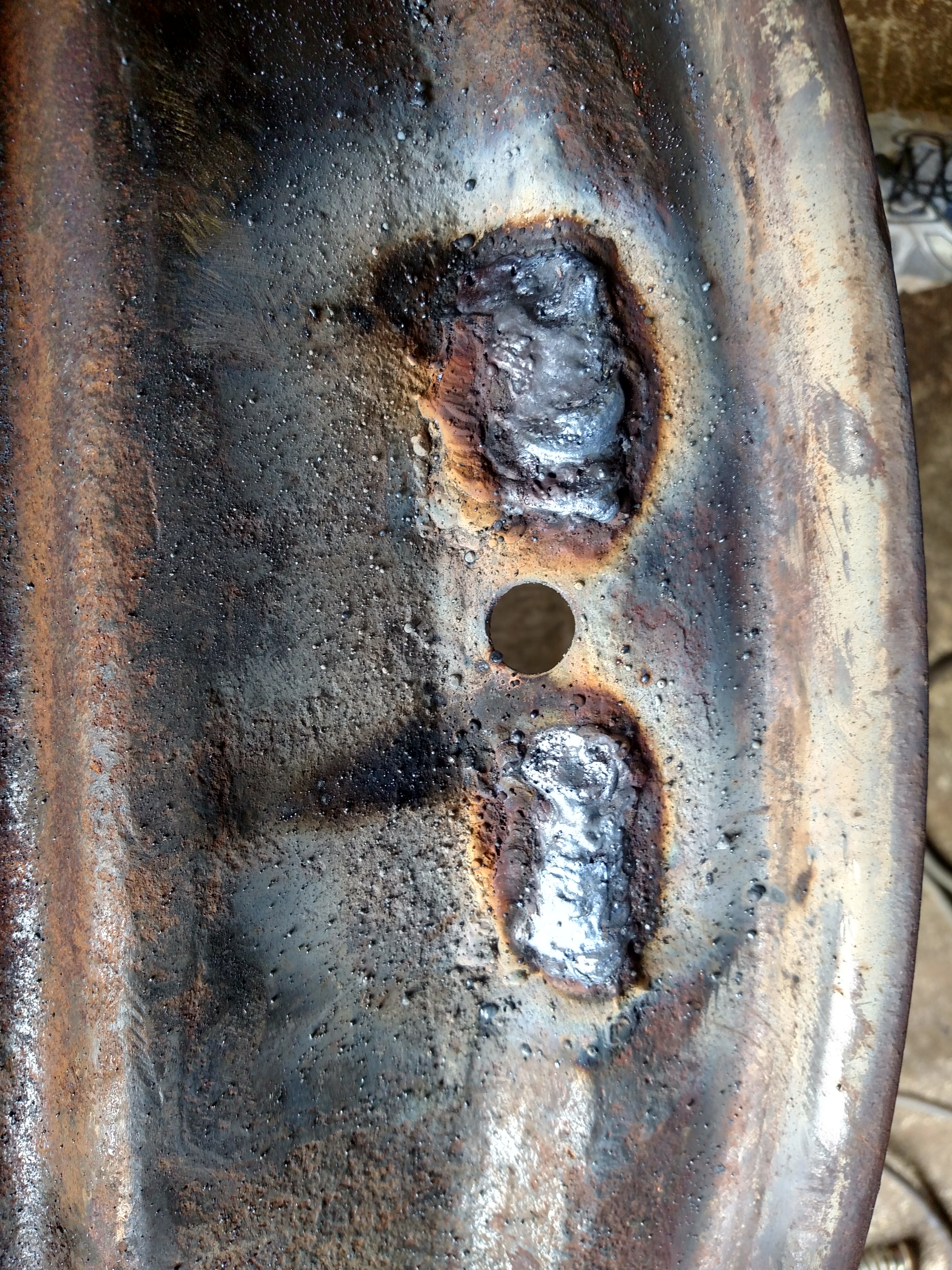

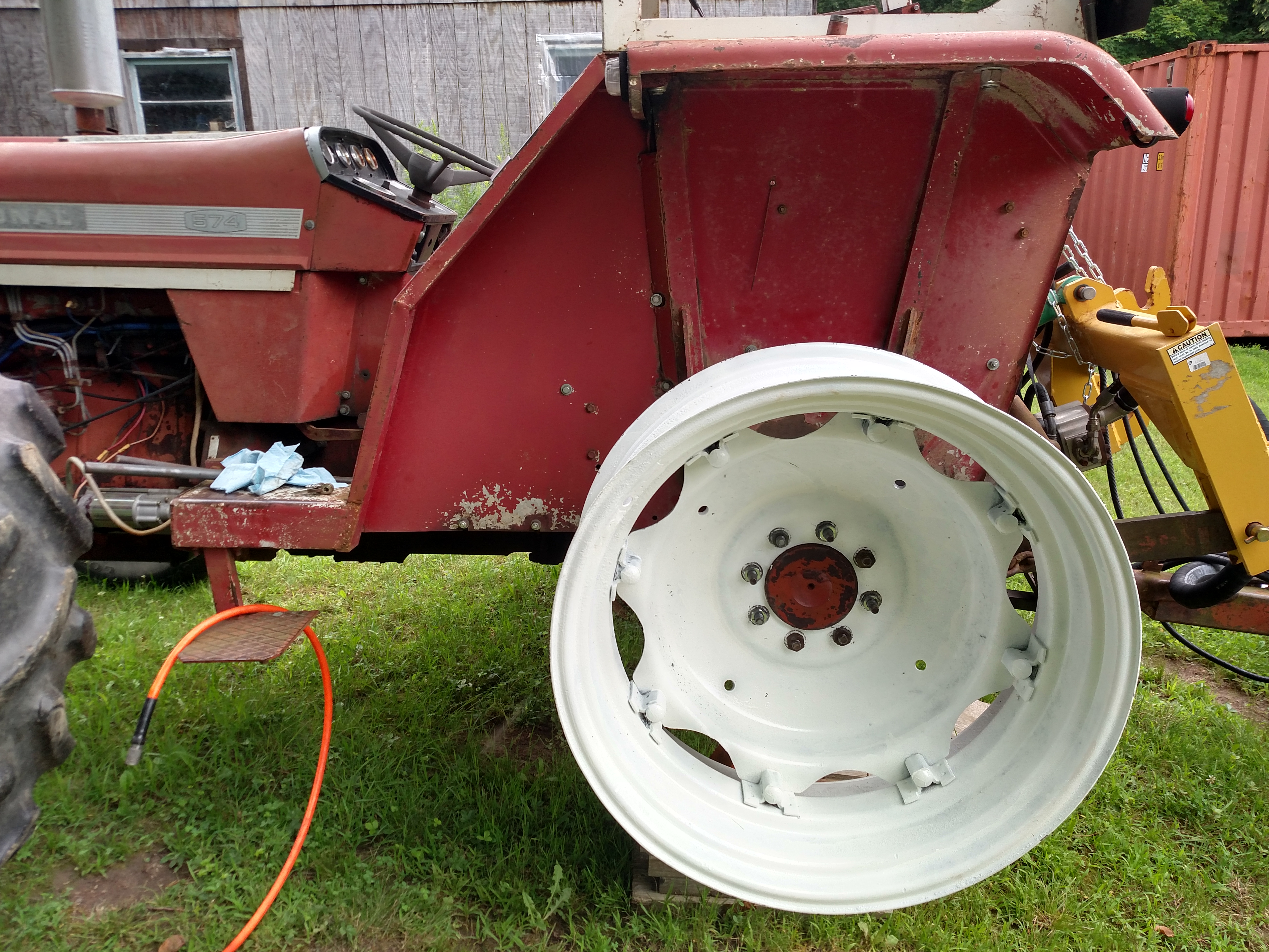

My last one took about 3 hours to get the tire broken down and the tube out and tire dismounted, then a day of wire brushing and welding up the rust outs and putting bushings in to make a nice round hole for the valve stem, and lots of grinding to get it smooth. A day for the paint to dry and then most of the next day putting it all back together again.
This tire was in pretty poor shape so I also installed 3 boots to repair the tire and a new $50 tube.

I just went through a similar situation on my 2N. you’ll need to break down the wheels to see how bad the corrosion is on the rim. most likely the bead of the tires will be “rust welded” to the rim and you’ll have to destroy the tire getting it off. I hate to be the bearer of bad news but if the rust is really bad you’ll need a new rim. It doesn’t make sense to put a new tube on a very rusty rim because the rust will eventually cut through the tube unless of course you spend a great deal of time grinding everything down and refurbishing such as the previous poster did.

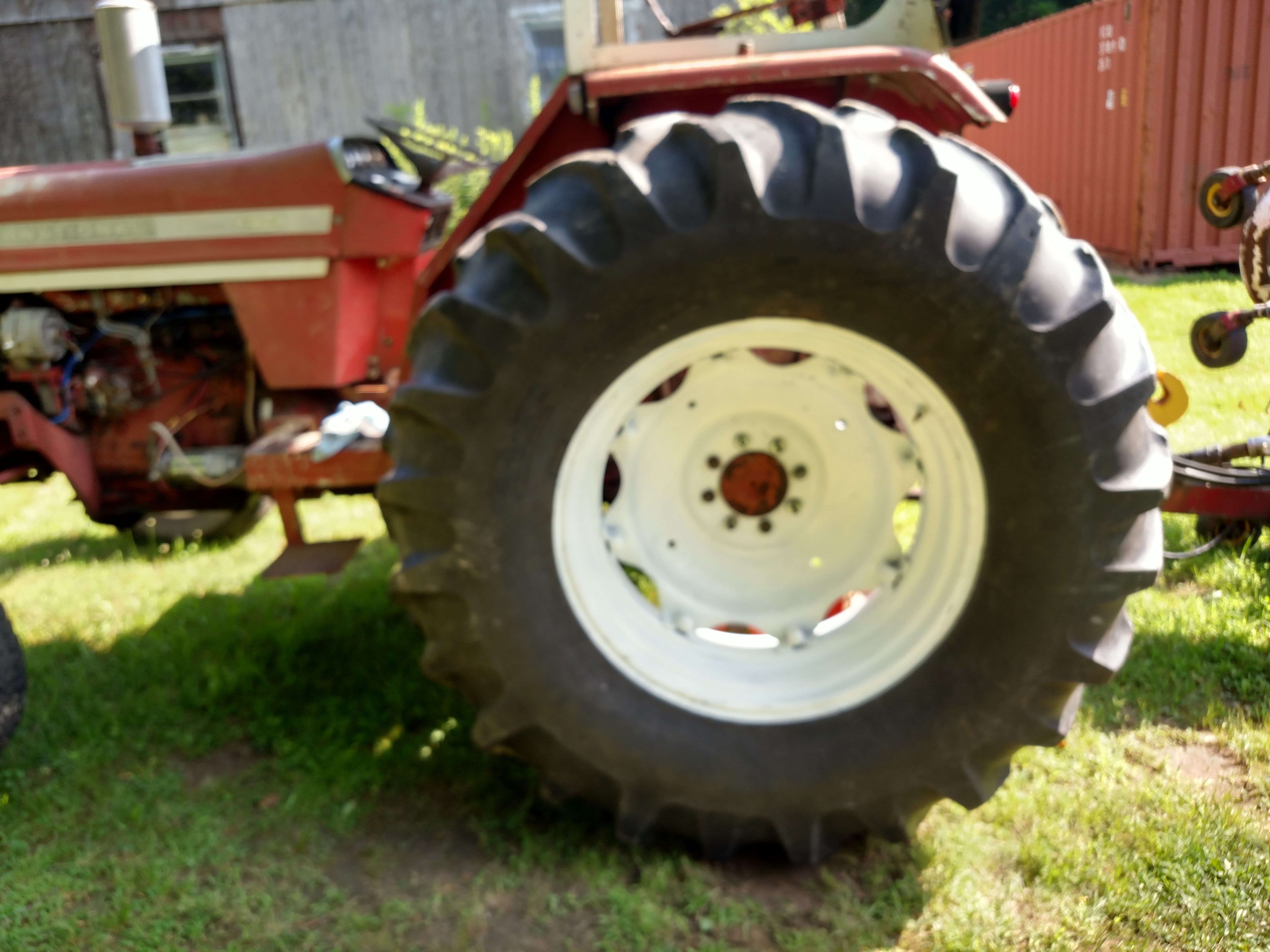

展hat size tire is it
12.4-28 on 11
的f you can get the tire to them?
Yes I have a æ–—oading dock where I can back my truck up to a hill and get the wheels in the back. The one tire/auto guy does a lot of tractor tires he replaced and filled the front for me a few years back they where 600$+!
é„*re the tires stress cracked or coming to pieces?
No just dry rotted. I need to check when u get home but I think they said tubeless (could still be tubbed anyway idk)
的f you are wiggling the large knurled nut next to the rim and you are leaking from below that your actual valve stem is leaking
Perfect description. It leaks below that nut.
The ourside of the rims he rims don稚 look bad except right around that valve stem I知 guessing the fluid fill is corrosive Becuase it has rusted that area (the part I showed in the picture).
