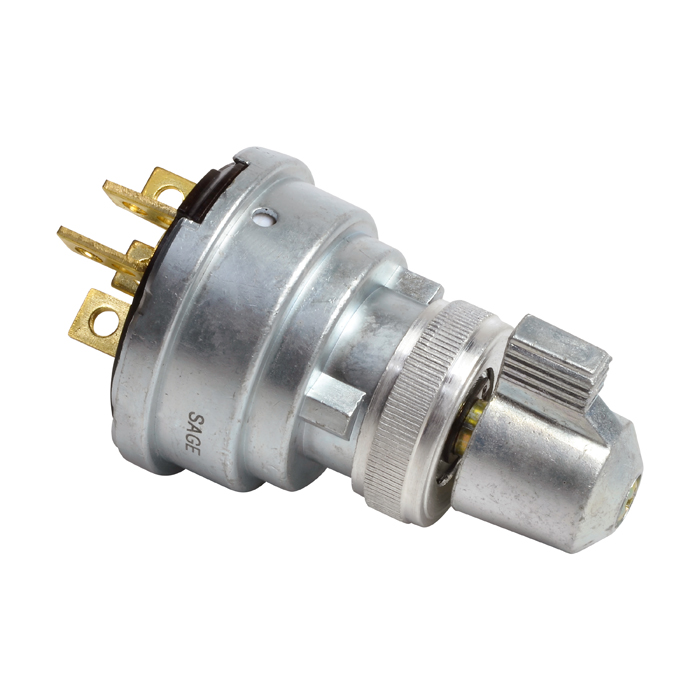

I don't see a private messaging area here, so at the risk of arousing the vigilanties I'll be direct. I want to install an on off switch to replace the ignition switch. I need some help with the circuitry. I'm assuming there are other functions that use the ignition switch. There must be some of you who have ignition switches so sloppy the key falls out after about 10 minutes of operation. Or a body too big for this nano tractor. I've broken three keys with my right knee.
So I guess I'd need a toggle switch or what ever with multiple contacts. I live in a remote area and am not even a little concerned about theft. Can anyone offer some advice, about how to do this please, not about why I shouldn't. Thanks for your time and help over the years. I'm beginning to figure this thing out. But I couldn't dig a sloping ditch if my life depended on it. I just ordered my last two keys no matter what.
Ron
I just remembered the wiring diagram, that should help with the other functions but I still need the correct kind of switch configuration.

The stock switch has 5 wires: +12v input, accessory out, run out, glow out, and start out (spring-loaded back to run). Various combinations of outputs are powered in the five different switch positions: off, ACC, run glow, and start. Toggle switches would be very awkward to use and would involve new holes in the dash. The linked aftermarket keyless switch lacks a glow position (and contact).
Given the OP's goal, why not just epoxy a key into the switch and grind off excess hey head (to avoid breaking the key). Just make sure the key turns free before the epoxy sets up. Worst case, he has to buy a new switch (which includes key) in the future,

with above said. i can not think of an actual dip switch, with multi functions that an ignition switch would have. just to many wires, and special purposes. you need an ignition switch.
if you are not afraid of drilling another hole, and cutting and splicing wire. and you have room some place else on tractor for the ignition switch. get some wire, some splicers, and a drill and get to work moving the ignition switch some place else.
