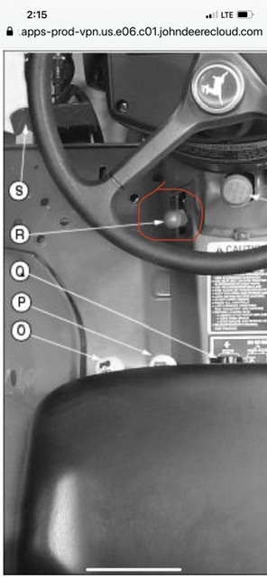

Do you by chance have this lever circled in red? That engages and disengages the 4wd.
   / Tired of spending money! #6
That lever only cuts off power to the front drivetrain. The gears, etc, always turn when the front wheels turn…the OP needed to do something that mimics unlocking front hubs on a 4WD road vehicle.
