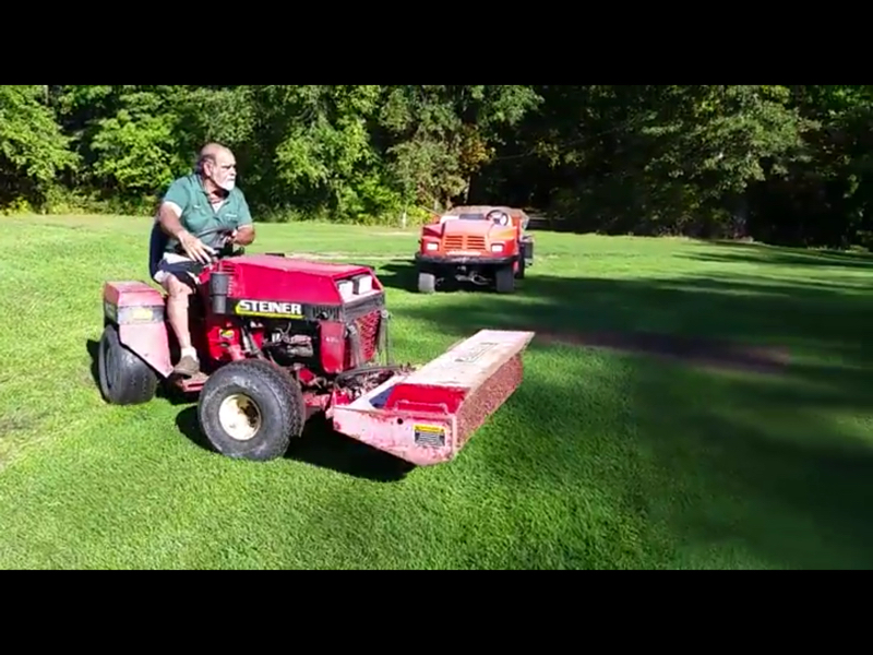

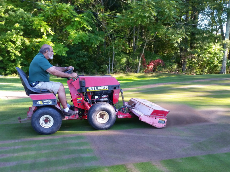

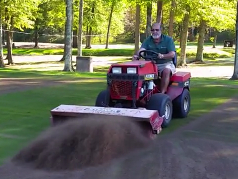

We use sawtooth gold cart style tires on one of our Steiners, I love them,and it goes about 98 percent of the places the sawtooth will go,and about 90 perfect of the places Carlisle turf traxx will. golf cart tires are too small,I've tried the 18x8x9 and you don't get enough ground clearance or ground speed we did use the years ago for greens only,once I found the 22x11x8 size I found the perfect compromise. believe it or not the sawtooth tires gold side hills remarkably well,as
Nd climb anything you need to,the issue is once you do break traction regaining control is harder on wet grass...You can use cart rims,Club cars fit right in,they are an inch narrower and do not have as heavy duty a bead lock but they work fine and have held up to 15 years of abuse no problem. Here are a few pics of my 1997 420 steiner on a putting green with the 22x11x8s.they are on it year round .

We use sawtooth gold cart style tires on one of our Steiners, I love them,and it goes about 98 percent of the places the sawtooth will go,and about 90 perfect of the places Carlisle turf traxx will. golf cart tires are too small,I've tried the 18x8x9 and you don't get enough ground clearance or ground speed we did use the years ago for greens only,once I found the 22x11x8 size I found the perfect compromise. believe it or not the sawtooth tires gold side hills remarkably well,as Nd climb anything you need to,the issue is once you do break traction regaining control is harder on wet grass...You can use cart rims,Club cars fit right in,they are an inch narrower and do not have as heavy duty a bead lock but they work fine and have held up to 15 years of abuse no problem. Here are a few pics of my 1997 420 steiner on a putting green with the 22x11x8s.they are on it year round .
I apologize for the spelling errors,my iPad changes all my words...btw that's my 70 year old father working the Steiner,that man outworks men 1/3 his age...he has been an incredible example of what a hard working man is to me and my his grandchildren.

What is that black thing on the right hand side of the Steiner?
Are Steiner tires not ultra low pressure tires? My JD E-Gator requires 10 pounds, but isn't the Steiner like a third of that? I would guess that not all tires are designed to flex in the sidewall like a very low pressure tire.
   / Tires - Steiner - Golf cart? #7
What is that black thing on the right hand side of the Steiner? Are Steiner tires not ultra low pressure tires? My JD E-Gator requires 10 pounds, but isn't the Steiner like a third of that? I would guess that not all tires are designed to flex in the sidewall like a very low pressure tire.
.The tires are fairly low pressure,we run about 8-10 psi in them,I believe they are Chang shin low cost tires,but they've held up great.It does ride slightly firmer with these tires but that's a worthwhile trade off to us.The stock goodyesr rawhide tires are 6psi inner,3 psi outer .We don't use them ,we replaced them with Carlisle Field trax 22-11-8, much better tires for traction in grass and holding a side hill. The thing on the right? It's cup holder,made out of a spare sprinkler housing That's all I can think you mean....
