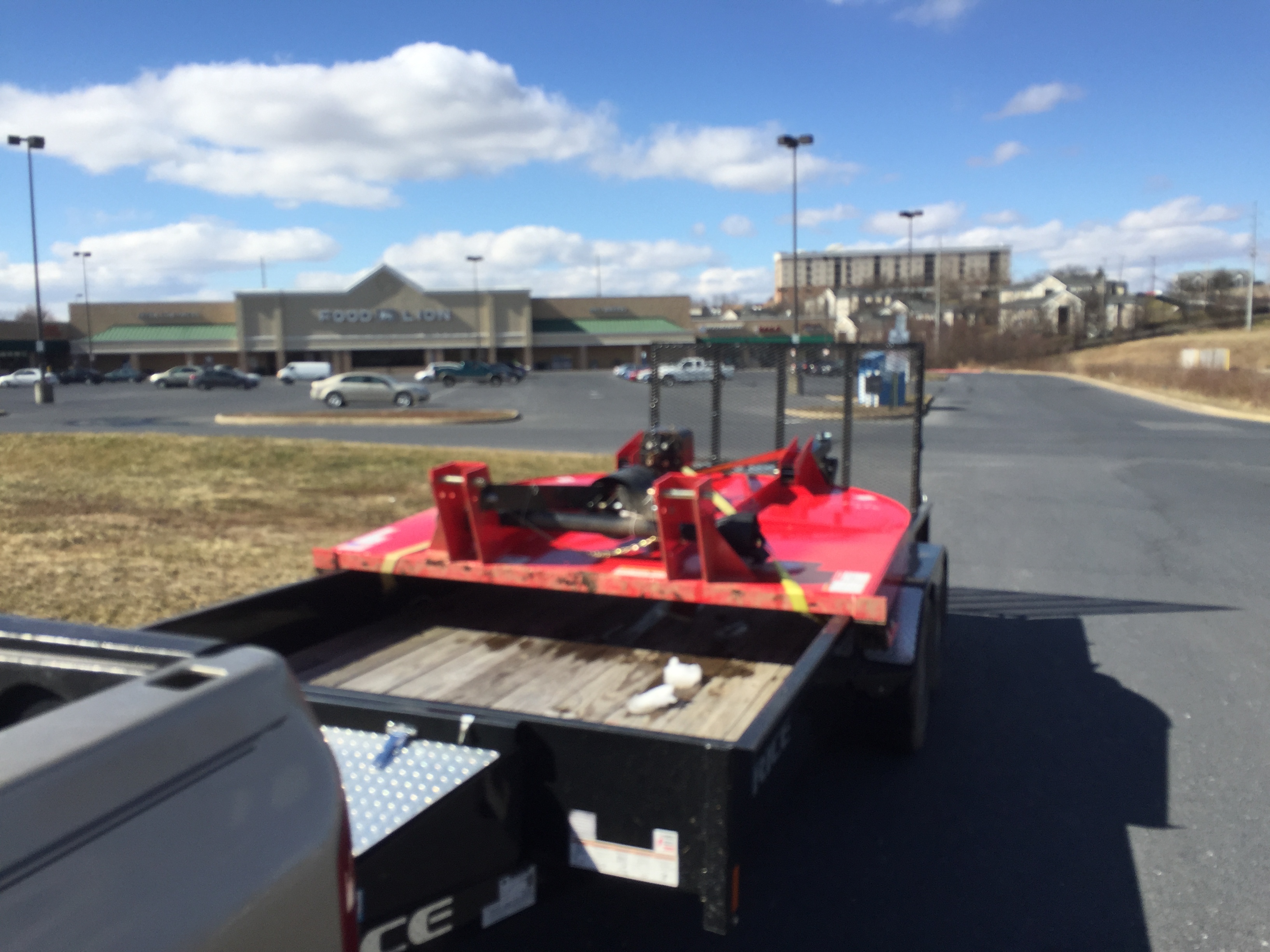

I bought a Titan 1507 today. I was running out of daylight when I brought it home so it will be tomorrow before I take it off the trailer and will probably be next week before I test it out. I will give a full review and shoot some video when I do.
Question for the masses. It is supposed to come with ep-0 grease already in the gear box. I will check it before running it. What is EP-0 grease? What are some good brands if it needs to be topped off?

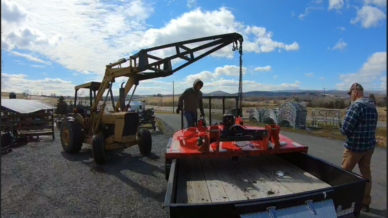

As for the cutter review, I tend to get frustrated with not having enough info when I am looking for something. So i bought a GoPro and i am going to try to take a lot of video. And put something decent together to help out the next person who is evaluating one. I have the Chains ordered. They will be on the next truck which shows up next month. I
